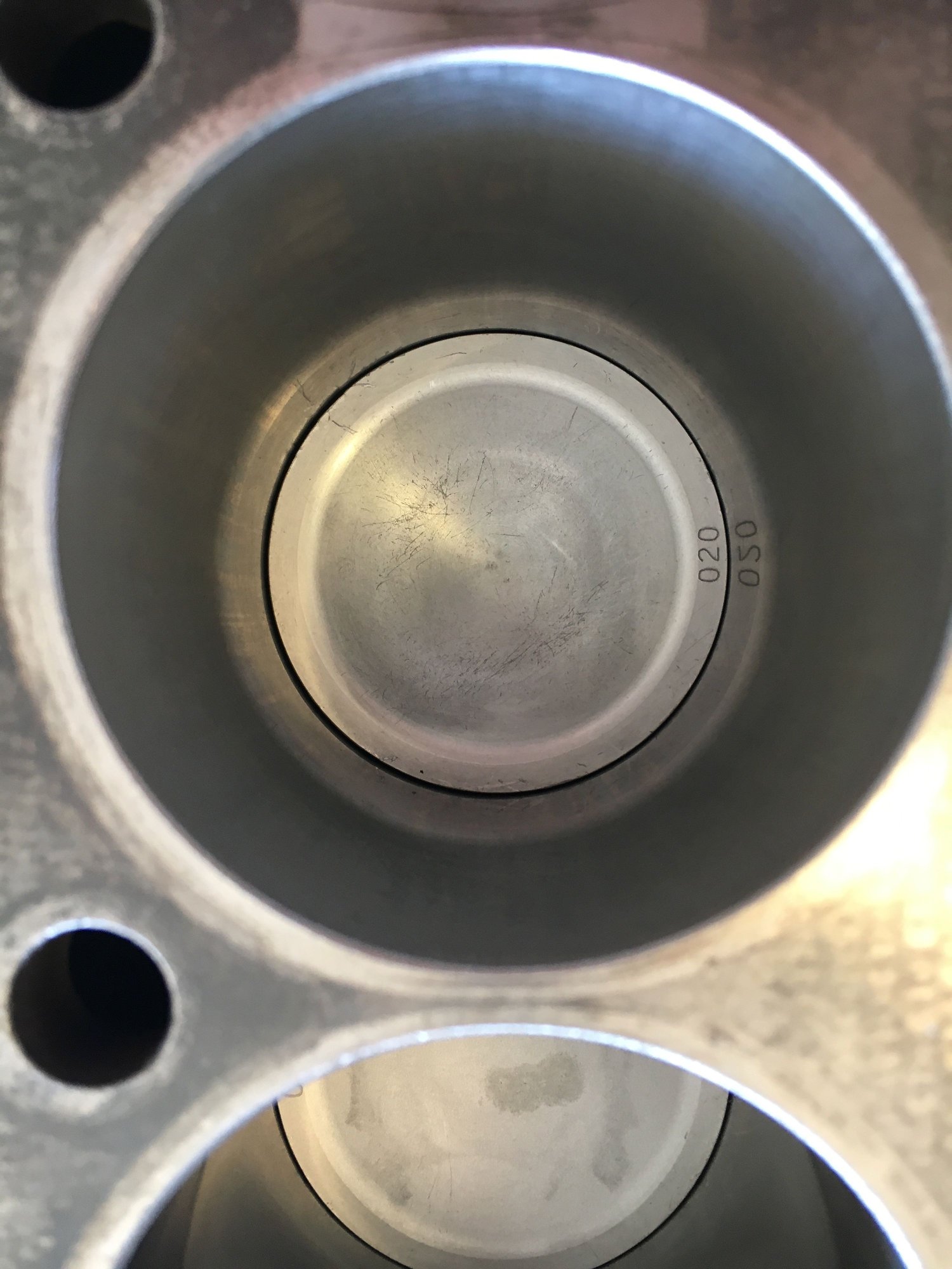

At 5000 miles, I wouldn't pull it apart unless there was an oil leak or consumption. But if you do, I'd just look at the cylinder bore and if they look (you still see some of the hone crosshatch) and if they look good, you might consider leaving them as is.
Yes, the top of the guide needs to be cut for stem seals. And if you are running a non stock cam with high lift you should check for clearance between the top of the stem seal and the spring retainer because the seal takes up some of the free space.

I agree--and wouldn't be touching it but for leaks from the rocker boxes, head gaskets, and (though it's a little hard to tell) possibly the cylinder base gaskets, too. I intend to default to riding this bike as often as possible, and don't like leaks at the top end (did another thread on sealing the tranny).
Indeed, it'd be wonderful if I could just scrape some carbon (it's jetted too rich), lap the valves, and put her back together. It's really hard to tell from the other stuff I've gone over, as the guy who built I seems to have known what he was doing, but (for instance) used parts from various bikes when he didn't have what was necessary on the bench. One of the rocker shafts is from a '66 Shovel and the other three are from a later model (with the larger thread plugs). I don't think the cam is non-standard, but can't ask the builder (who was a good friend of my neighbor) because he just died of cancer two months ago. So, I may do a compression and leak-down test before I remove the heads to see how the valves are sealing--and will have my fingers crossed that the cylinders aren't glassy. Here's a couple of photos of my A-Series when I was assembling it--though the focal length is wrong to see the crosshatching (and that isn't the head gasket I ended up using).
