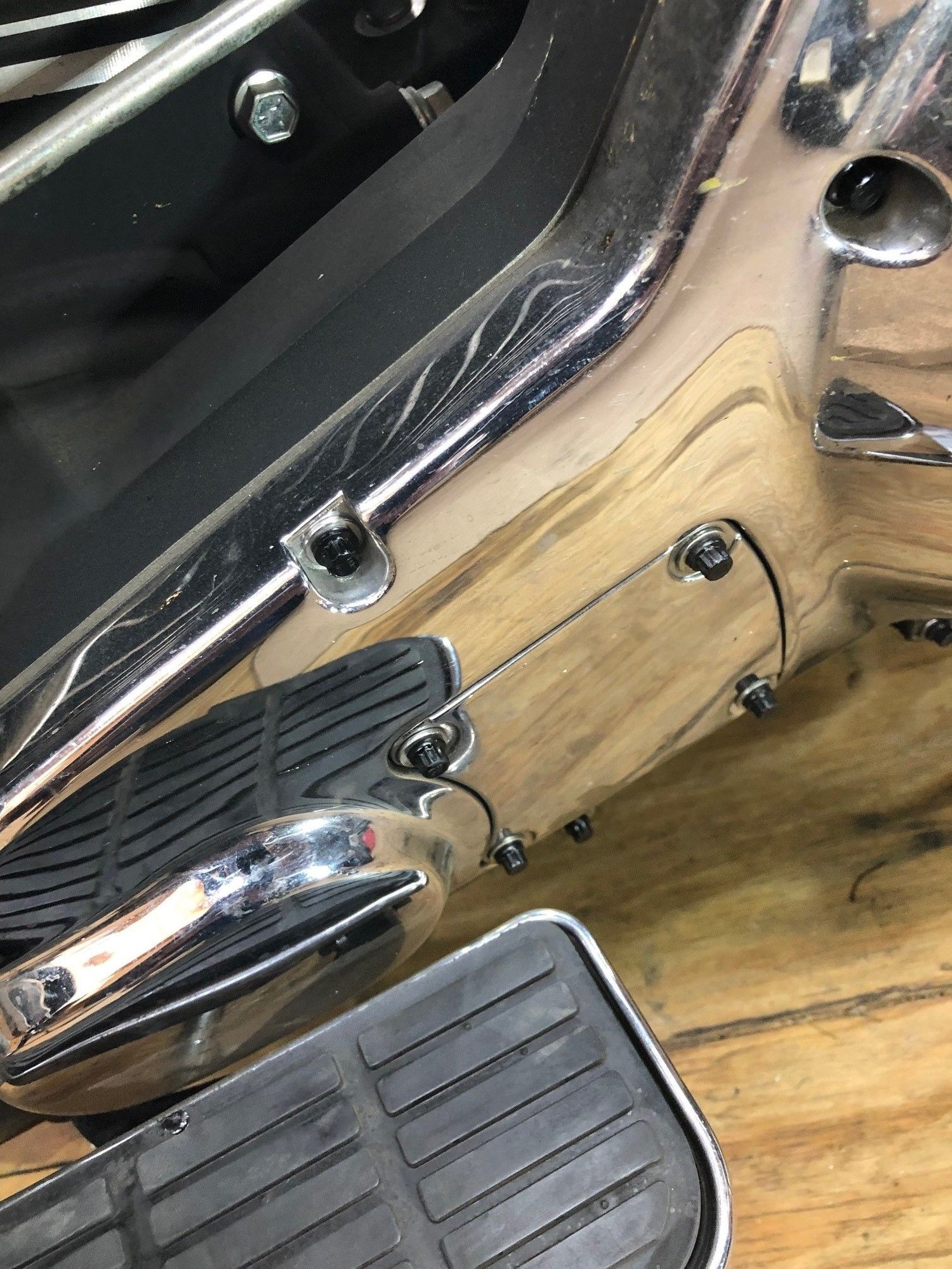

I replaced my derby cover Torx screws with 1/4-20 x 5/8" black oxide stainless steel socket head cap screws and matching M6 flat washers. Now they match the outer primary cover screws. Not sure if they're available in chrome. You could buy plain stainless screws and polish them.
