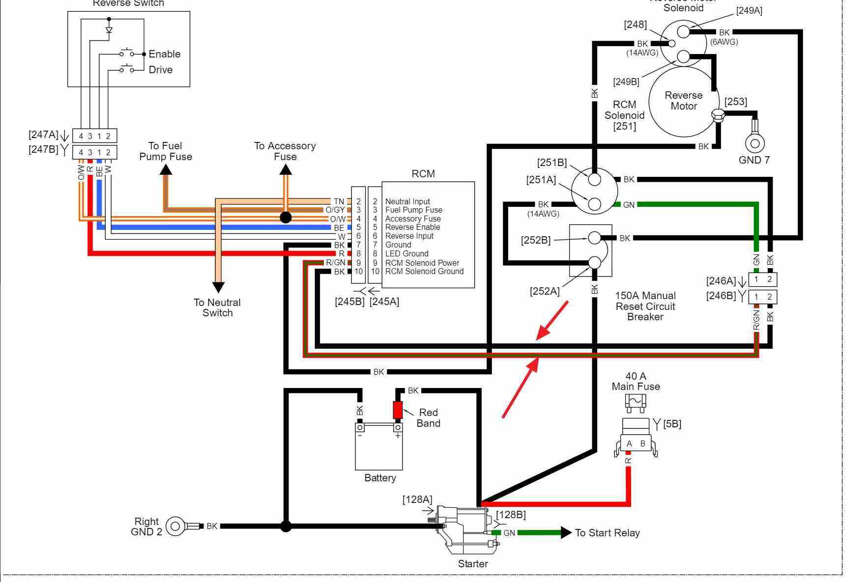

Here is the reverse section off of HD..
Check to see if you have voltage across the 2 wires.. You may want to raise the wheels off the ground when doing the test.. BTW, If neutral light acting funny, you'll need to fix it.
