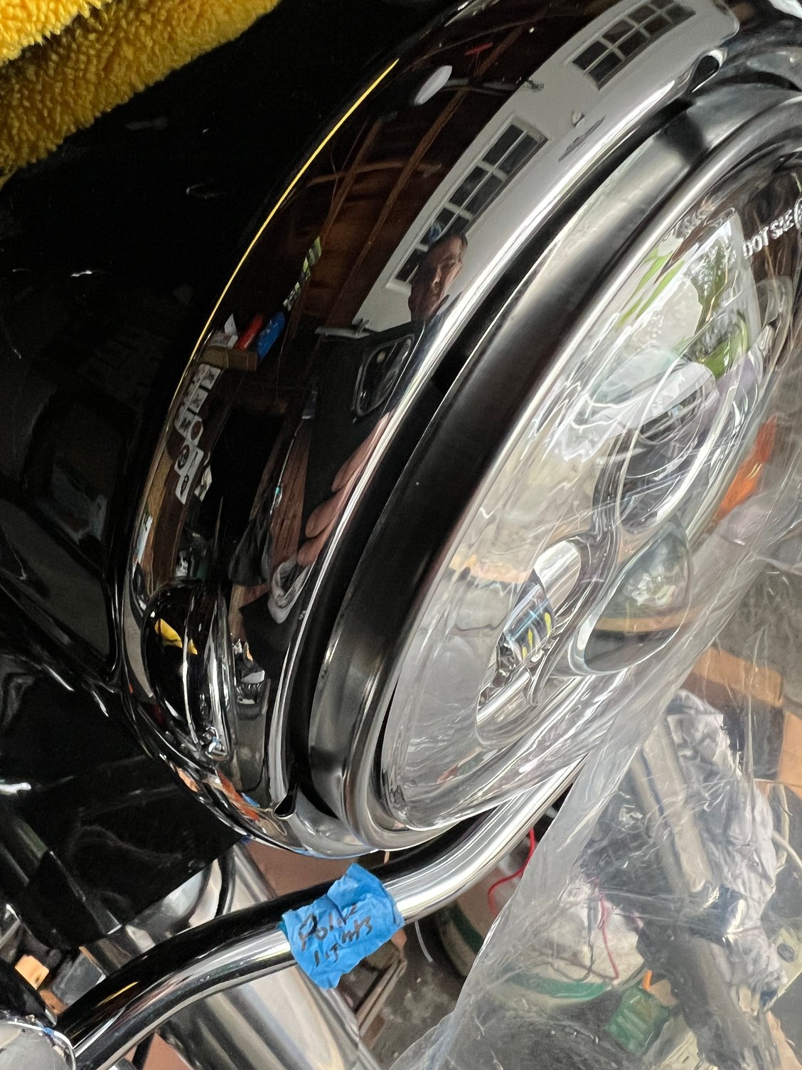

This is a pic of the setup of the light bucket on my '09.
If I were to loosen the two bolts for the windshield mount and the acorn nut beside the tach on one side fo the bike, would that allow me to open up the nacelle a bit? If this would work, it might allow me to get the mounting plate in where it should be.
I'm guessing I would also have to loosen the top chrome spear as well.

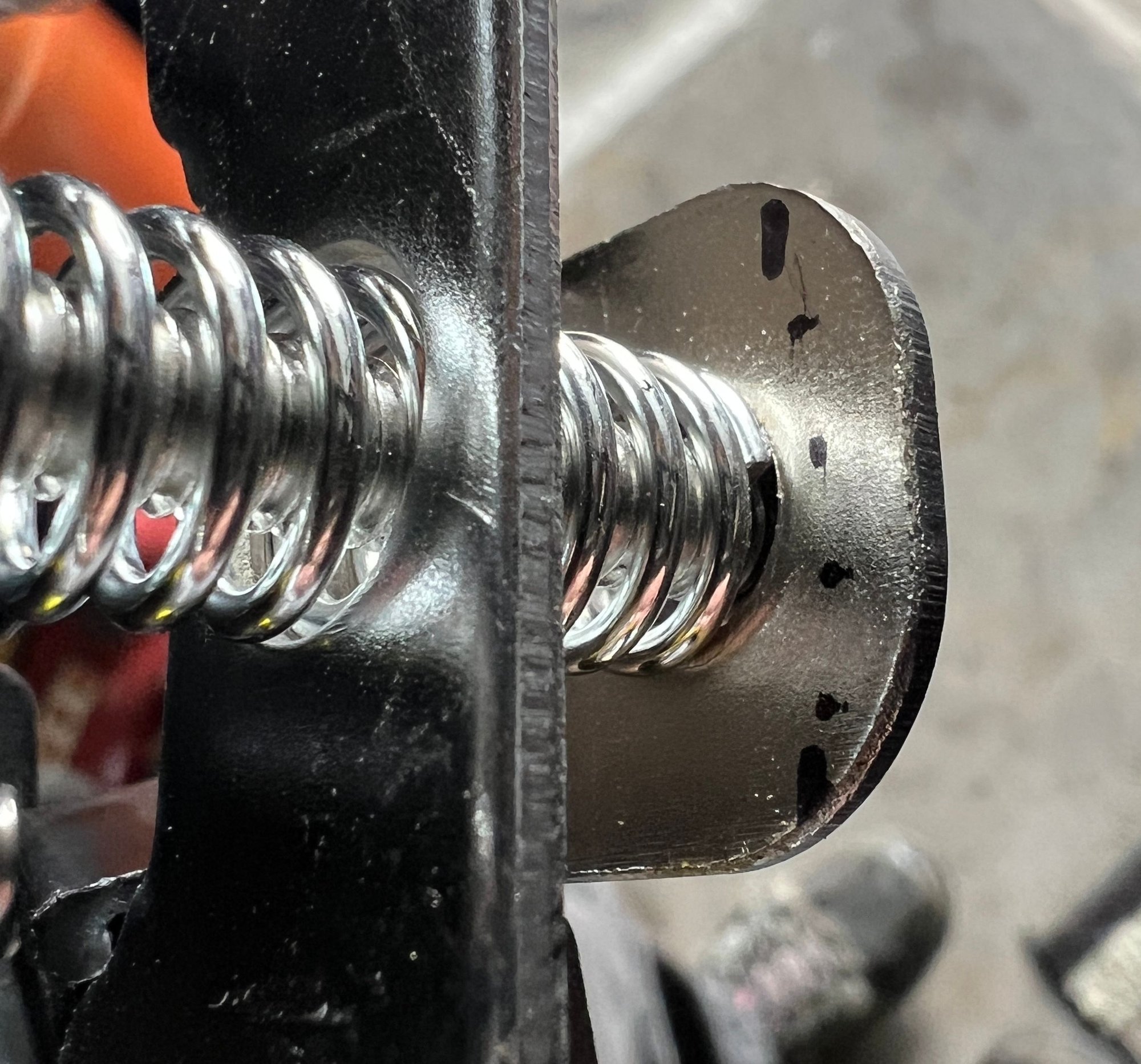

I only have the relief area at the 12 o'clock position but I need the same thing at the 3 and 9 o'clock positions or I will have to grind off part of the flange at the bottom of the spring on one side. The dots in the pic show where I would need to grind it in order to fit it inside the headlight.

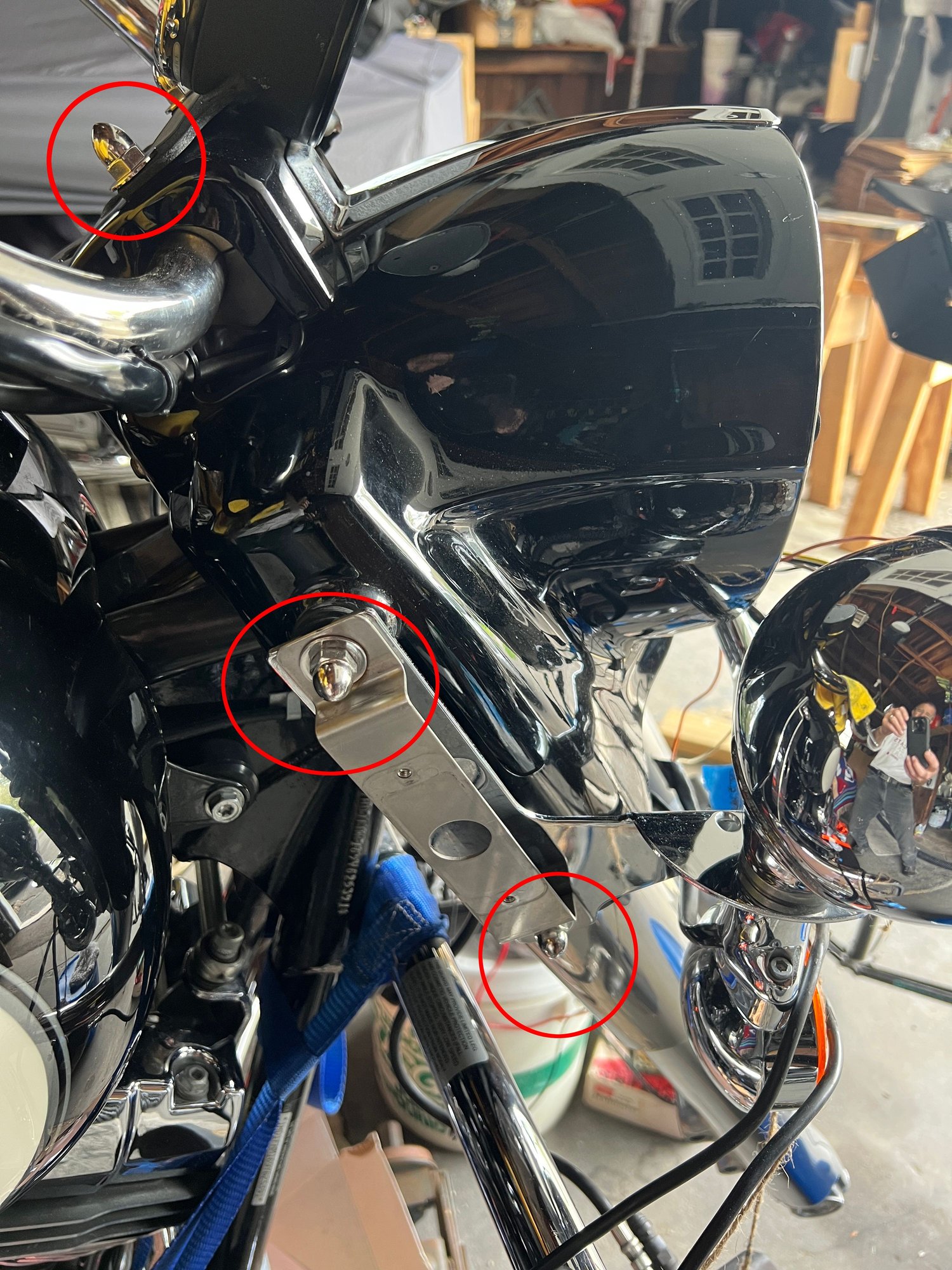

Do you know if the nacelle can be loosened on one side and opening up a bit to get a little more clearance to get the light in? I know it's not ideal, especially for later work in the headlight bucket, but I'd like to make this light fit if possible. If I loosened the three bolts shown, would that allow the side to be pulled open a bit or would I need to unbolt the entire thing?

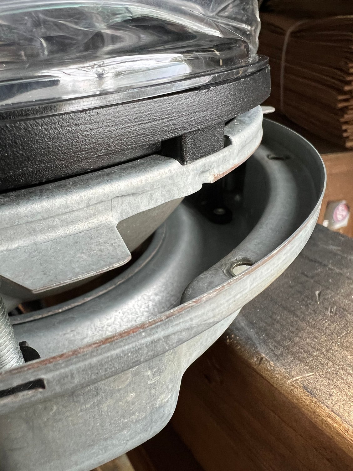

I made a last attempt to make the Sunpie headlight work - I took the LED out of the bracket that it shipped with and put it in the OEM bracket. It came real close but the three tabs would not quite align with the grooves for the tabs so the LED would not sit low enough in the bracket. It stuck out too far and was crooked. I attached pics for reference. I don't know if they make a unit that will fit the FLHP, but I'll ask again.
