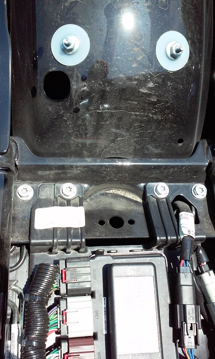

According to the instructions for the kit, the factory flange nuts that retain the stud plate are removed and reused to fasten the bracket. Here's a pic of the factory flange nuts securing the stud plate before the bracket is installed.

Excellent. Thanks. That's what I ended up doing.
