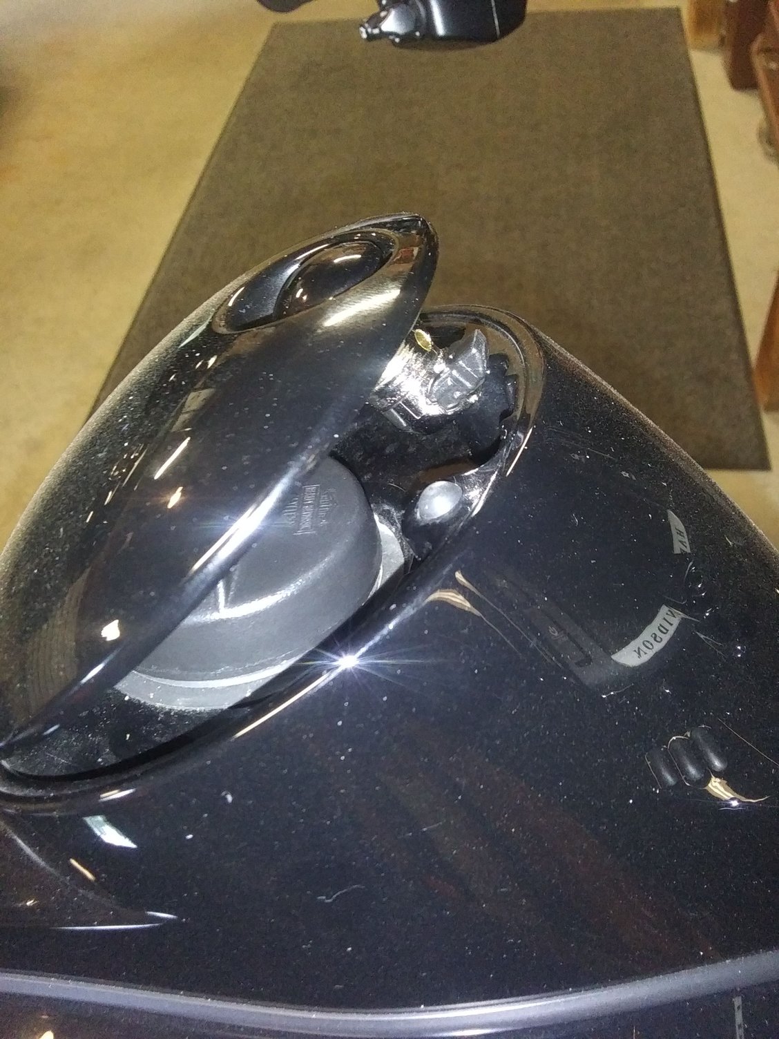

Simple fix on the road. Pull a quarter out of your pocket and pry up the wings a little. Works like a charm.
When my door started getting lazy, I used a right angle screwdriver to pry up both wings.
Now the door pops open this far whenever I press the button.

Yup, this worked great. I used a dime though.
