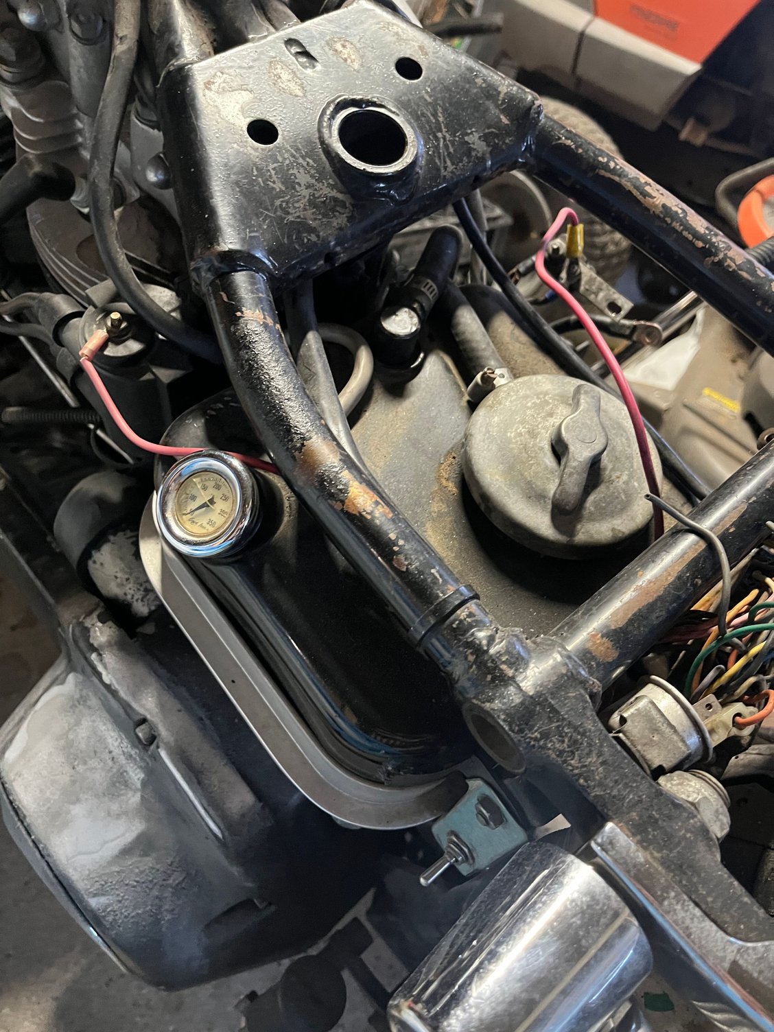

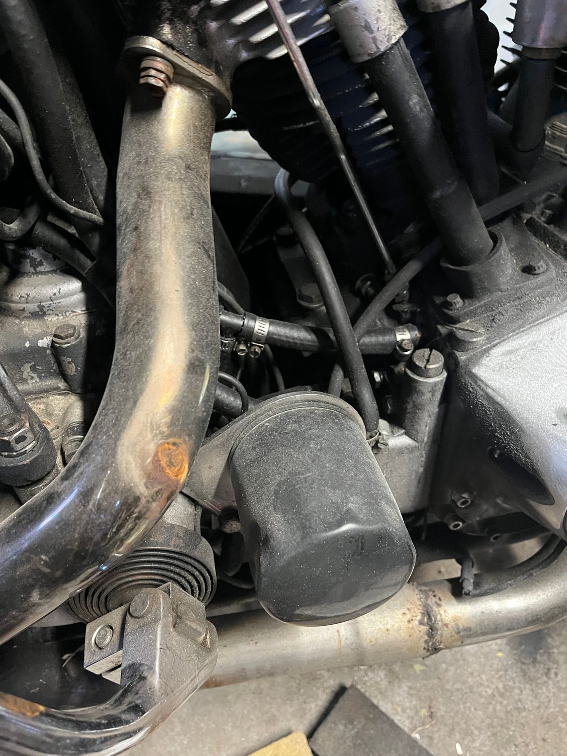

Here’s what we are working with

oil from scavenge goes to the line port below the cap. the other on to is the equalizing line that ties the tank back to the engine crankcase and the one on the bottom is your feed to the pump. you can get aftermarket drop in kits.
one note is sometimes that cartridge filter is hard to get so if you convert, buy plenty of them.
if there is room, you can use a front frame engine plate.
