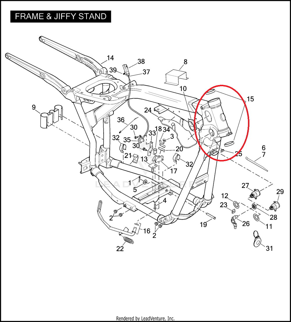

Old Feb 23, 2025 | 08:45 AM
bustert's Avatar
bustert
Posts: 5,048
Likes: 990
before you do any ripping apart, do a fall away test. the ole single ball necks if not maintained can have rust issues but the newer sealed bearings not so much.
some shake is normal due to like mentioned, tires and balance but do not rule out windage especially with wide front ends. often times a stabilizer is added.
on the old machines especially the sportster, there was a friction adjustment system, very helpful on a track.
there is an option to use tapered bearings where preload can be set.
