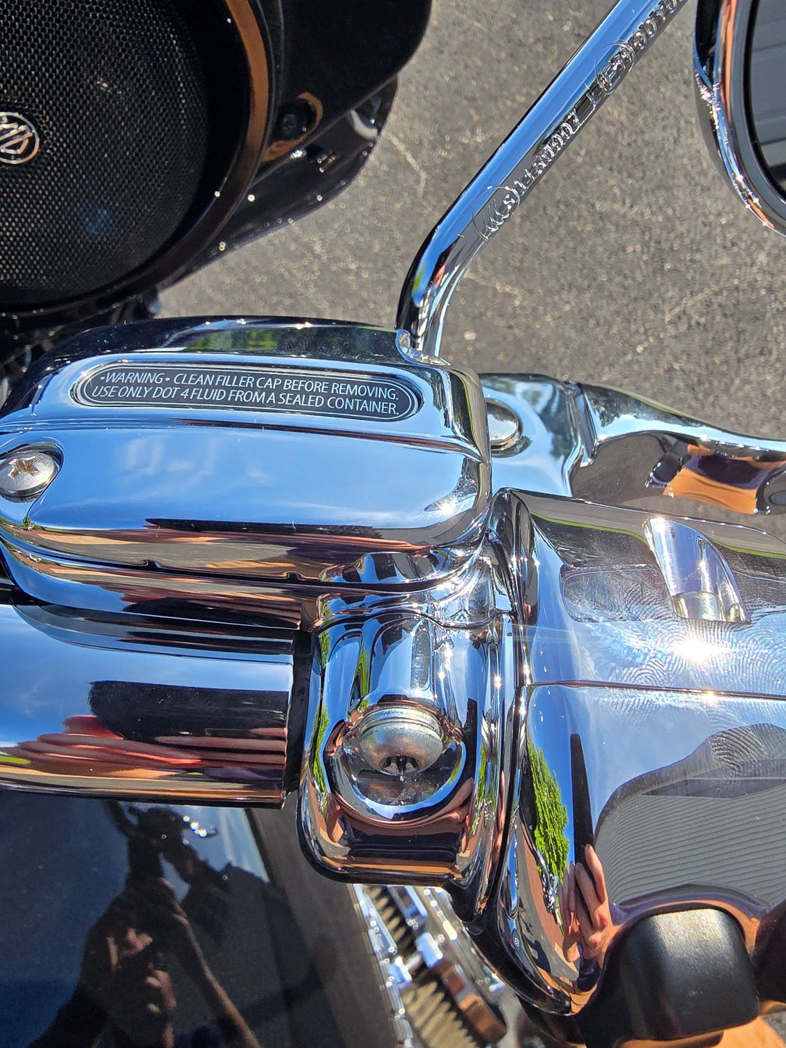

I didn't take pics of the weird holes, sharp edges, or metal shavings coming out as I figured I could fix that and live with the bars if I liked them and there were no other issues. But they didn't debur anything at all and the bars were very difficult to pull wires through. I do have pics of the gaps left by the mc and clutch clamps. Maybe people don't worry about that, but I haven't had that problem with any other bars I've tried, so I expected better. I really wanted them to tell me they could do better and was surprised at their response when I called.

KST gap at master cylinder clamp.

Understand the frustration with the gap. Seems to be an issue with many bars. My LA choppers had the same gap but my controls are black and just used a black zip tie to fill the gap. It’s unnoticeable now.
