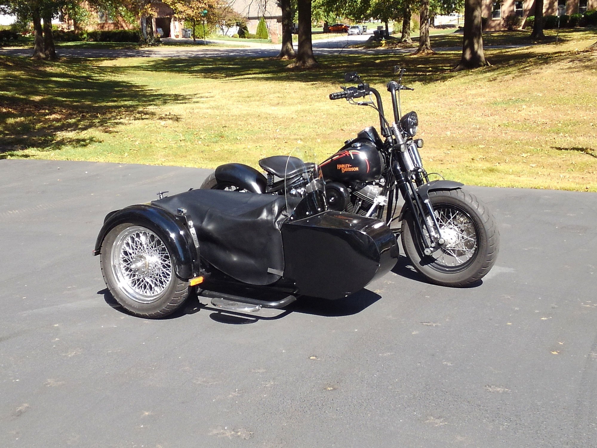

Have had this sidecar for about six months now. Wife loves it more than I. I us my Crossbones to push the car. Can remove in 10 minutes. Sidecar is from Trans-Moto.

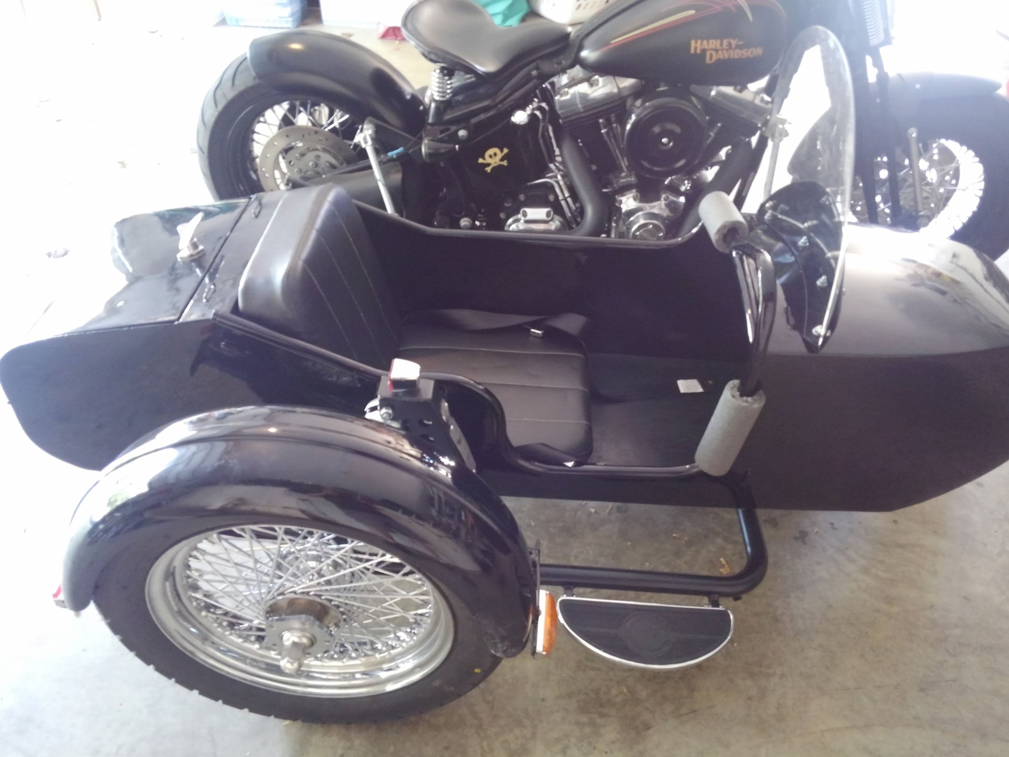

I’m installing a Trans Moto on my 76 Electra Glide now, in the process, as I need it to continue riding. I’m in Alberta and bought my sidehack in NS from a guy who had it on a 86 ultra glide, so I’m now getting the correct installation kit from Trans Moto to fit it on mine. This kit is costing me nearly $800.00 and I’m hoping the install goes well.

I’d like to see your mounting kit for this car as I’m installing a Trans- Moto on mine and just waiting for the correct mounting kit from the company. I’d like to see anything about your installation process. That’s a good looking setup you have there.
