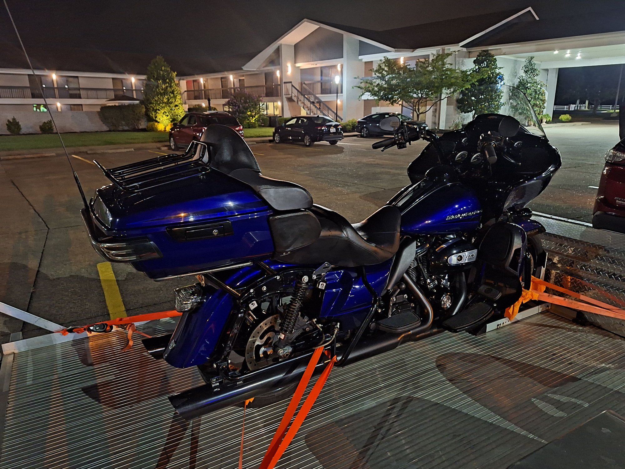

Mine will be done the week of Aug 12-15th. Looking forward to it.

Have you ever been to Hannigan in Murray KY? If you are riding there staying over night and leaving. Best Western in Murray offers a reduce rate for people going to Hannigan. Just call around midday and talk with the manager. Older place but good shape. Just stayed there again Monday.
