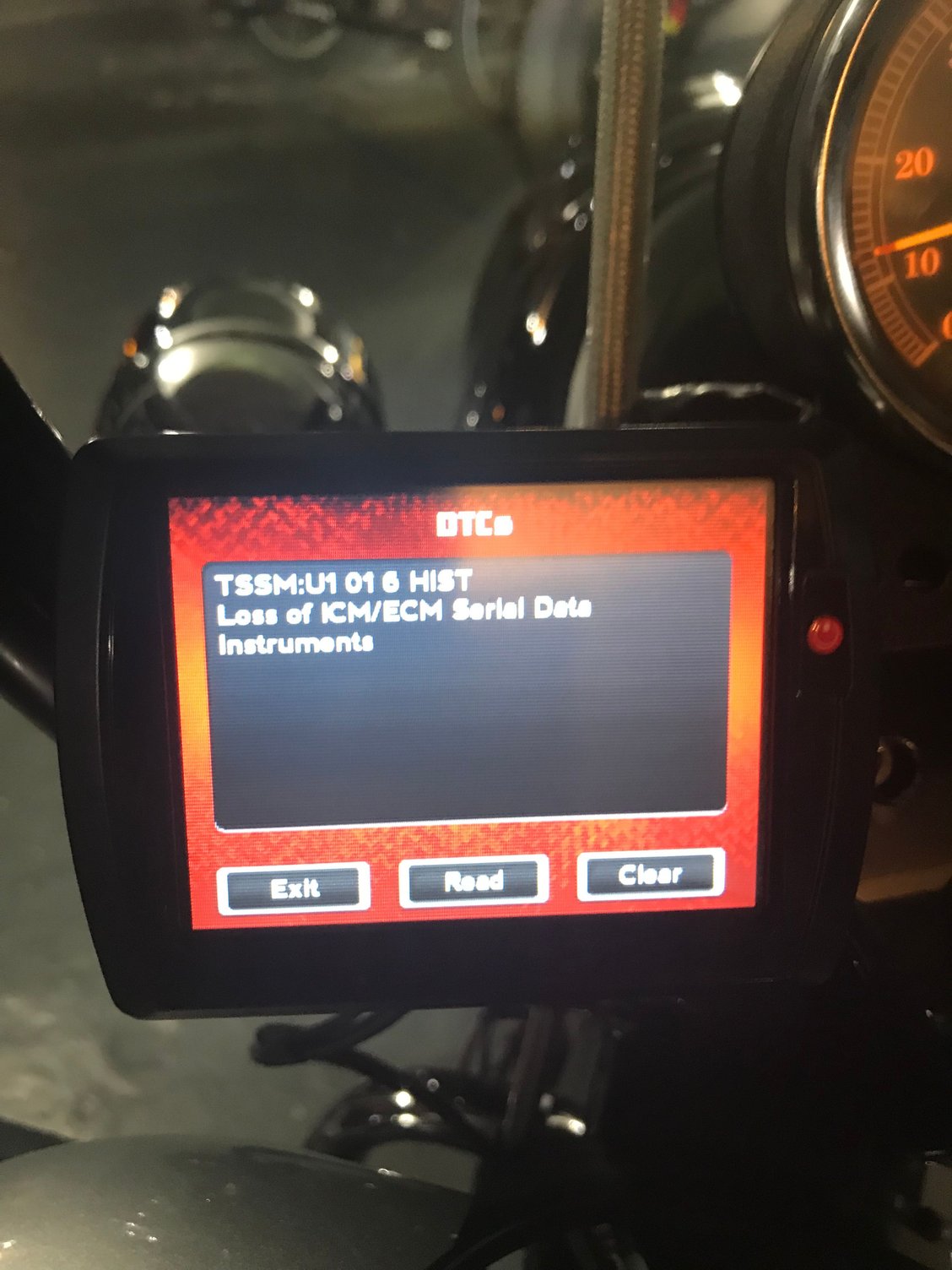

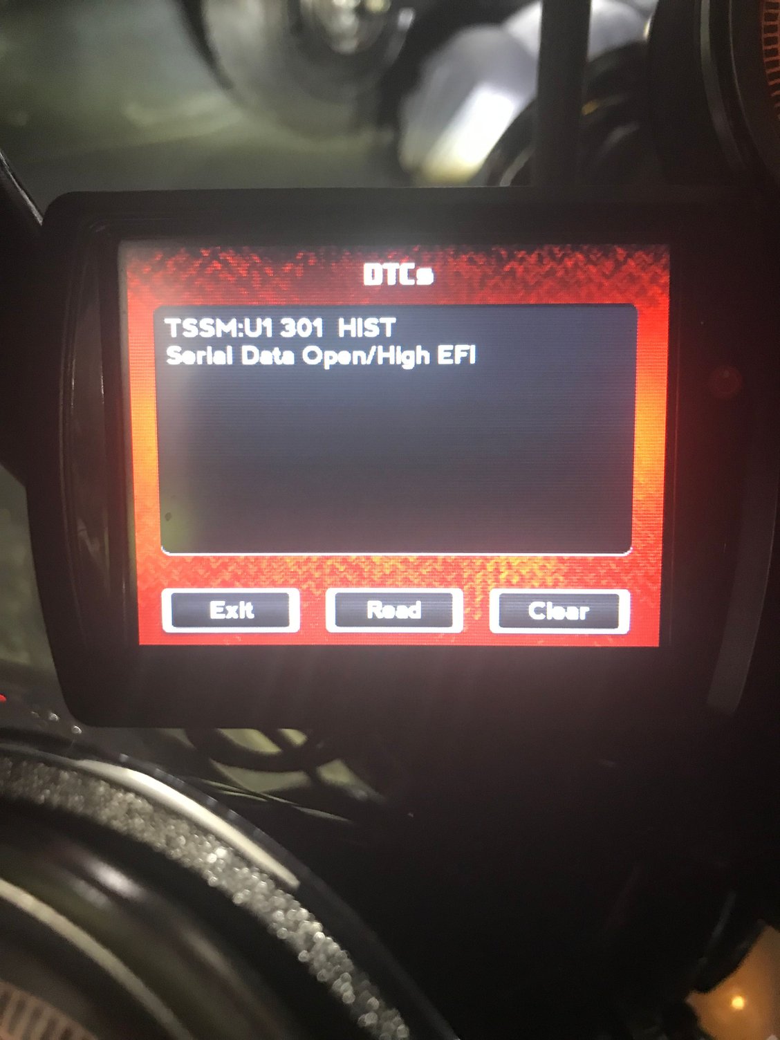

I’m having 3 codes pop u1016 / p0605 & U1301 rides great ( 03 road king ) then out of no where the motor powers down as thow it’s on 1 cylinder the check engine only stays on while this is happening if I stay on the throttle it will limp along then go back to normal if I let go of throttle it dies ! I’ve replaced CPK / TPS / MAP & IAC sensors I am running power vision with autotune and can’t figure this out ! I get the same 3 codes to show on power vision but not in diag mode ! I’m at my wits end twice now the issue has stopped happening I put some miles on the bike then it just hits without warning ! I was thinking possibly the magnum braided spark plug wires but that didn’t make sense I just don’t know!

It’s a new PowerVision I’ve cleared codes they do clear but even while event is taking place don’t come up I have to repeadily hit the read button

you have a serial data bus wiring problem going on, check your speed sensor and the wires going to and from the speedo. if the ecm can not communicate with the speedo, it cant get what it needs to maintain idle speed control, look at the wiring diagrams and the flow charts in the FSM electrical diagnostic book.

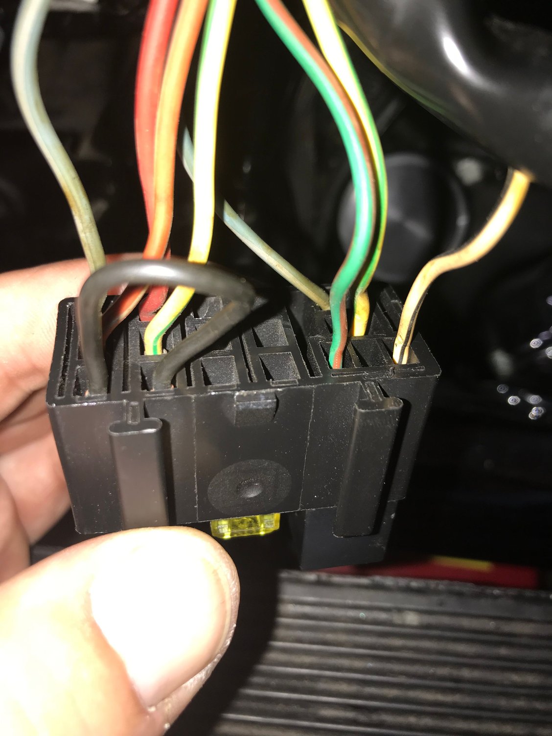

Ok so the parts I listed above have been purchased I have since gone over everything I can access yet again and really only see some discoloration on the wires feeding into the fuse box (picture attached)
something I noticed is the lettering ( ABC) on the ignition switch harness and the letters (ABI) on the switch itself now in my mind I would think that these letters should be aligned to match when the harness and switch leads are connected but that’s not the case the wiring harness for some reason only goes on one way ?
