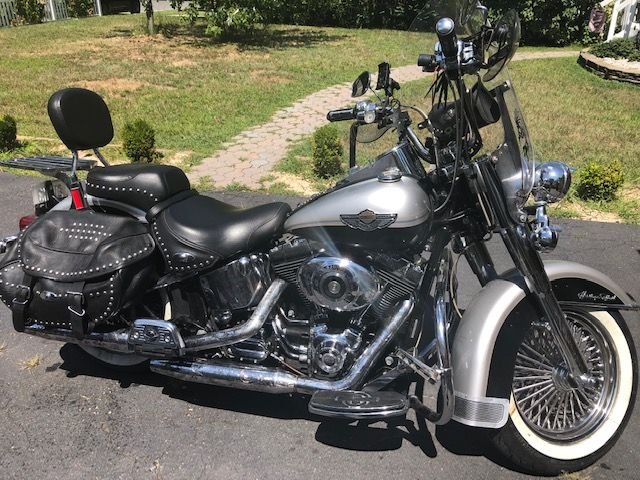

2003 Heritage Softail Classic EFI Twin Cam 88 55K miles
I recently diagnosed an electrical wiring issue to one of the injectors on my Heritage. The fraid wire caused the bike to run horribly and basically on one cyclinder. That problem identified, there is the question of whether or not I should replace the injectors which boils down to a $200 replacement cost.
