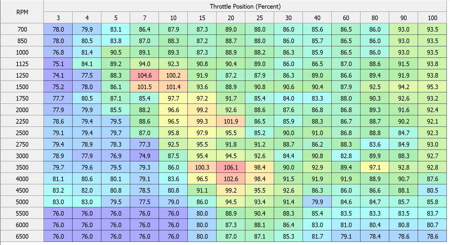

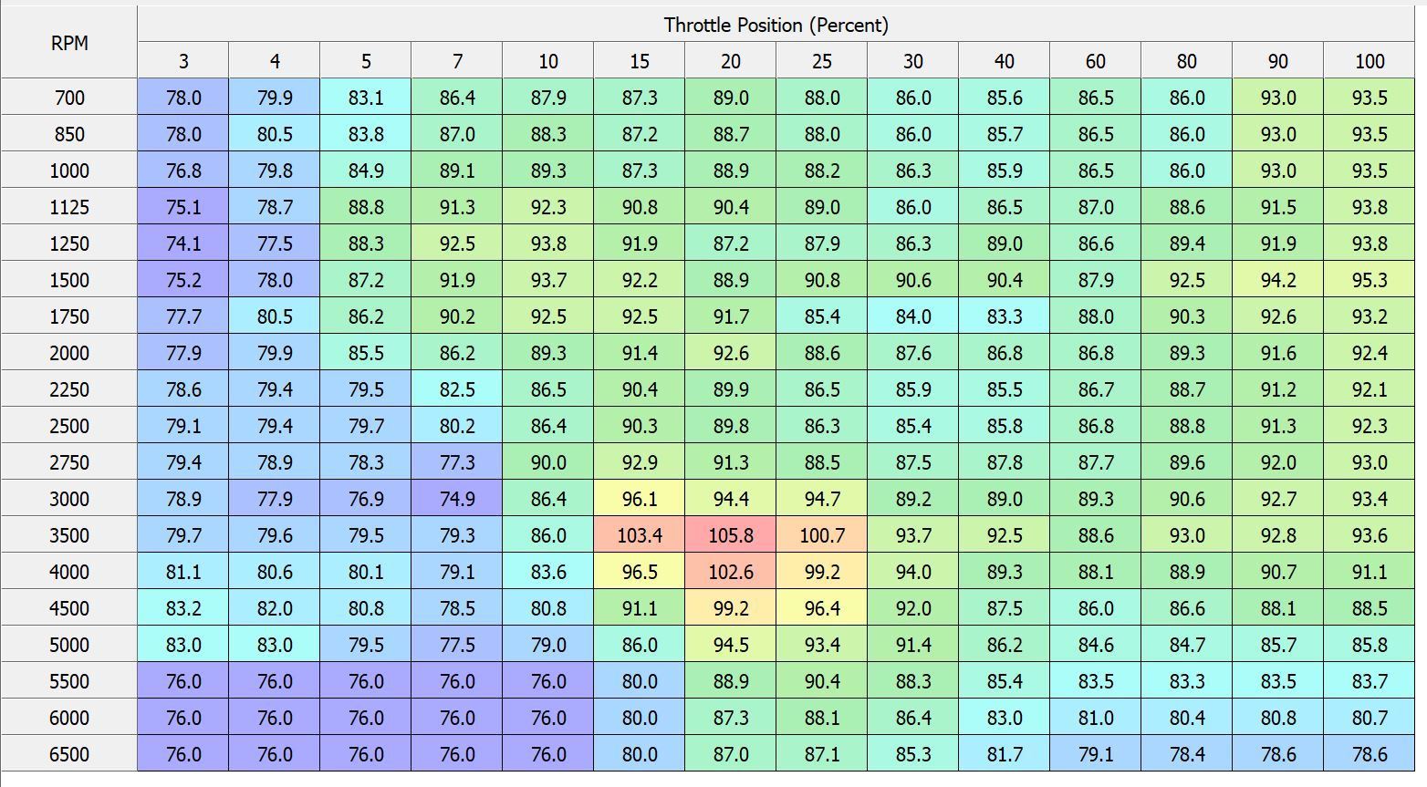

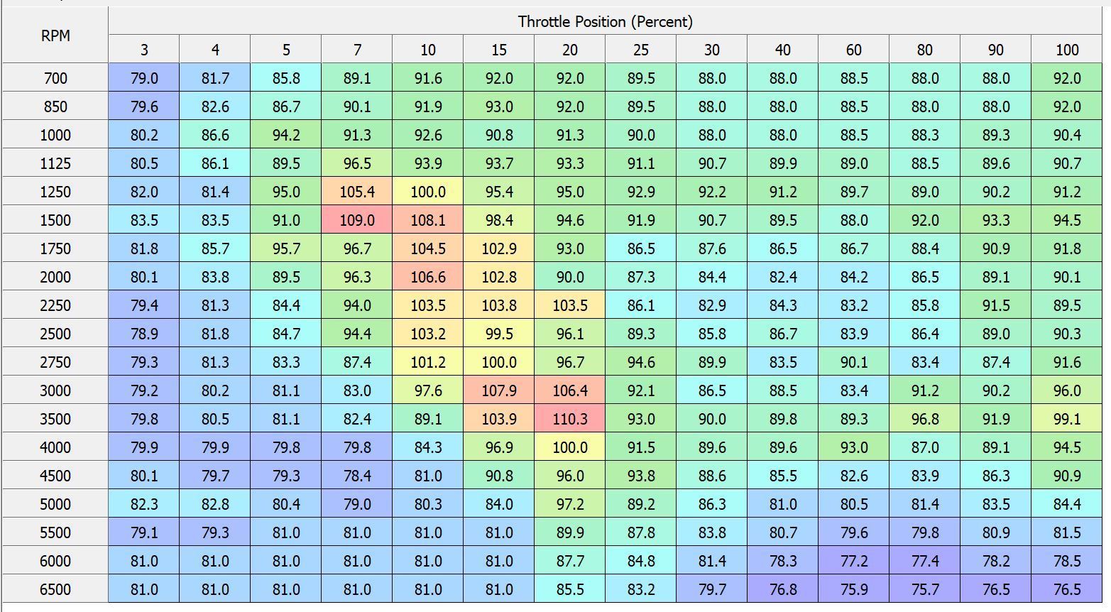

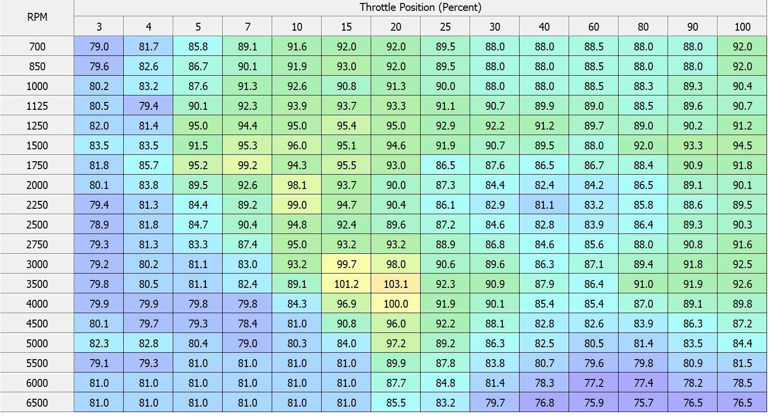

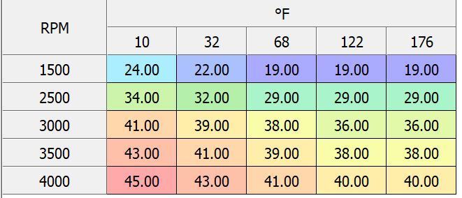

I ran couple Autotune sessions to my Fuel Moto provided tune. Can't tell the difference, but when I started to dig around a little bit (I have no idea what I am doing), I noticed couple changes. Here is what autotune changed. How does this look?
Fuel Moto TPS Based Front Cyl
Auto Tune TPS Based Front Cyl
Fuel Moto TPS Based Rear Cyl
Auto Tune TPS Based Rear Cyl

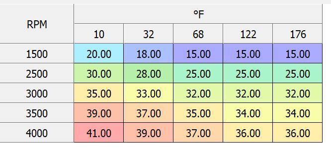

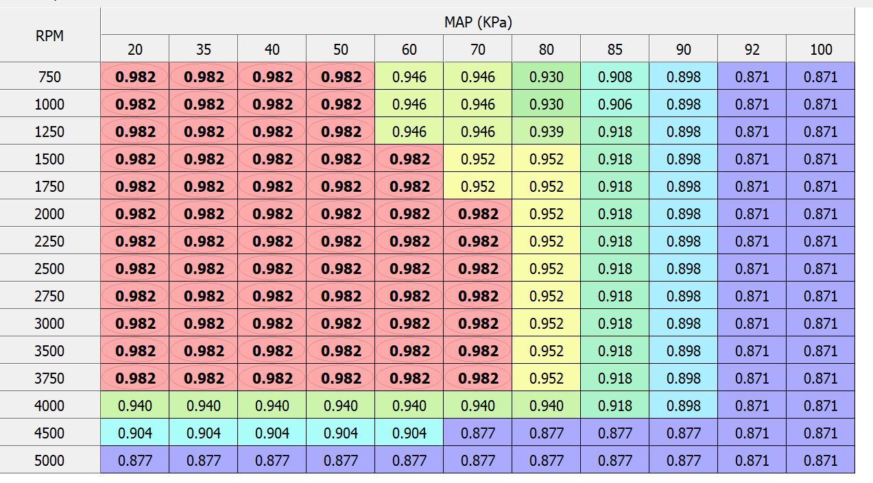

Other stuff below that I captured. There was no changes to this data from Fuel Moto to Auto Tune
Air Fuel Ratio Lambda - No Changes
Closed Throttle Spark Front Cyl m- No changes
Closed Throttle Spark Rear Cyl - No changes
