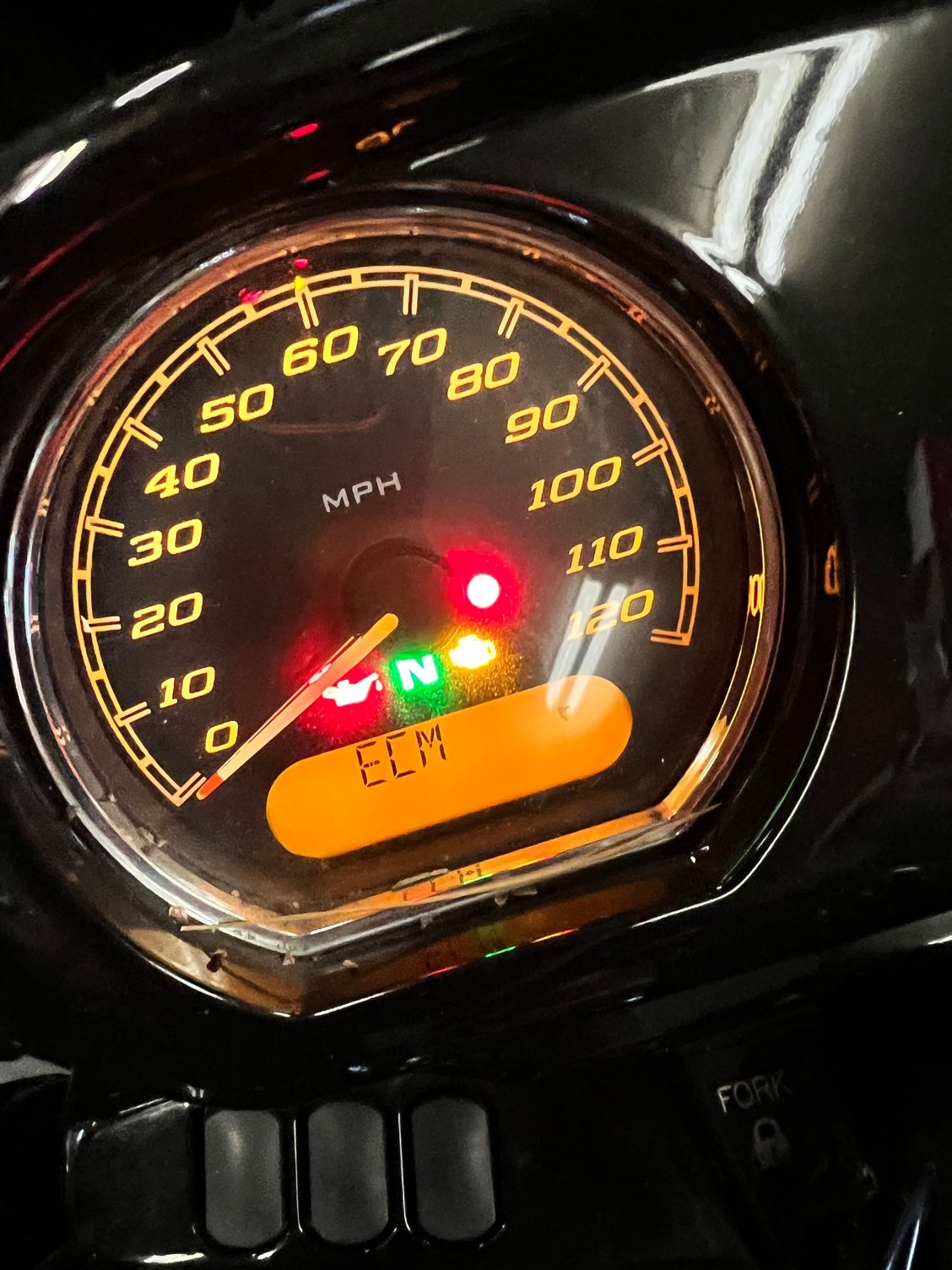

A few months ago I went to start my bike and it just clicked. I tried jumping the bike and same thing. I just got a new battery got it installed and the bike still won’t start. The fuel pump engages but the starter doesn’t even click. I pulled the codes and they are U0100, U0141H, U0142, U0156 and U0184. I tried clearing them but it won’t clear any codes. I tried unconnecting the battery for 15 min and reconnecting it and nothing. I tried accessing the fuel pak with my phone and it is telling me it isn’t connected to this bike anymore. I’m at a loss please help!
When I pull the codes there is no Y or N next to the ECM one.
When I go in to see if there is any codes under the ECM option this is what it says.
Not sure what the F this is either

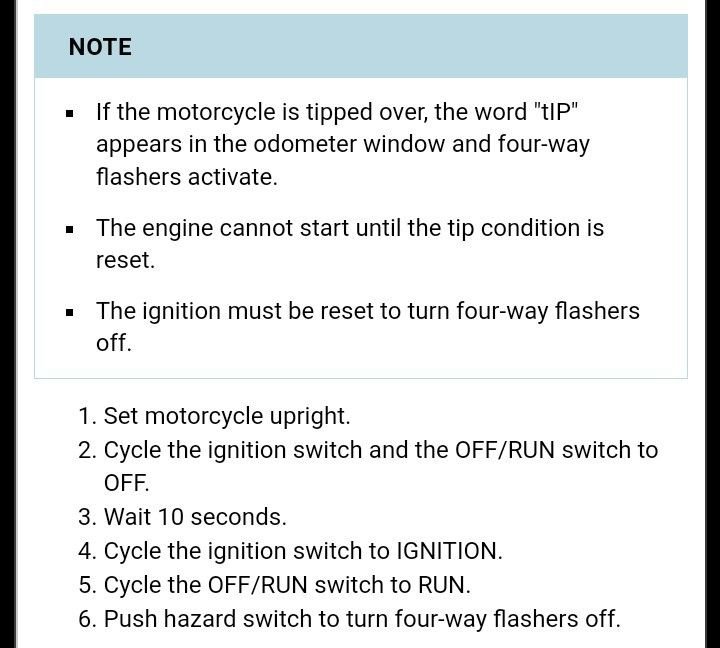

Old Feb 26, 2023 | 07:19 AM
barneyboy's Avatar
barneyboy
Joined: Dec 2017
Posts: 5,076
Likes: 3,293
From: Plover, WI
Old Feb 26, 2023 | 11:26 AM

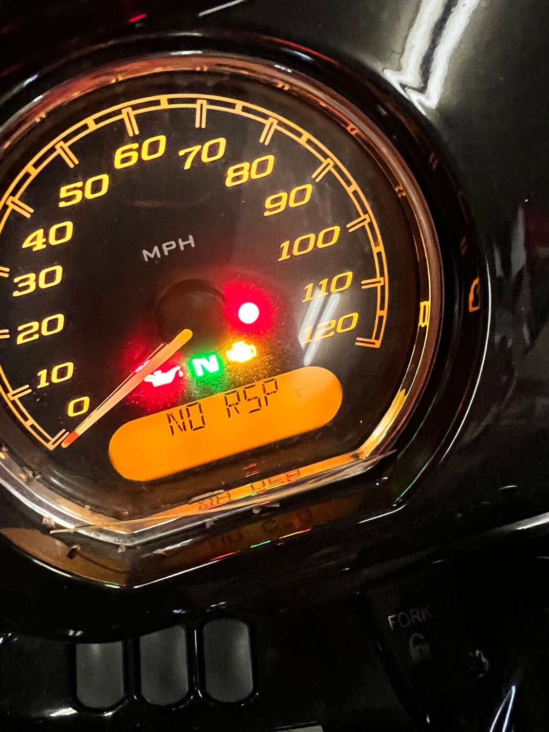

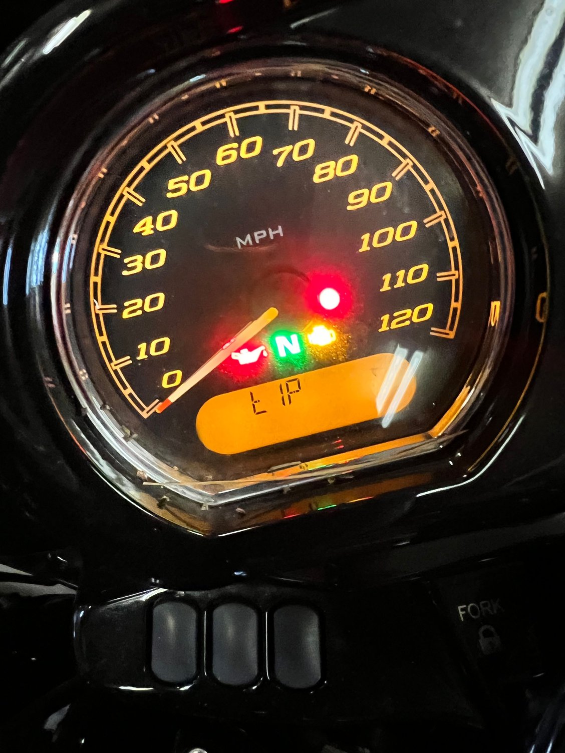

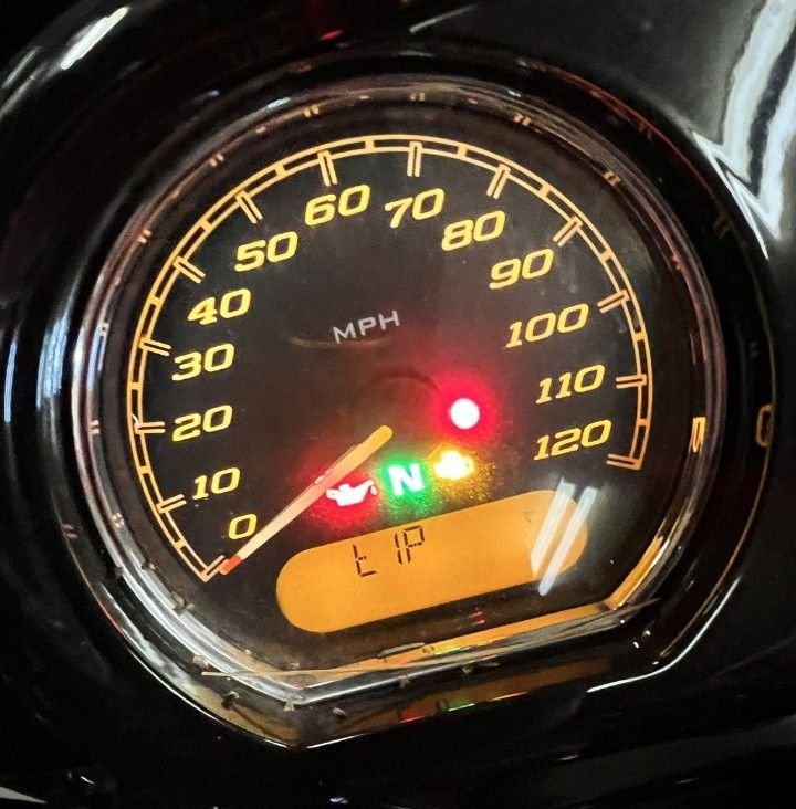

Isn't TIP typically set by the BCM? If comm to the BCM is lost by the Speedo maybe it sets TIP?
Was there a No Resp error with the BCM?

Good catch about the “tip” flag. I believe it’s set by BCM and I don’t think comm loss would trigger it, but who knows.

If you have a valid tip, bike won't start.

Yup, when tip is active can’t start the engine, but I’m guessing it’s all part of the same problem - loss of comm with ECM, tip triggered, either connectors or wiring under the seat are the places I’d be looking first.
edited to add: OP changed battery - have to move the ECM out of the way to get there, so connector might got loose. Also from what I’ve read before - “jumping” is a crapshoot.
