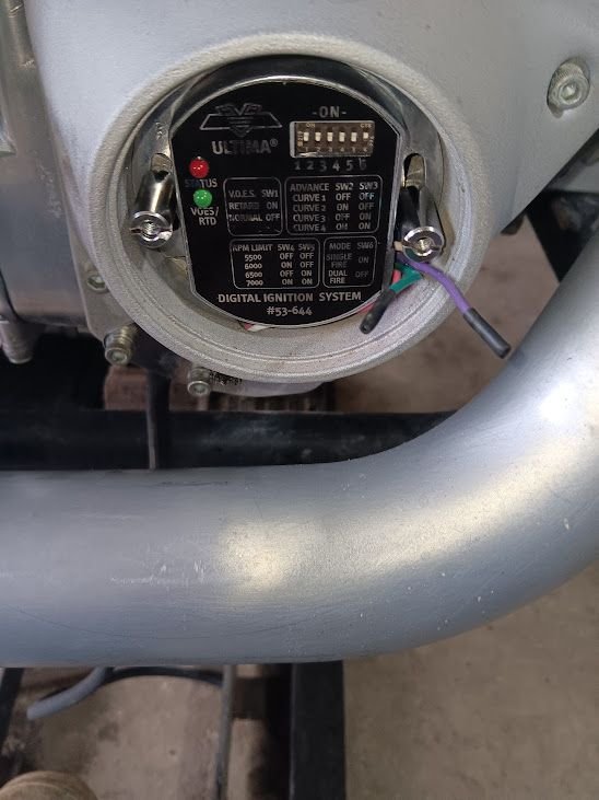

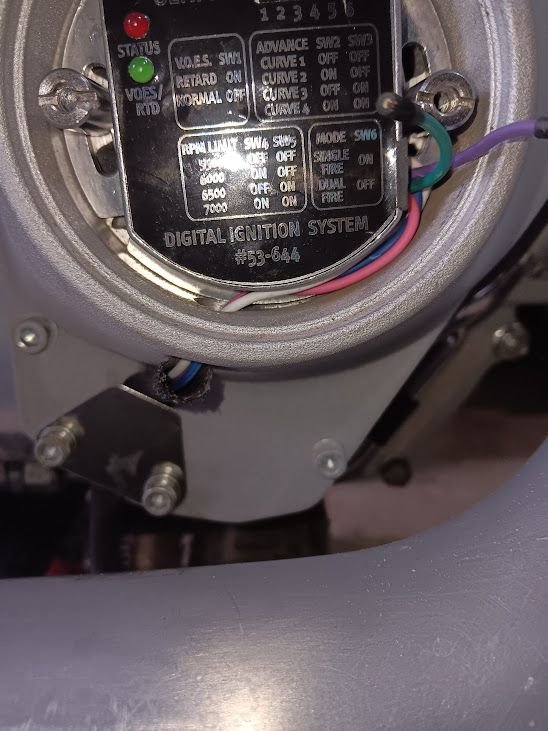

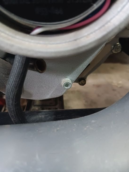

I have an EVO and installing an Ultima ignition. anyone else have trouble running the wire with the sleeve through the hole? I cut off the tack wire and voes but had to leave the sleeve off. There isn't enough room for the wires to turn and go under the ignition and out the hole.

Check the diameter of the hole with a drill bit. Then grab a bigger drill bit and open the damn hole up.

Also that covering tends to expend when you scrunch it together. Try stretching it out by stroking it with your hand.. (boy does that sound weird )
