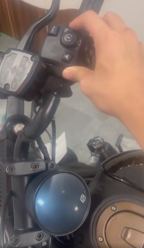

Hello everyone, I am new to the HD scene so I really appreciate all the helps and recommendation
The other day i was riding my 21 sportster S. i turned the bike off at the traffic light to stop the engine noise then turn it on instantly to skip all the pin code, waiting for the screen to appear kinda thing.
The screen stays on for about 2-3 second before shutting off completely.
My friend and I decided to put the bike in neutral and push it on the road. After about 10 minutes of pushing, the screen suddenly appear, no pin required and i was able to drive home.
My dumbass deccided to turn the bike off and on again and the same issue appear.
I've tried keyless FOB (doesnt work), putting the FOB close to the bike but no connection(i hear a click by the seating area every time i turn on/off the killswitch), (I also replaced the fob battery),
I’ve already checked the battery (removed, charged, and reinstalled) — it’s showing over 13V, which is healthy
If anyone with experience with this model knows how to fix it, please help me out.
Thank you everyone, thank you to the forum!

Hello. I just searched the term cranking and turning over. My bike doesnt do any of that when turn the kill switch on. All i hear is one CLICK sound when i turn kill switch on, and one CLICK sound when i turn the kill switch off, still nothing on the screen

You may have good sitting voltage reading, but what really matters is the battery power under load. You have to get it load tested. Take it to a parts store and they will do that. If it's the original battery it might be toast. You also need to check the other ends of the battery cable, especially the ground. They have to be clean and tight.

Your Key FOB may have a bad battery in it. Open the case and check the battery voltage, if it's 2.9 or lower you need a new one.

i read on the user manual and one of the cause of the bike not working could be either a burnt fuse or a broken relay, not sure how to check it though.
It could be my FOB as Mr Steve Cole reply (so changing to a new FOB is an option)
i called up the HD service shop, they said that the kill switch is burned. However, the kill switch comes with the entire right handle so i would have to replace the entire right handlebar, which is about $600

so you are cycling power via the bar switch? if so, the computer may be going into fault mode and may need to be reset vis the key switch if it has one, if not via the fob. if so, the battery in it could be an issue, some systems also contains an RF chip in the fob that can start a machine if held close to a sensor. maybe the ecu has a time out and time must pass to reset, a anti-theft sorta thing.
