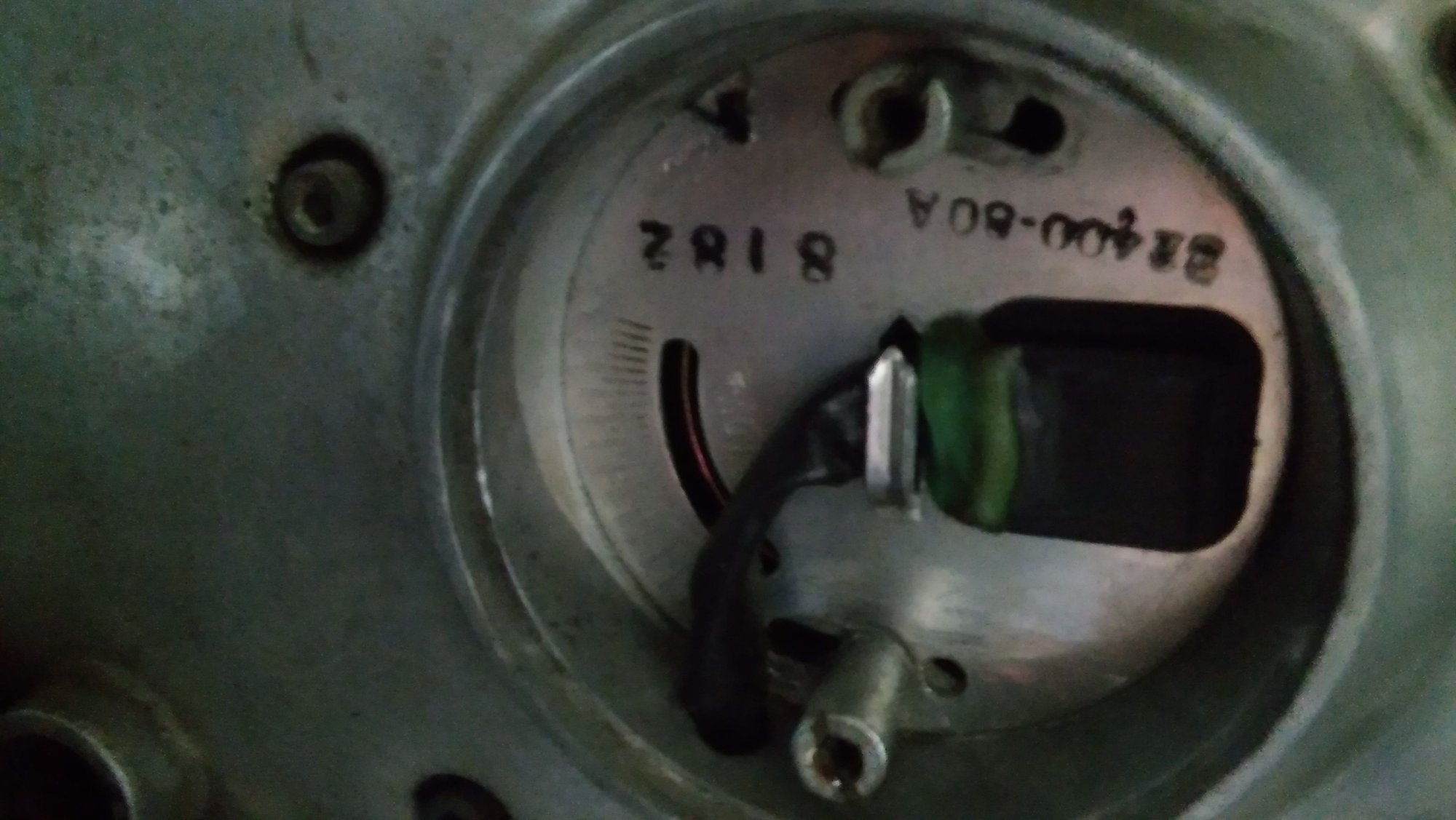

Does it have the original electronic ignition? Or an after market unit like Crane Hi-4. Ultima, Dyna, etc. If you are uncertain post a pic of whatever is behind the round timing cover on the cam cover.

here is the pic I think its stock it was set at full advanced it couldn't go any more that direction. where sould it be to static time it before I get a light.

The Factory Service Manual 99484-85 is the only source if information about that ignition system. You can buy this manual from any of the usual sources as long as you quote the part number - local HD shop, local indie motorcycle shop, eBay, Google, J&P Cycles, etc.
For static timing, set the sensor plate so that the screws are centered in the slots. Snug down the screws. Engine can then be started.
The front cylinder advance timing mark is the single dot.
