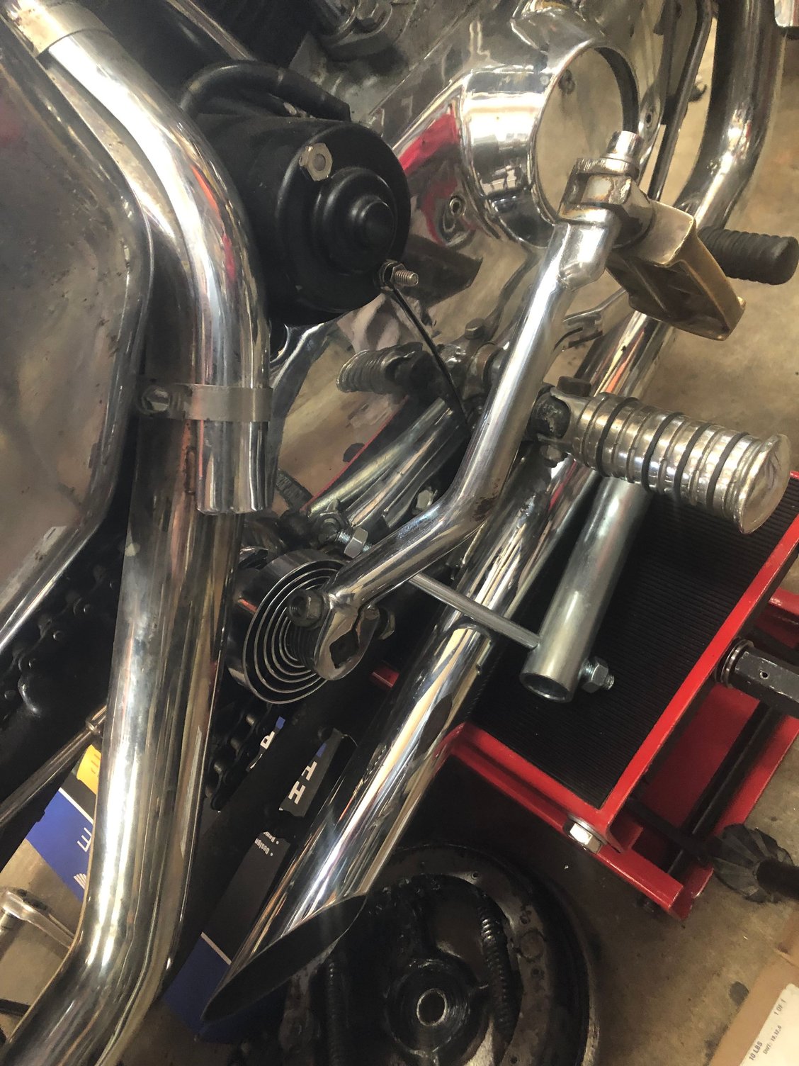

I just bought a 72 XLCH. I bought it from a kid who did not ride it (Or even start it). The kid had a 'friend' fix the kickstarter.
When I bought the bike the kickstarter spring was on backwards. So the kickstarter would not return. I did kick the bike to life when I bought it.
I put the return spring on correctly and the kickstaters returns to just above the foot peg.
I have not worked on a Harley kickstarter. I have worked on a bunch of kickstarters. Normally this is a phase thing, the position of the kickstarter shaft is in the wrong position when assembled. I have a manual coming in the mail. I may try to tackle this problem before it arrives.
Does anyone have some tips or instructions?

It looks like it was assembled 180 out. I will have to remove the primary drive to fix it. UGH!

Feb 28, 2022 | 12:57 PM
Kickstarter pics

Feb 28, 2022 | 06:45 PM
Why can't you take the kicker arm off and rotate it?
Reply 0
Mar 1, 2022 | 07:04 AM
Just rotate the kicker arm. You cannot. There is a groove.
You cannot rotate the kicker arm because there is a groove for the pinch bolt. The shaft has to rotate.
Reply 0
Mar 1, 2022 | 08:21 AM
My shovelhead bolt grove goes all the way aroud the kicker shaft.
Reply 0
Mar 1, 2022 | 11:57 AM
Quote: My shovelhead bolt grove goes all the way aroud the kicker shaft.
Reproduction shafts have the groove in all 4 locations, OEM have only one groove. It was a thing when I put a kicker on my Shovel, clocking it correctly took a lot of texts to others to get it right. Pretty much what the OP is calling phasing.
