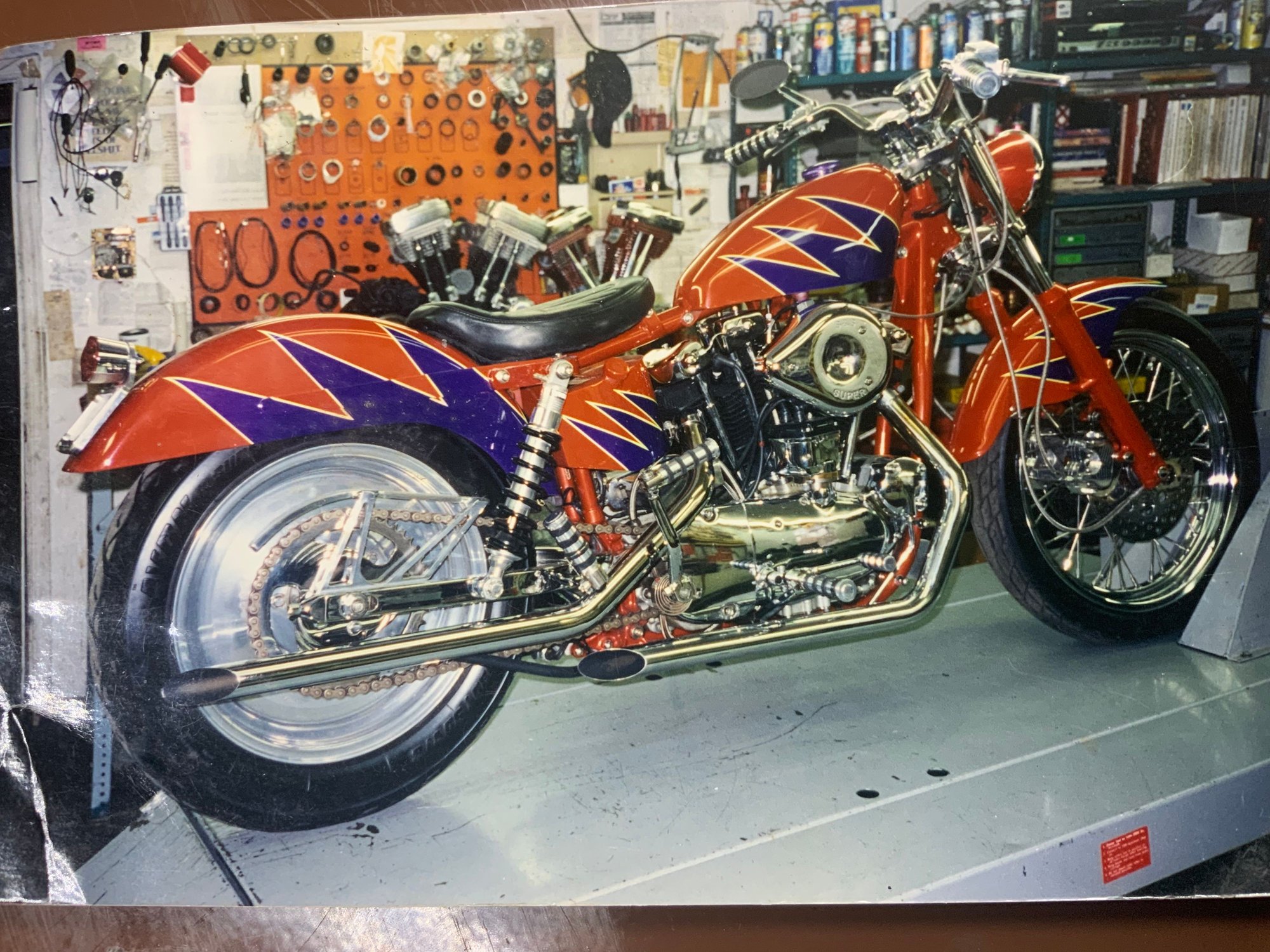

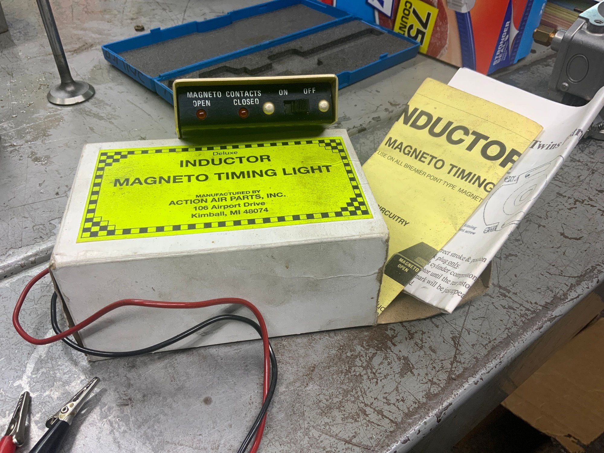

If your running a mag and intend to keep it then buy one of these - we do many custom machines and oil spraying all over the place is a joke that takes hours to clean a machine like this one
