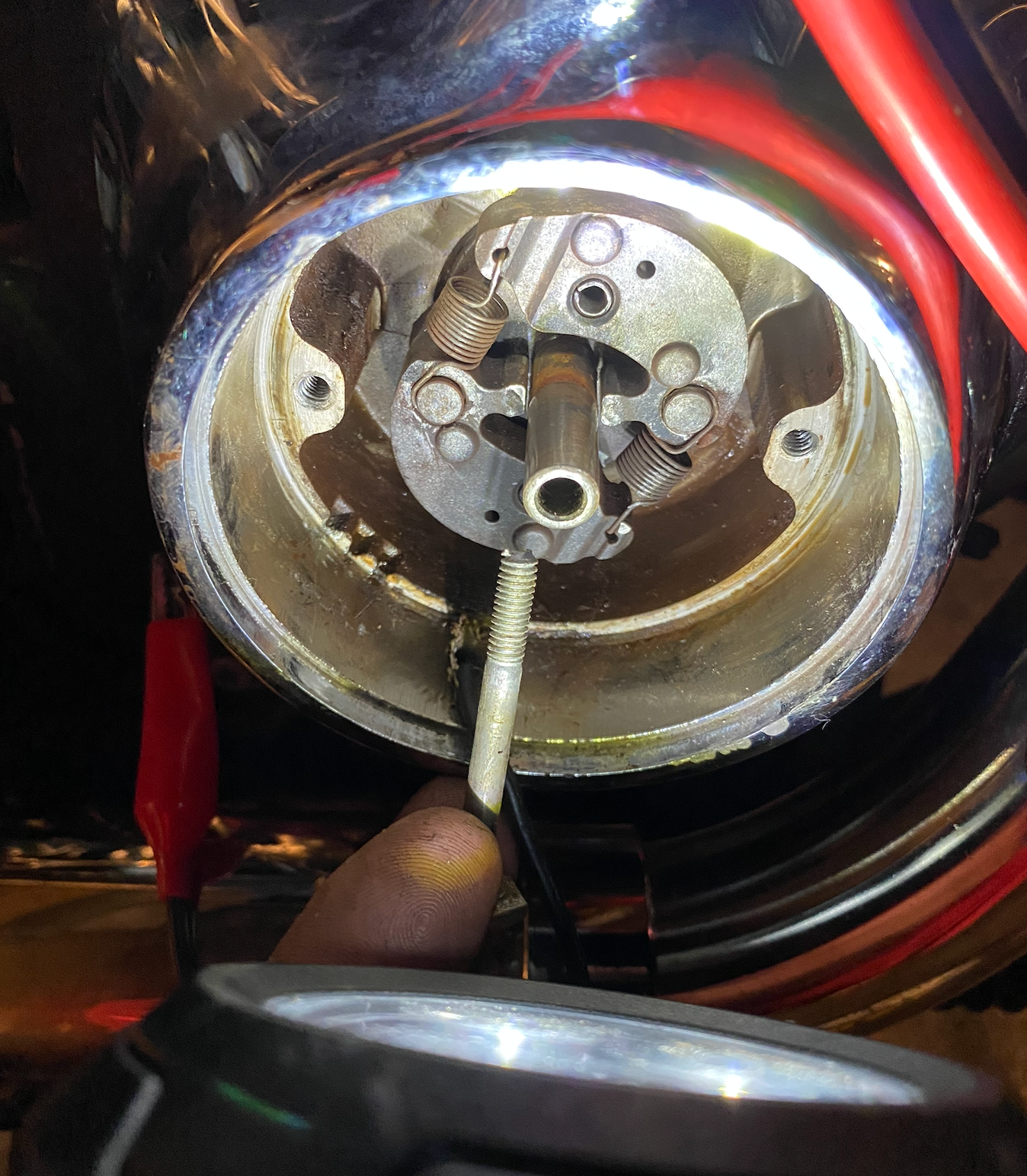

Hey gents, similar problem here with a 1990 Springer Softail. Any advice on the best method of getting busted piece of screw out? It's further down and not close to the opening. See photo...

Take the advance unit out, Looks like it is Past service interval anyway.. If still too far into Cam...it may be of Benefit to remove Cam..and dig it out...or..replace Cam!!!
Who in the wide world of sports put a Mechanical Advance in a 1990 Evo?? What Ignition???? Mat look into changing that also..Unless it may be a Dyna-S which I like alot...But...Not if one Ignores the Mechanical Advance Mechanism..

Put the cam in a drill press and drill the old bolt with a left hand drill bit.
That mechanical advance unit is cave man stuff, and on a 1990 it is the weak link in the entire motorcycle.
Toss that mechanical advance unit into the scrap bin and install an electronic ignition system such as a Dyna 2000i.

No... Toss in Mail to Me..Sometimes I can Save them..

Most thankfully got the bugger out without damaging the threads!!!
