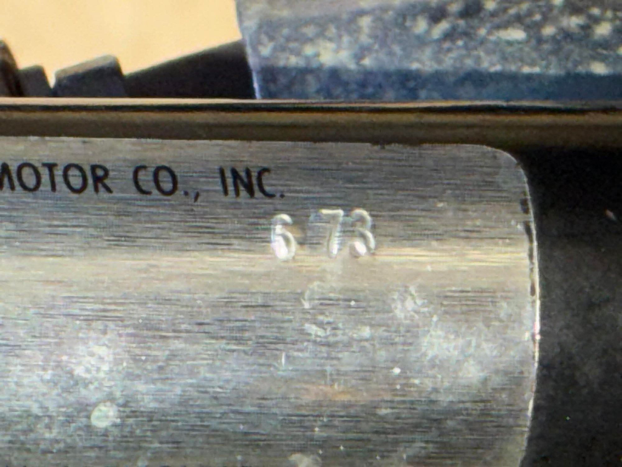

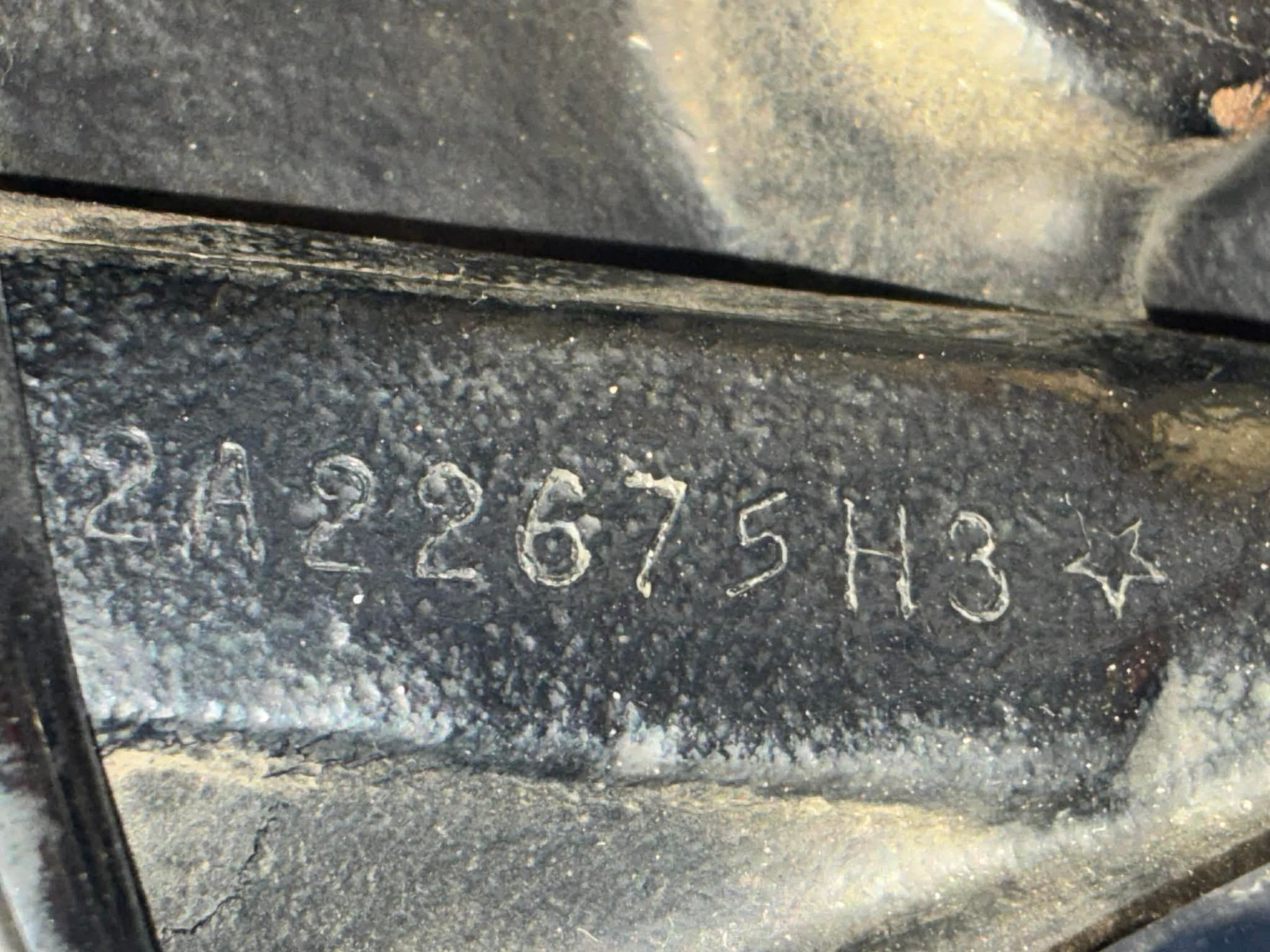

Piniongear,
Hope you are still here since this is an old thread.
I am curious in gaining a bit knowledge...
Do you know how many FLH models were built in 73? Any idea of when the first FLH of 73 rolled off the line...as well as the last FLH that rolled off the 73' line?
My FLH is 22675, tag says 6-73'
This really confuses me since the first reported model (XLCH-1000) to leave the York PA assembly plant was 4A60000 H3...as well as the XLCH-1000 you mention here, 22225, that supposedly left in early 73'
THANKS!

After two days of searching, IA finally spits this out!!
Based on 1973 production data, here are examples of consecutive or near-consecutive serial numbers:
  • FX Models: 12100H3 to 19200H3
  • XLH/XLCH Sportster (Early): 42100H3 to 50000H3 (Produced Oct 31, 1972 - March 25, 1973)
  • XLH/XLCH Sportster (Later): 60000H3 to 71568H3
