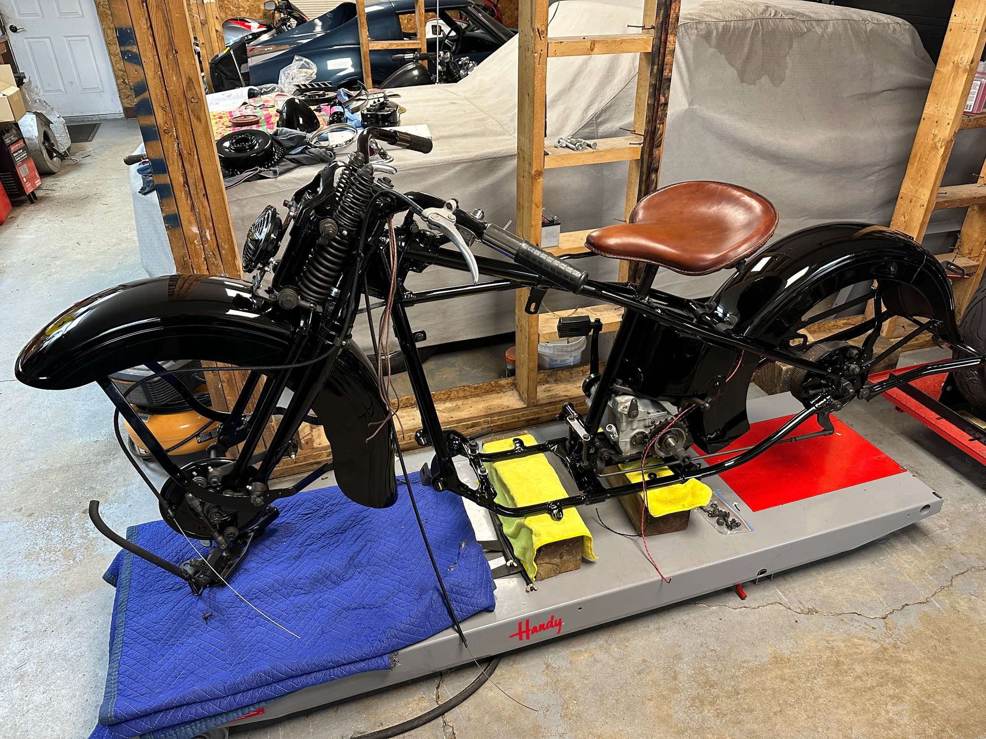

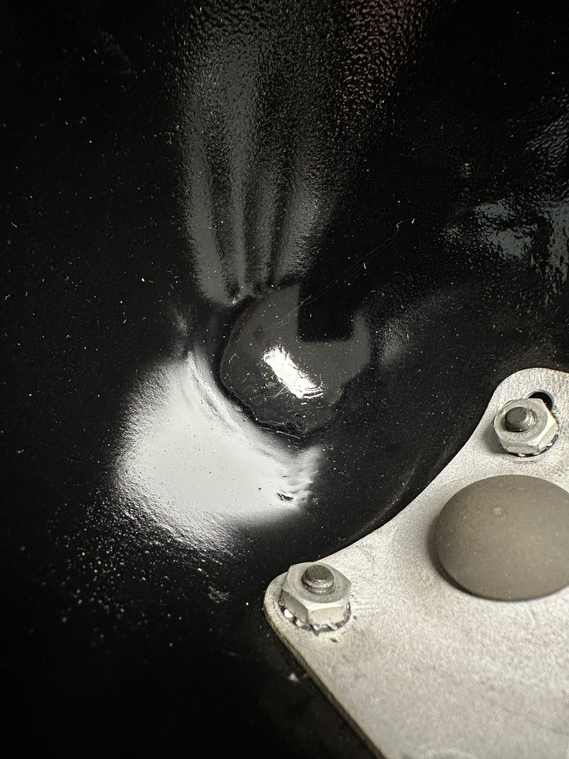

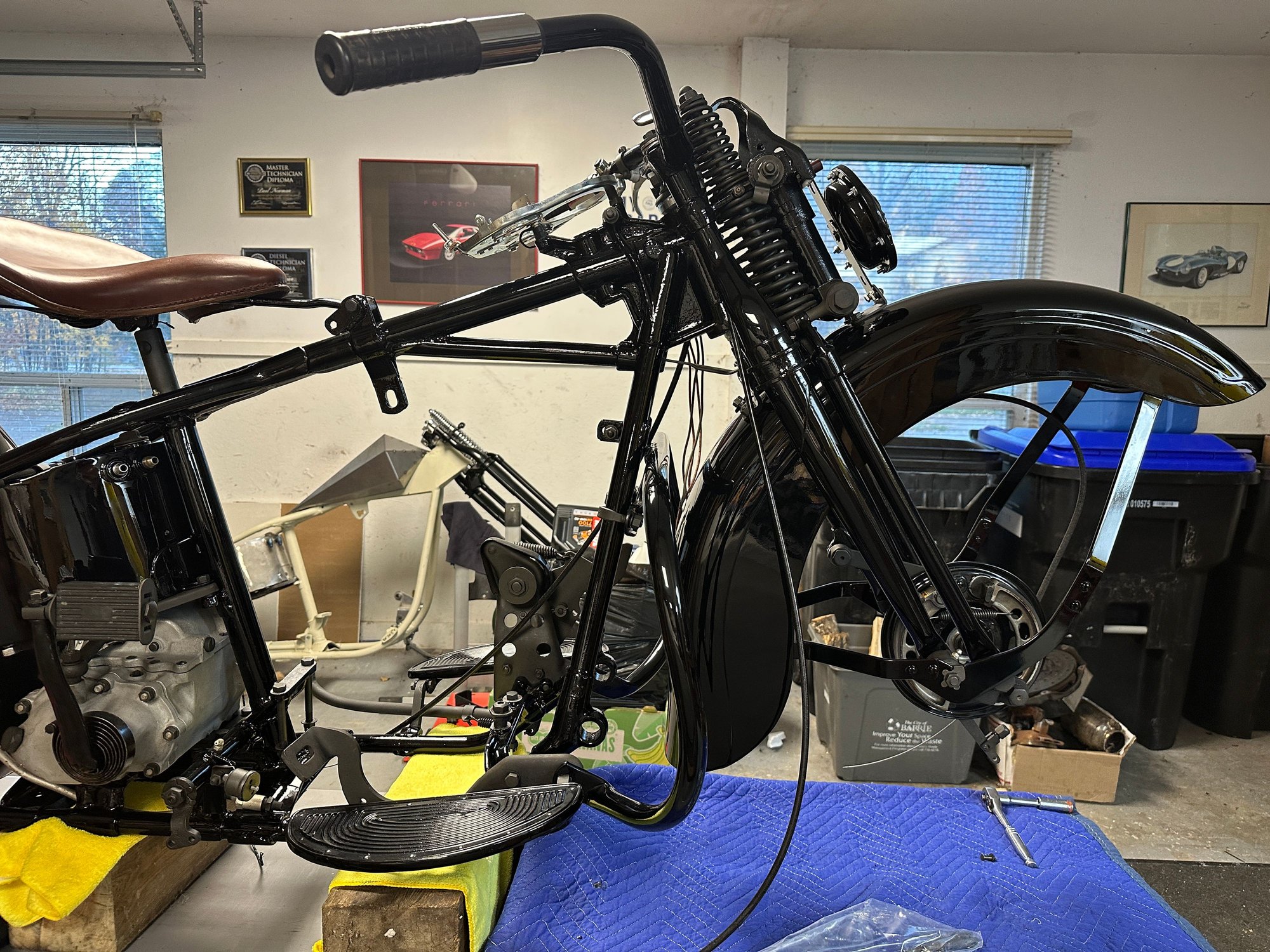

I need to investigate the carriage bolt color on the horn grill, I suspect they should be parkerized but Im not sure.
The horn grill is an original steel painted part with some patina. The front shock is also oem, head light bracket etc.
Front brake is an aftermarket dual leading shoe so the brake actually does more than just make a rubbing sound. I have a restored oem assembly stashed away. I did the same to my 48.
Bars and wiring are next then I need to concentrate on the engine.

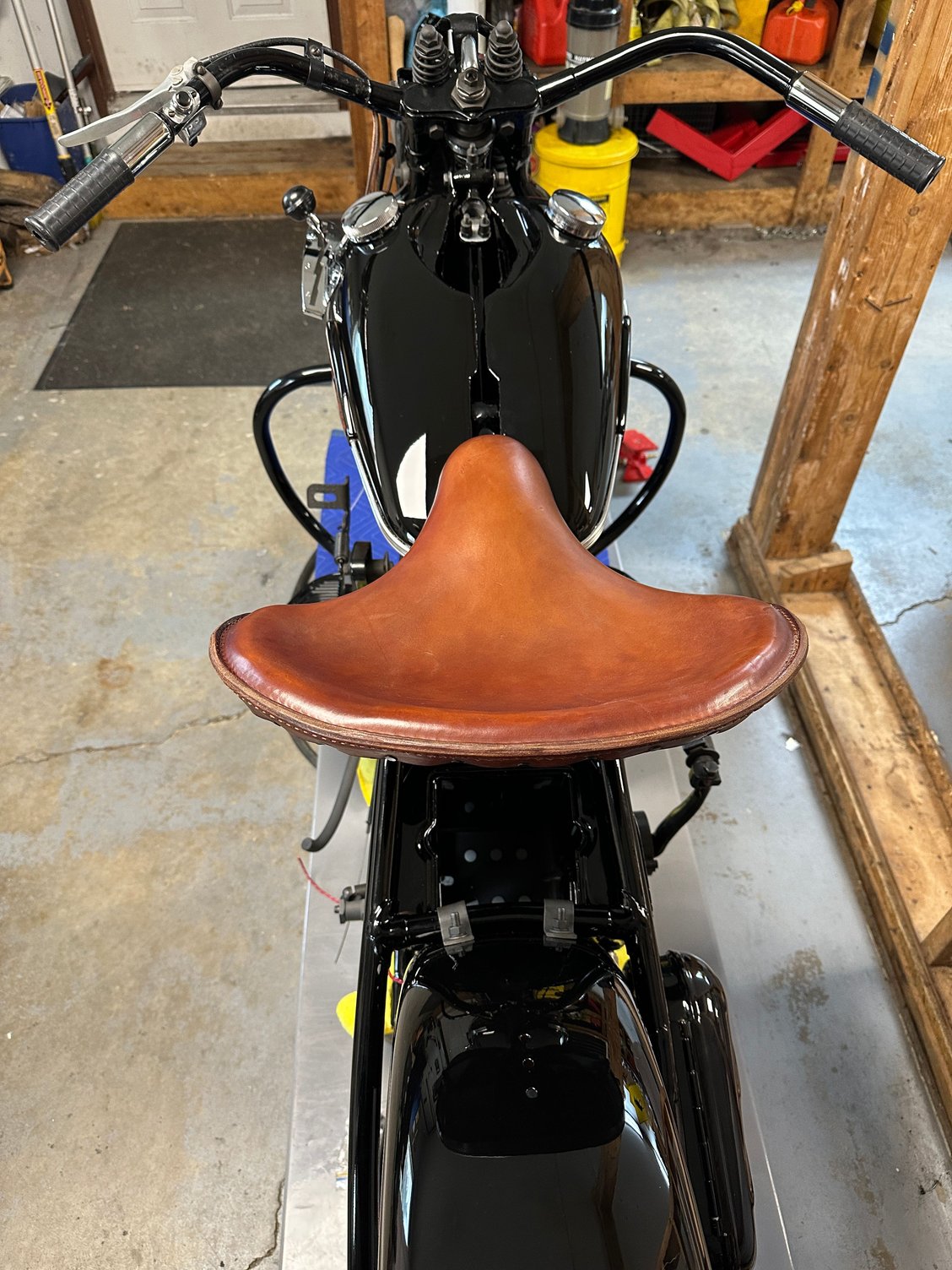

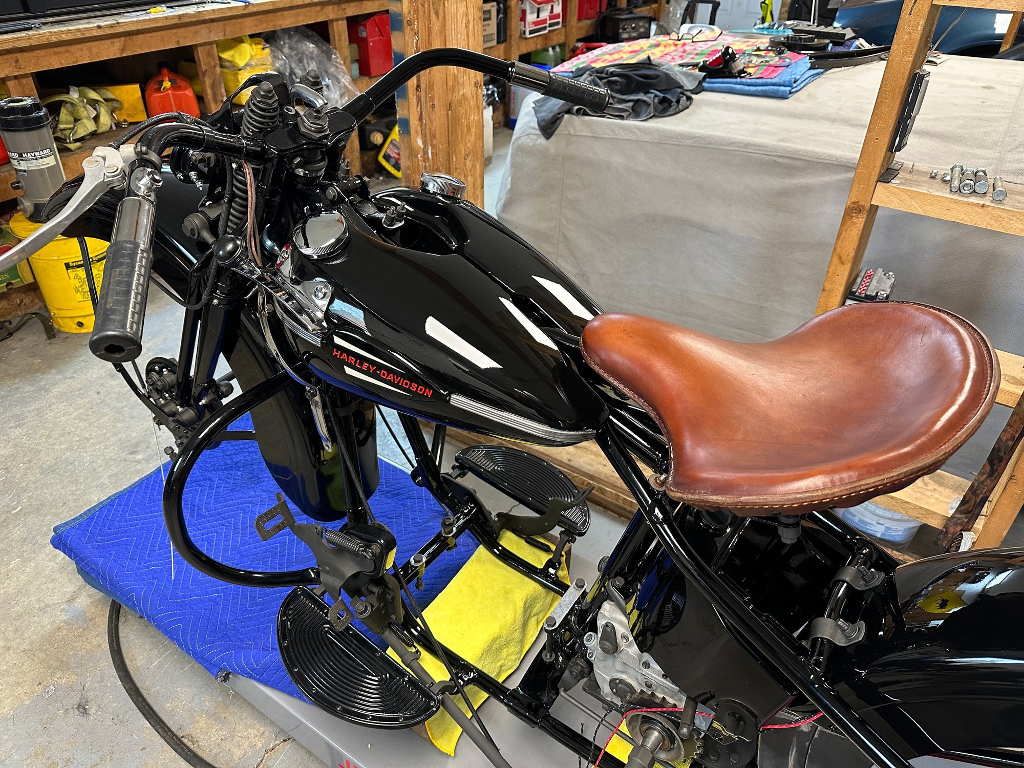

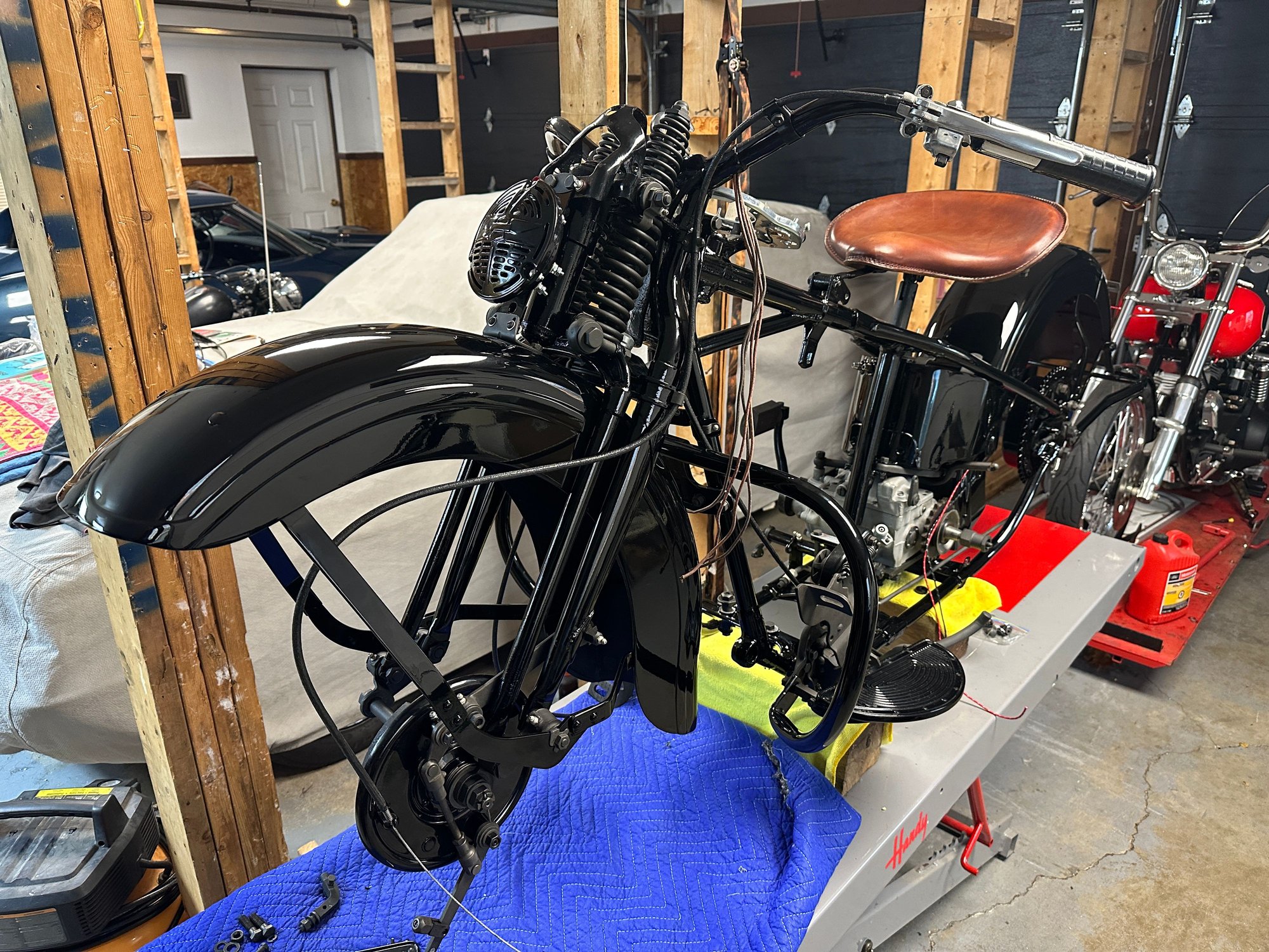

More progress,
Hand grips are original used grips, front brake cable is NOS, Heathers Leathers did the seat (I chose the color correct or not I liked it), front bar wiring is oem, tin foot board mats are oem.

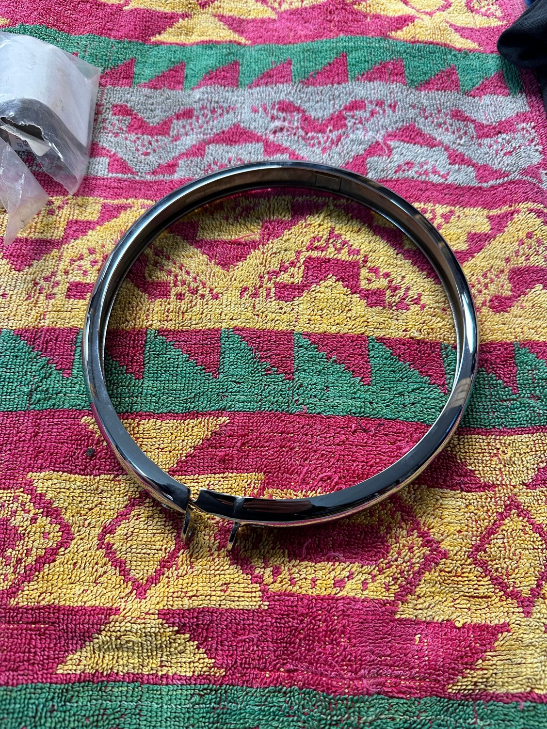

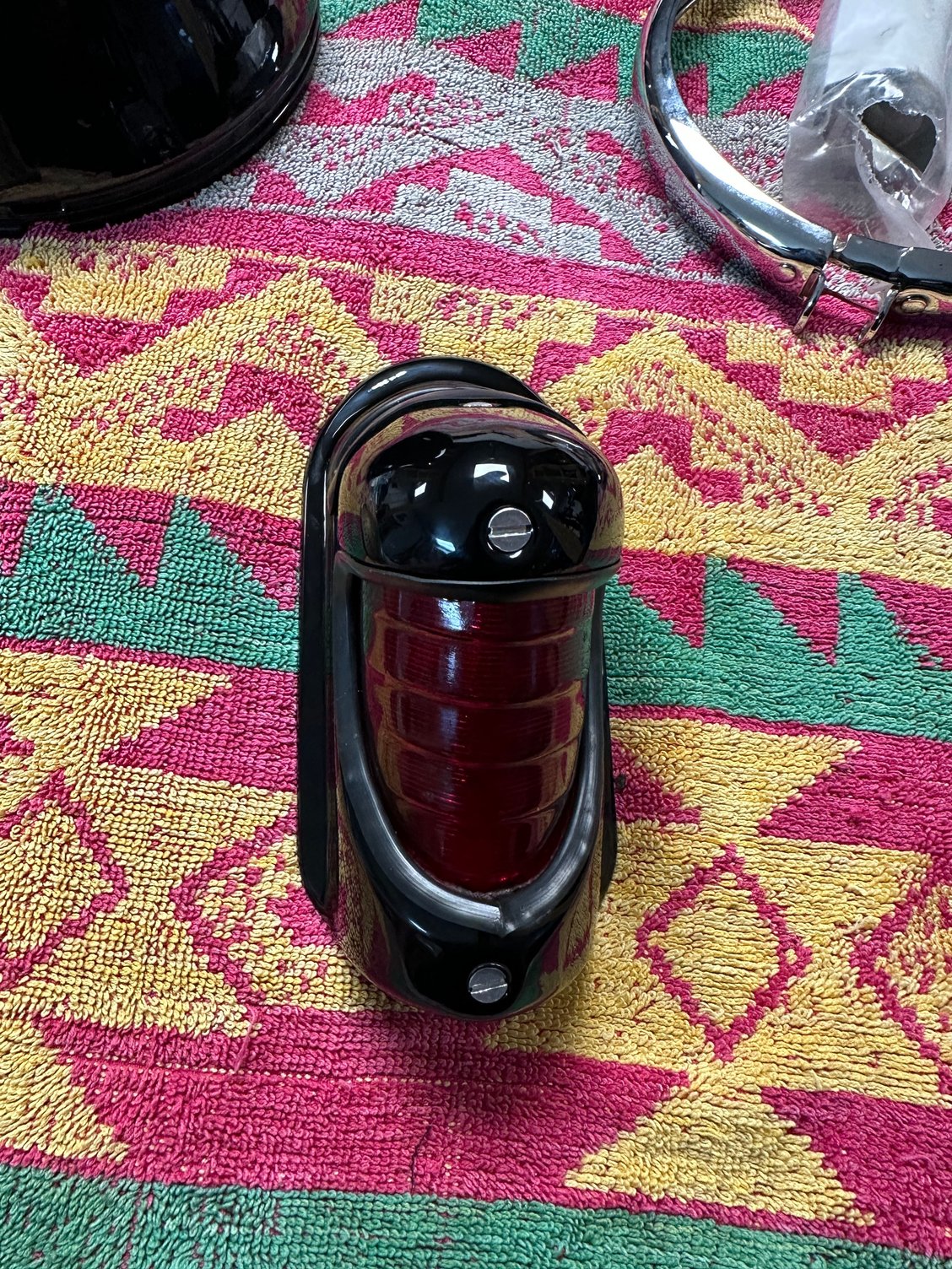

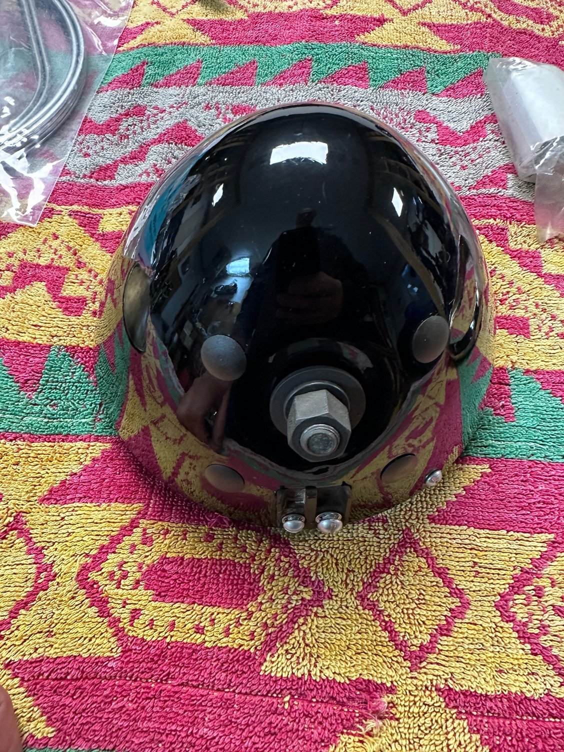

Headlight is oem, the paint kind of buried the guide script but it is visible from inside. The chrome bezel is correct for this 46 but the rivets that hold the tabs on should be parkerized but Im not going to lose sleep over that. The bezel is supposed to be chromed before the rivets are installed - thats a drag to do.
Tail light housing is oem, Harley script also buried by paint. The lenses are oem, the rubber gaskets are not but not sure how you could tell the difference. Maybe the joint?

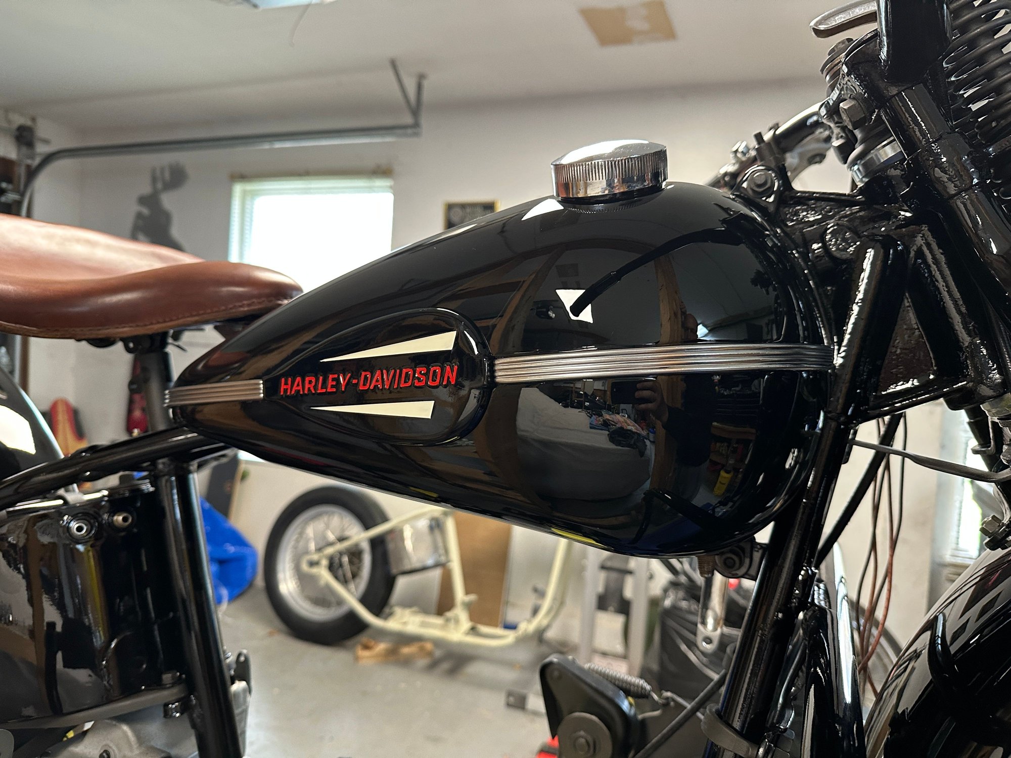

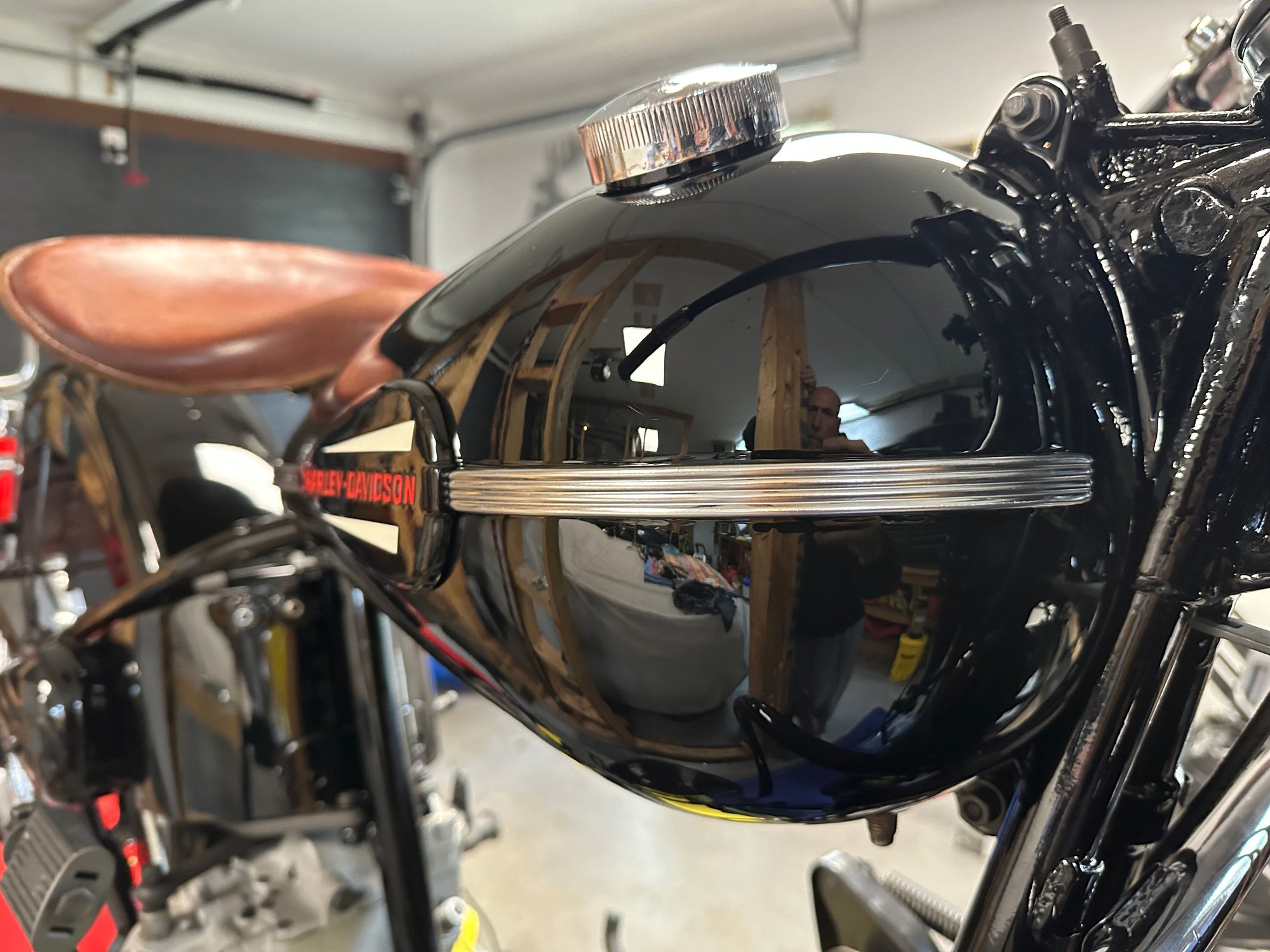

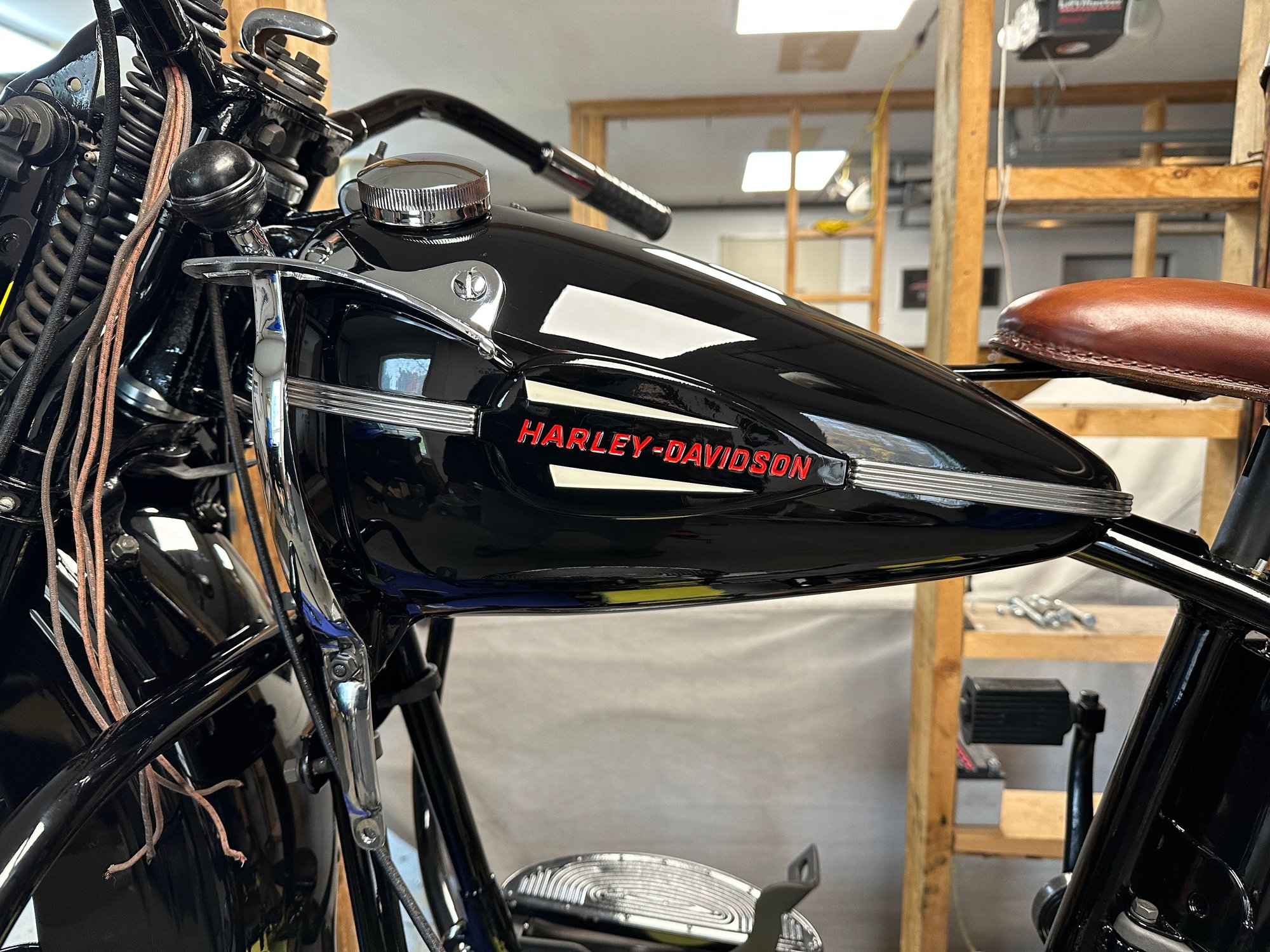

Wanted some instant gratification so I finished the tanks and put them on. Installing the emblems and especially the stainless steel trim was stressful to say the least.
OEM caps need to be restored which I'll do soon.
