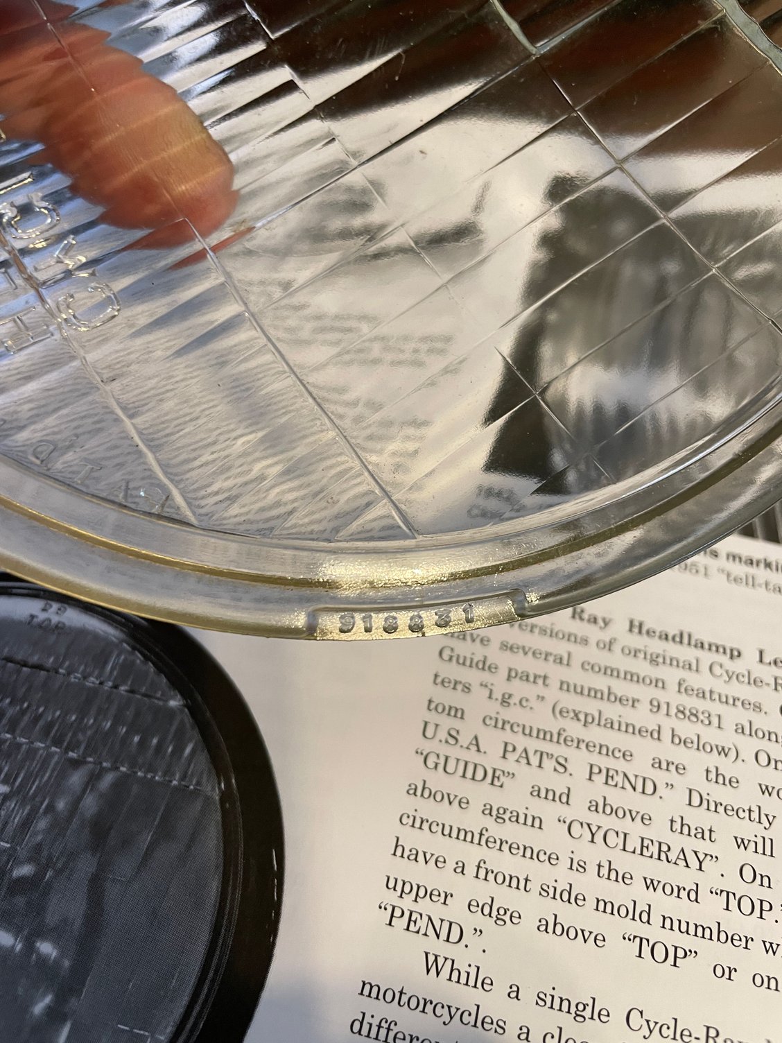

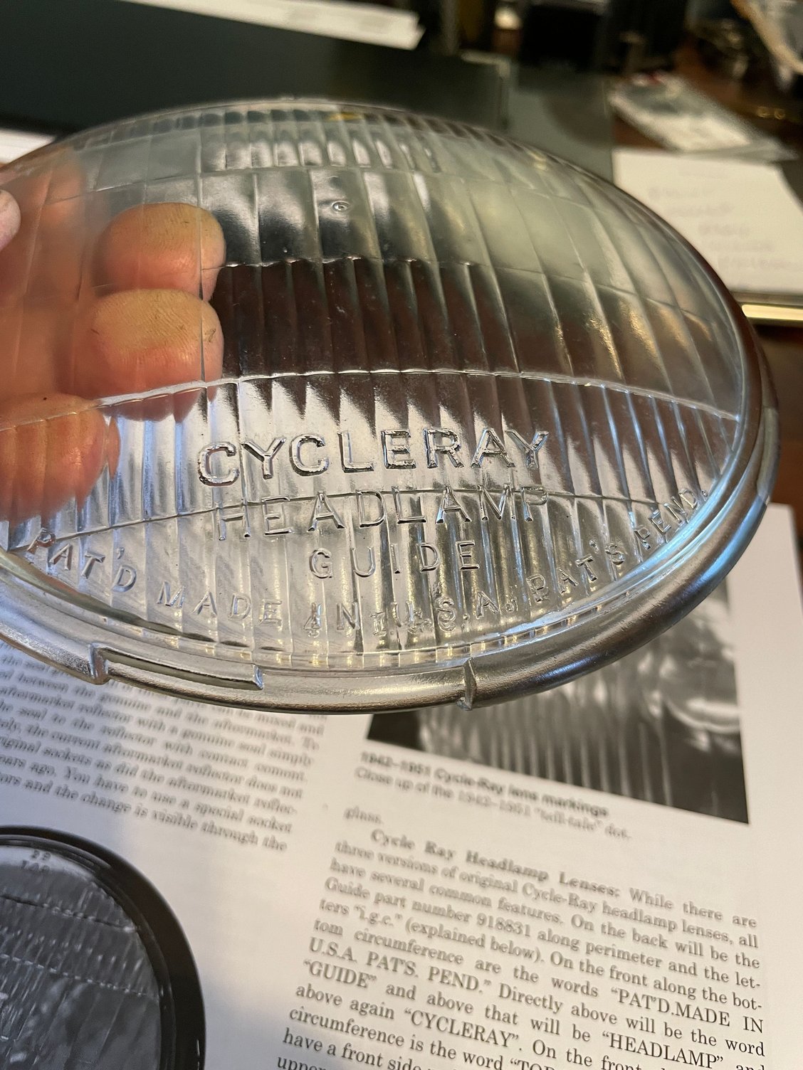

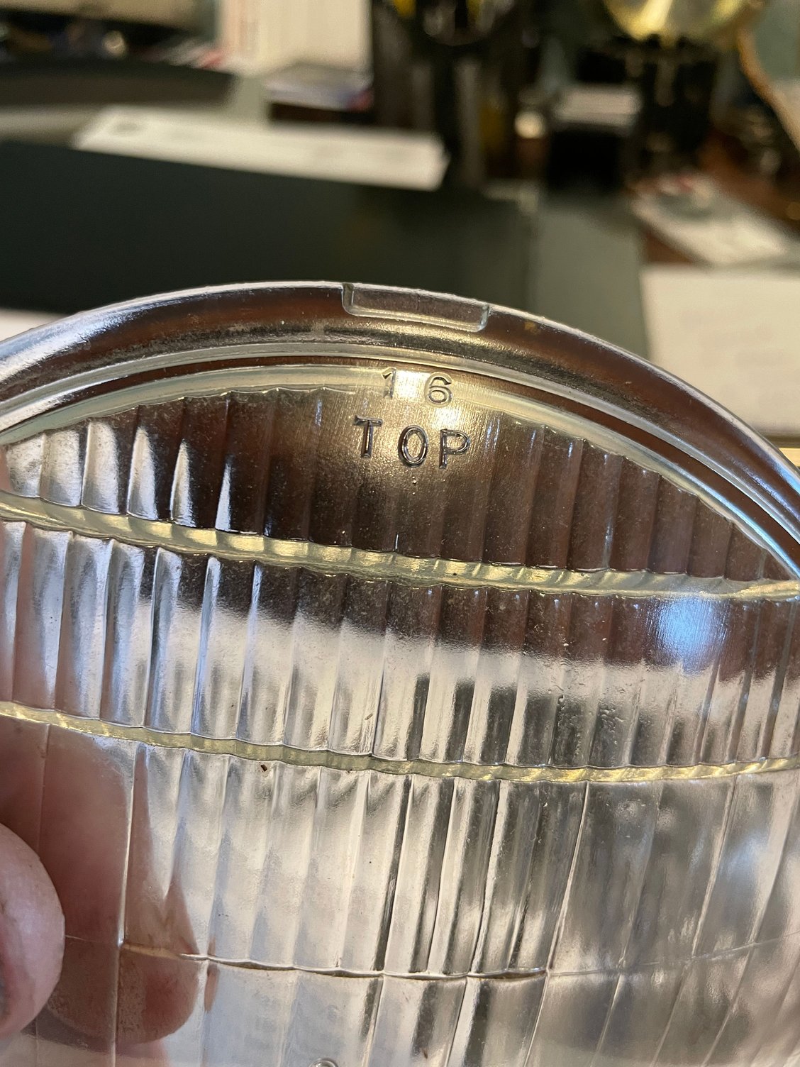

I really should be working but I had to check out the headlight lens.
It's either an amazing reproduction or its the real deal. It has the markings Palmer points out like the number on the rear outer edge but a 16 mould number not 29 like the example in the book but Im guessing like die numbers they increase over the run.
I would guess that lens is real. The better repops with all of the markings seem to be a new thing. I believe the older repop are very easy to spot by not having the numbers, center dot, etc. Considering your source, I would be comfortable assuming that thing is real.

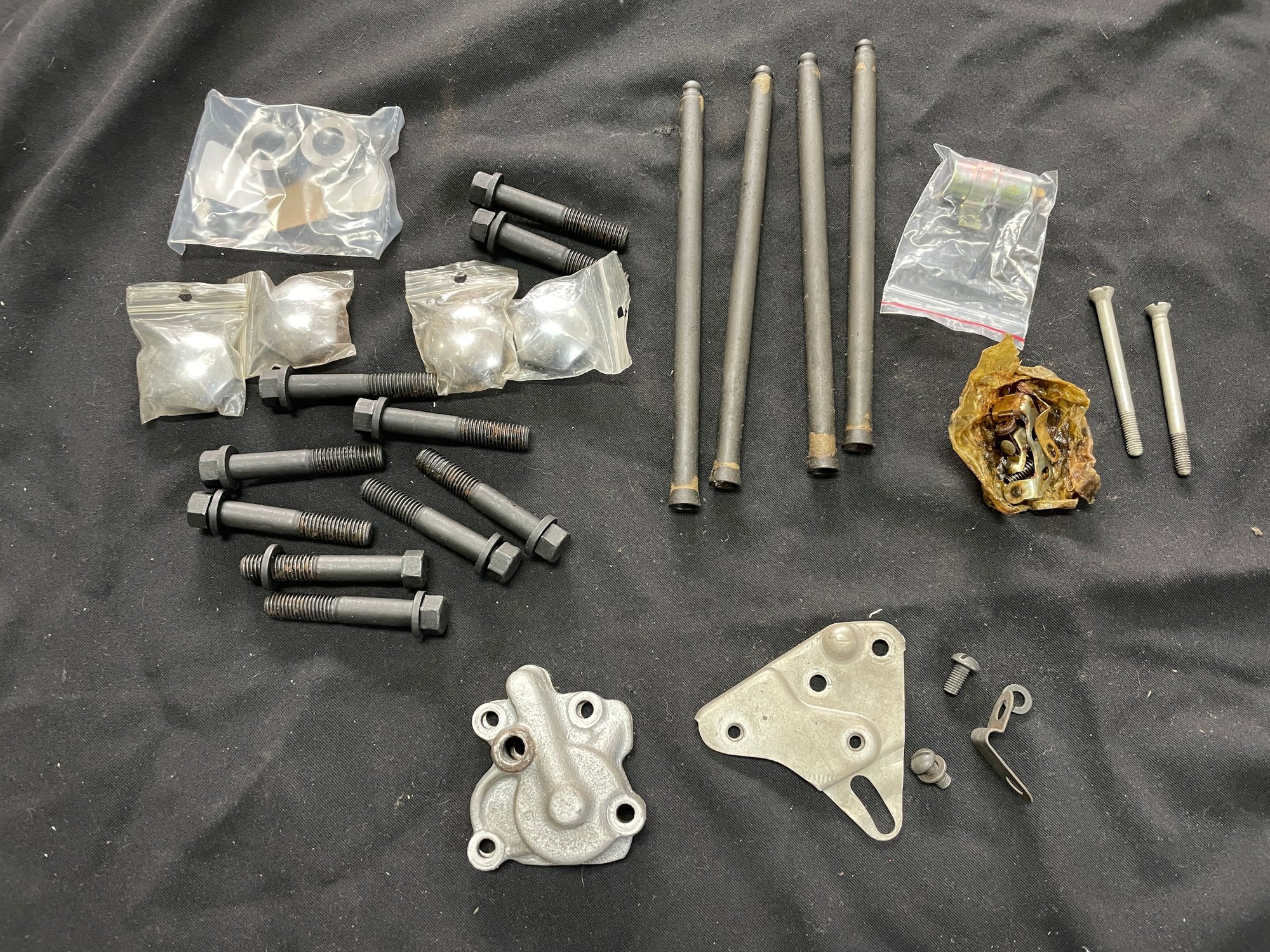

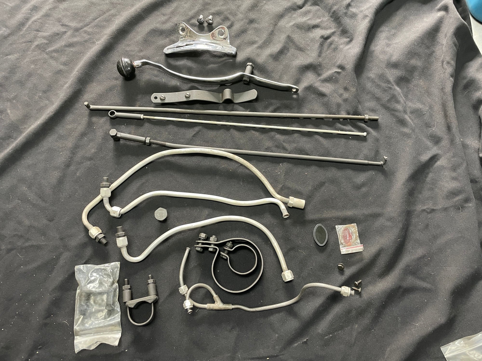

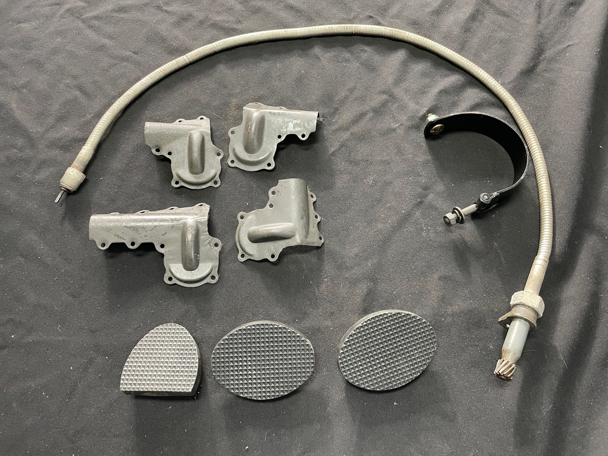

Unpacking and sorting what came with the bike.

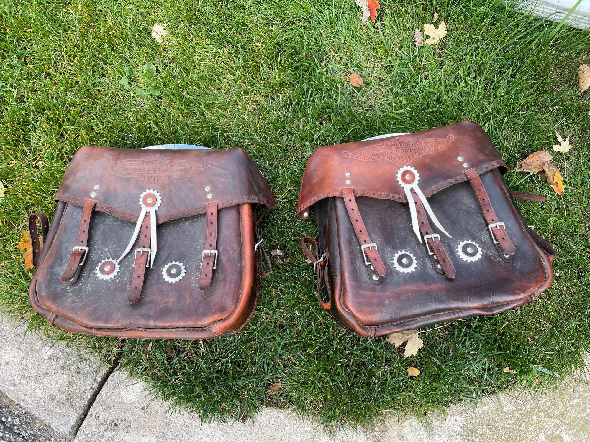

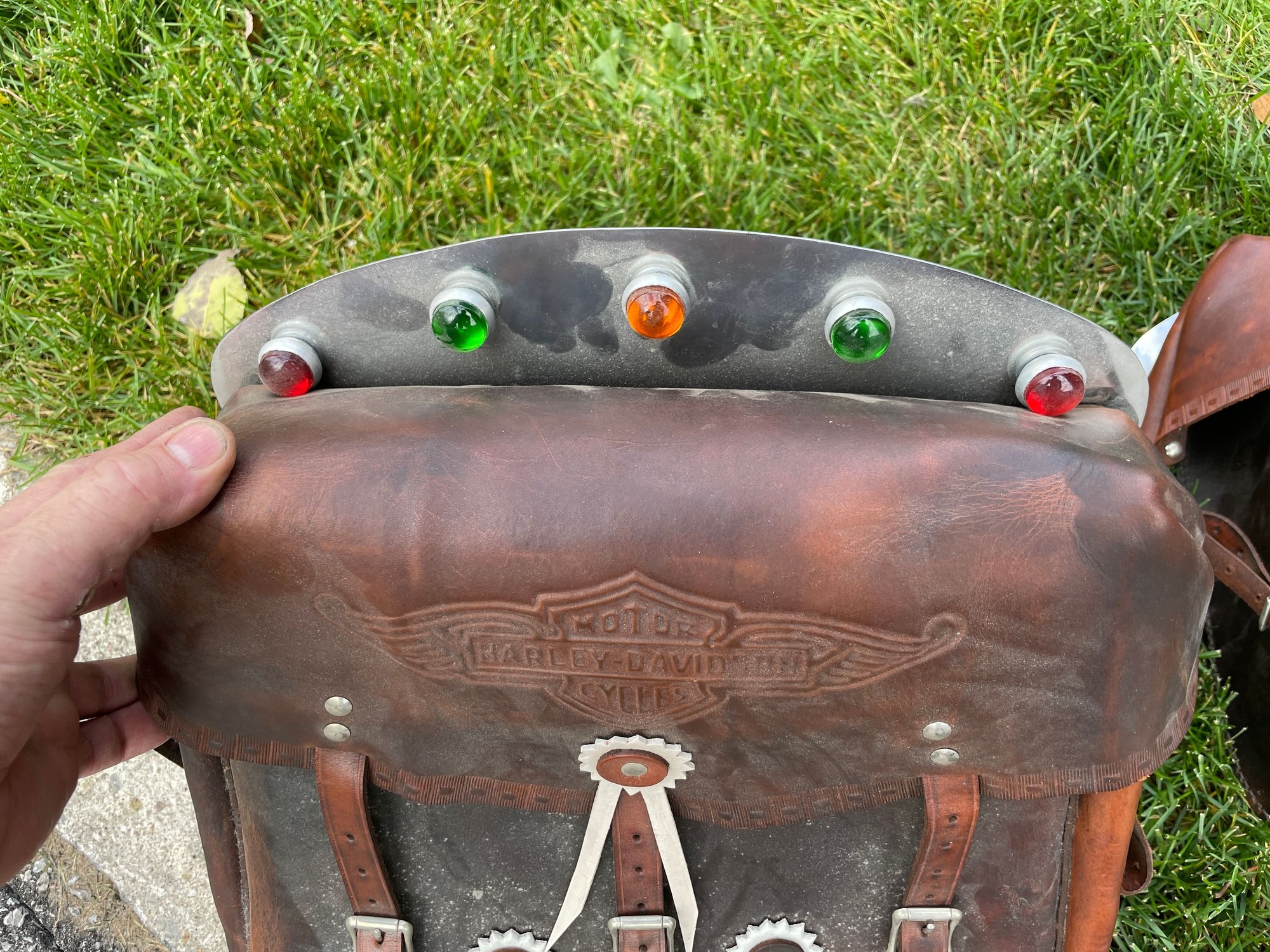

Repop bags and jewels, probably wont use them anyway.
