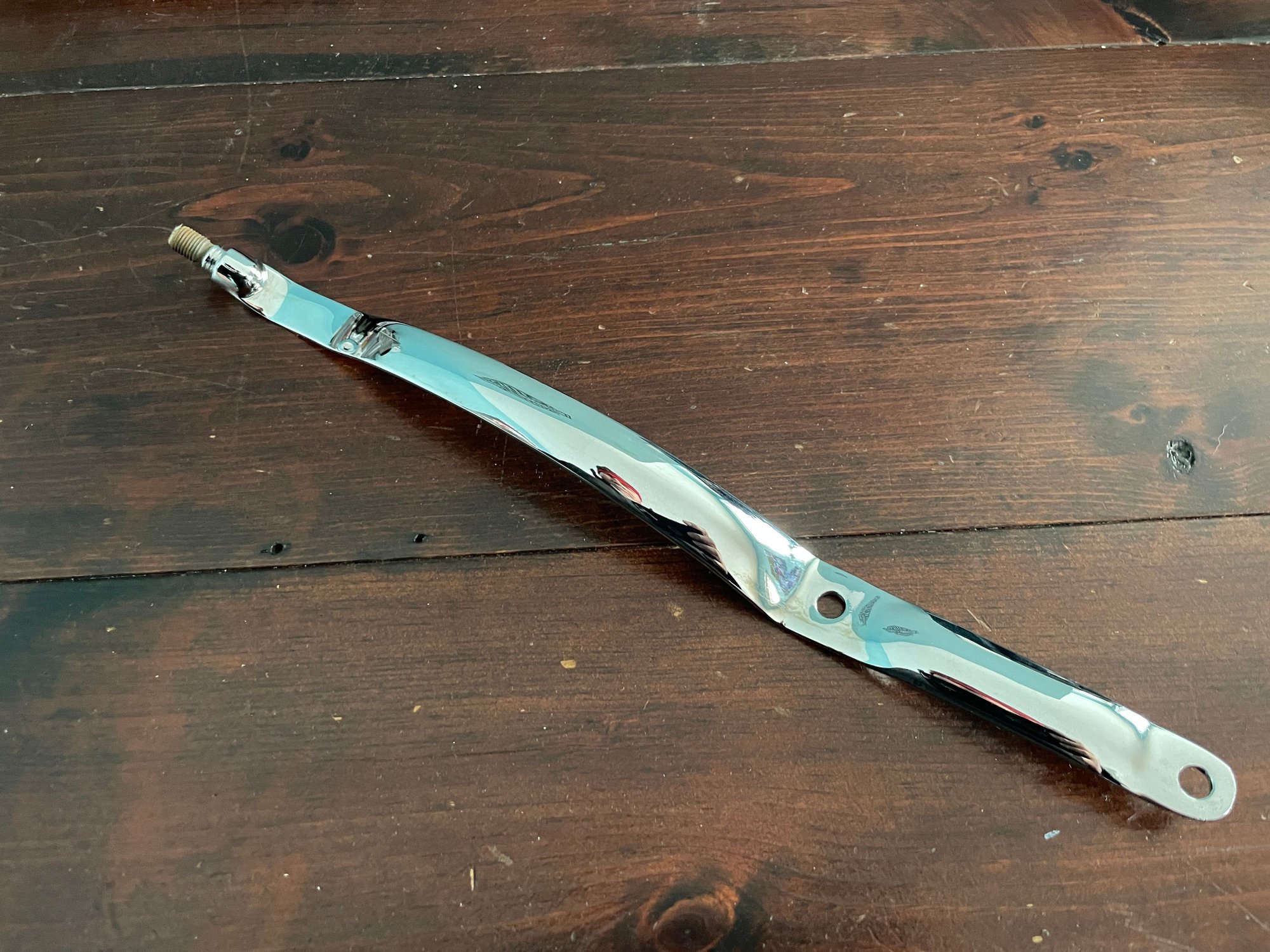

As a fellow '46 owner, I like the narrow brace fenders. Not sure why but it makes the bike a lot sleeker and in to my eye looks older. The wide braces just look clunking to me.
I have always been a no chrome guy, so I embraced the no chrome look.

I like the narrow braces as well and the lack of chrome but it's not meant to be. Everything is pointing to it having some chrome at this point in 46, just not all decked out.

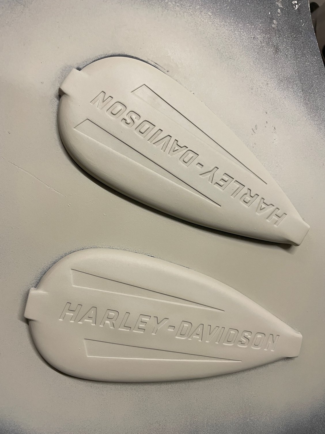

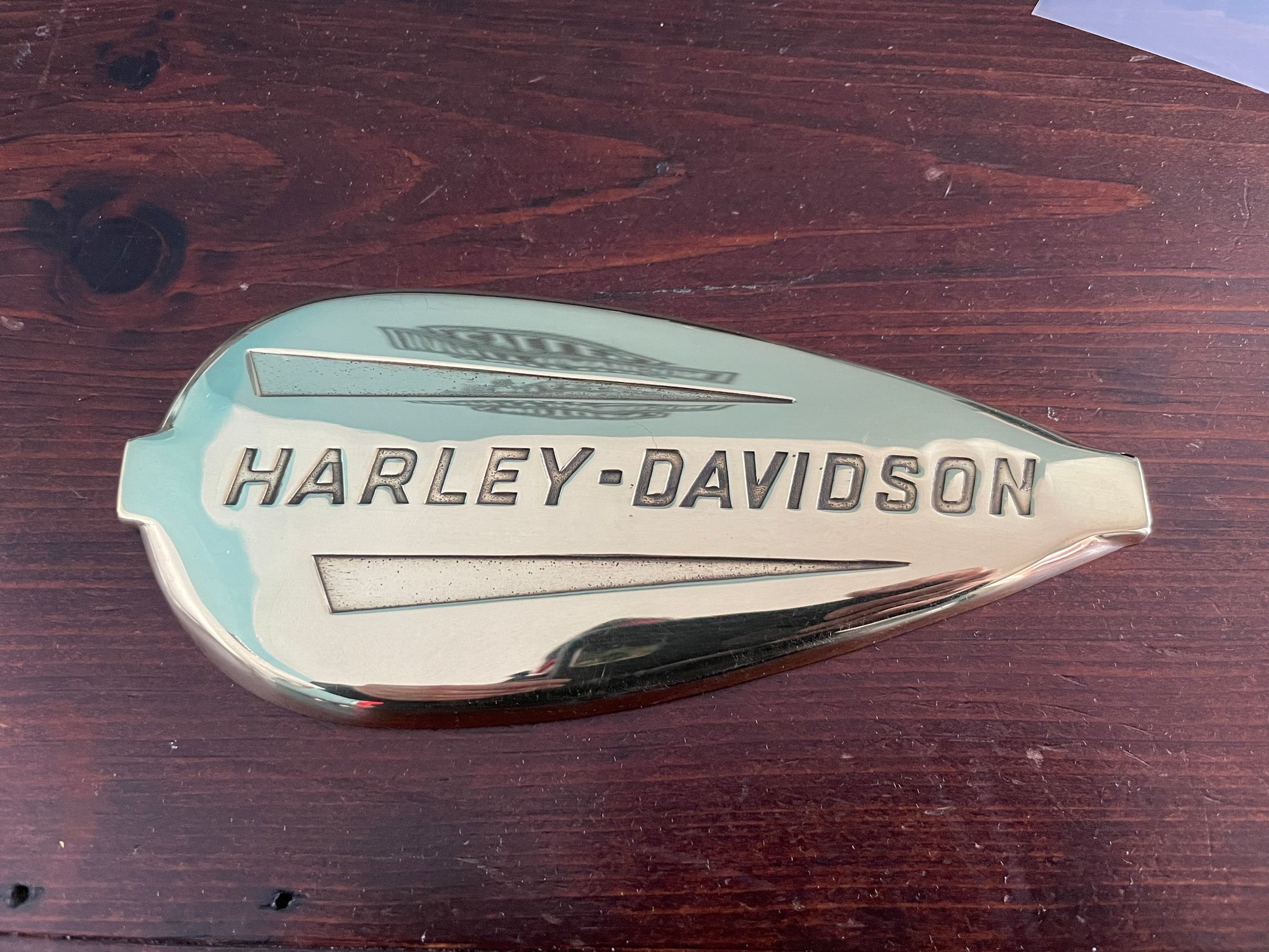

On the process subject Im experimenting on a tank emblem after stripping an original one. There's no question the paint was applied to the brass lettering and spears before chroming. Something I hadn't considered until I got looking hard at one of my emblems. I discussed it with the chrome shop and they believe it should work. The paint will stick to the brass better than to the chrome and it makes finishing the letting much easier. I'll post pics of the finished emblem in the next couple of weeks.

I epoxy primed the emblems, gloss black then the lettering after that.
This turned out much better than I thought. It has a few pits in it but I can live with that, makes it real and not one of Tedds.
The 2 rivets at the bottom of the ring holding the tabs on should be parkerized but Im going to look past that. Ignore the finger prints, the chrome is perfect.

Chrome shop brought the emblem to the point where they would plate it with copper, nickel and chrome.
Im going to paint the letters and spears then give it back to them to finish the process.

Tried a different powder coater, a kid pretty much, probably have tee shirts older than him and the work he does is crazy good. Too good to be correct actually but Im not going to have him redo them and tell him to do them poorly.

Holy **** that looks great!!!!
I had the conversation with my painted years ago doing a bobbed rear fender on the Flathead, painters do not understand not buffing and leaving the orange peel. But he matched it pretty good, it all worked out.

Fortunately I know a variety of painters ranging from never again to how is that humanly possible? The ones that think they're good but really aren't are the ones I seek out when I need a factory finish haha.
