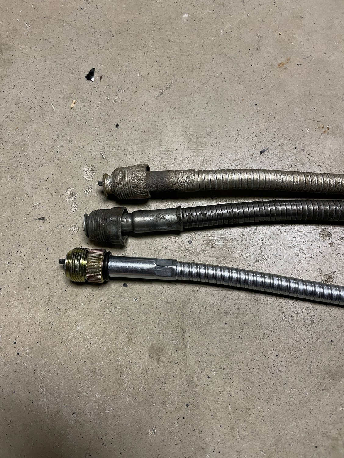

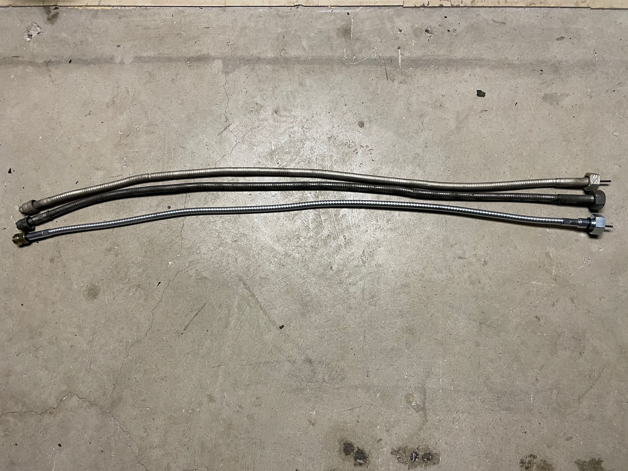

Speedo cable, I have two oem and picked up a repop. The repop isn't terrible, better than the skinny ones they offer. Im going to have the oem ones cad plated and see how they turn out. Ebay has junk ones for for $400???
The oem cables have two different styles of nut at the speedo. I'll look into that.

We cad the real ones and use the inside cable from the fake one and fill the thing with granite < nice move auto correct ba$tard

I'll hold off on the granite. The fake inner cable is captive in this one but I have a few original inners.

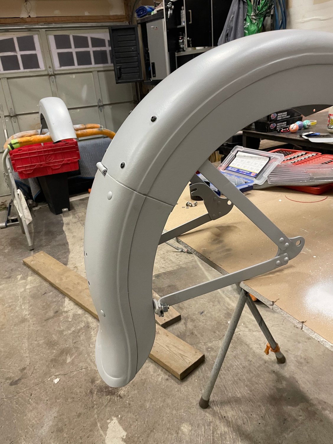

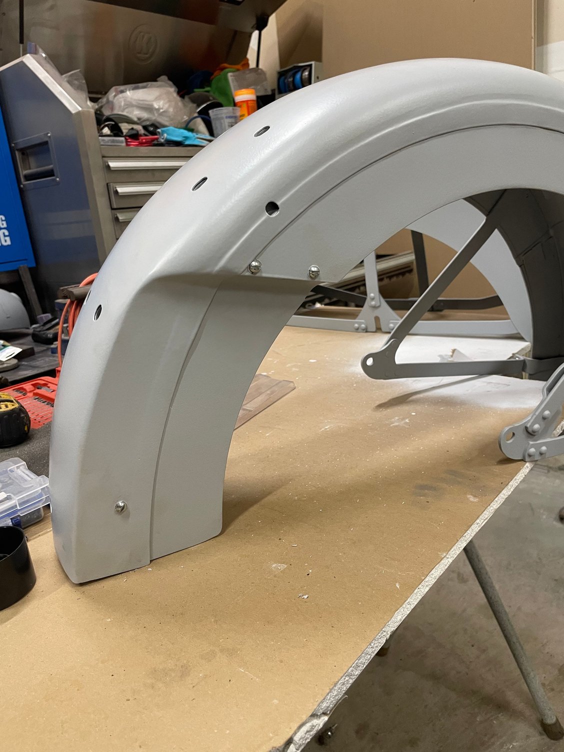

Fenders are ready for mockup this weekend. Need to rivet the brace and hinge on.

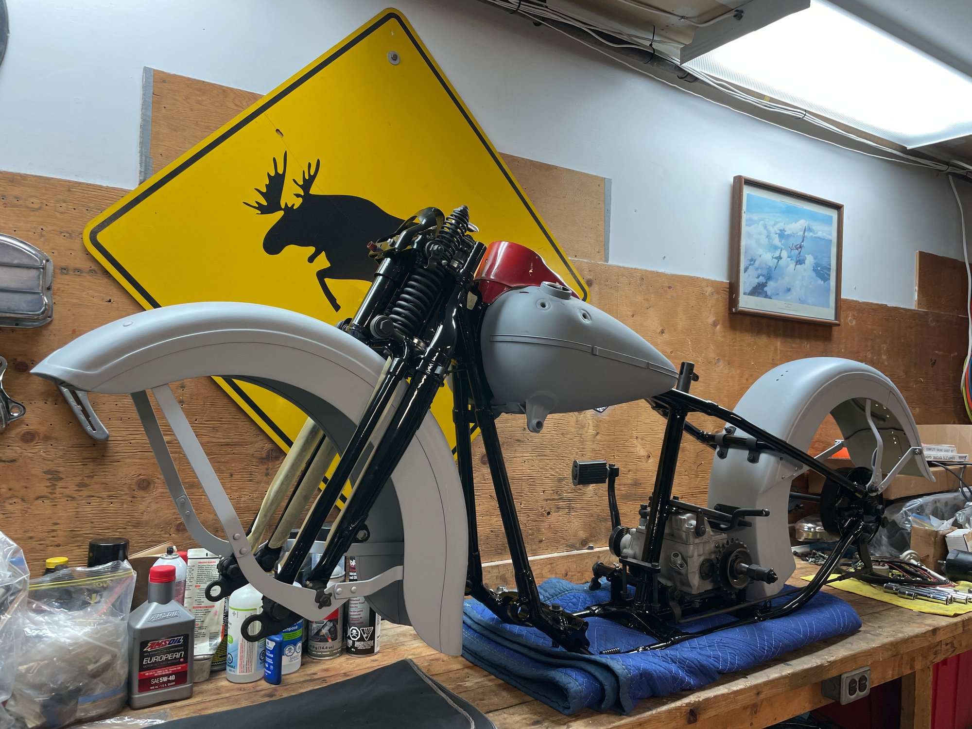

No drama fitting the fenders and tanks, no swearing or persuading much to my surprise.
I'll be swearing when I do the rivets on the rear fender Im sure.

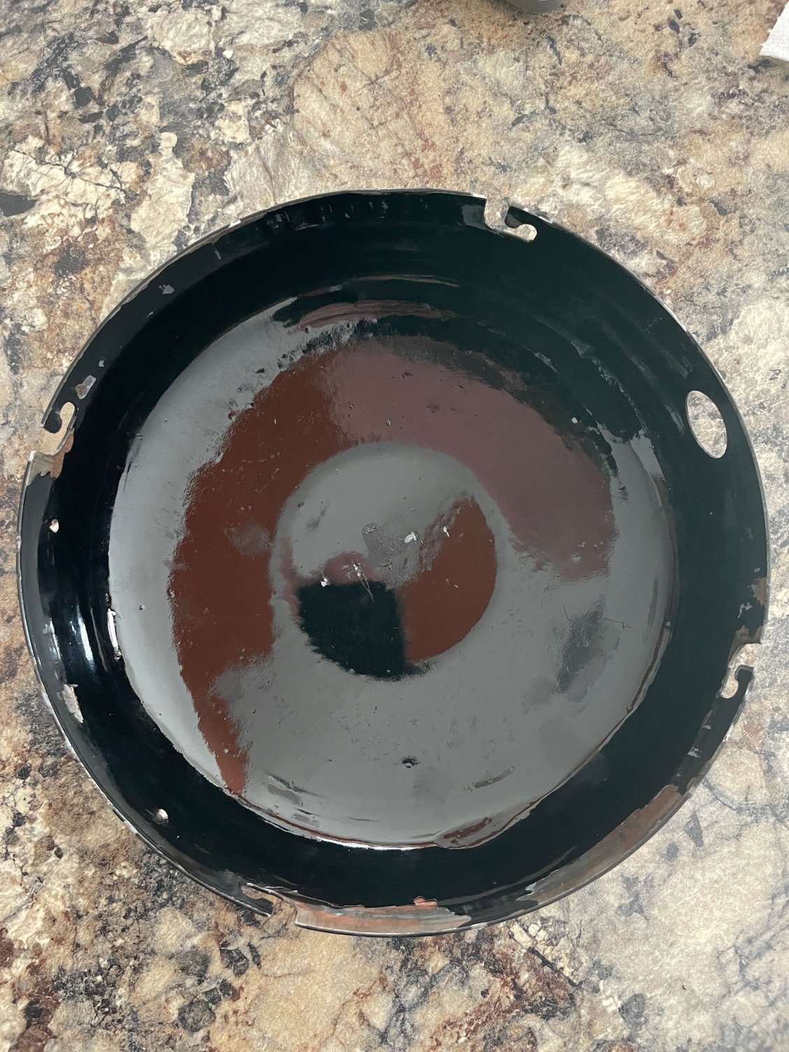

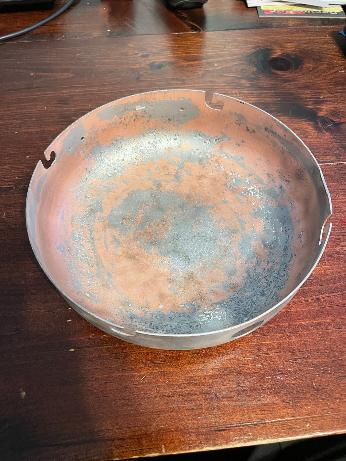

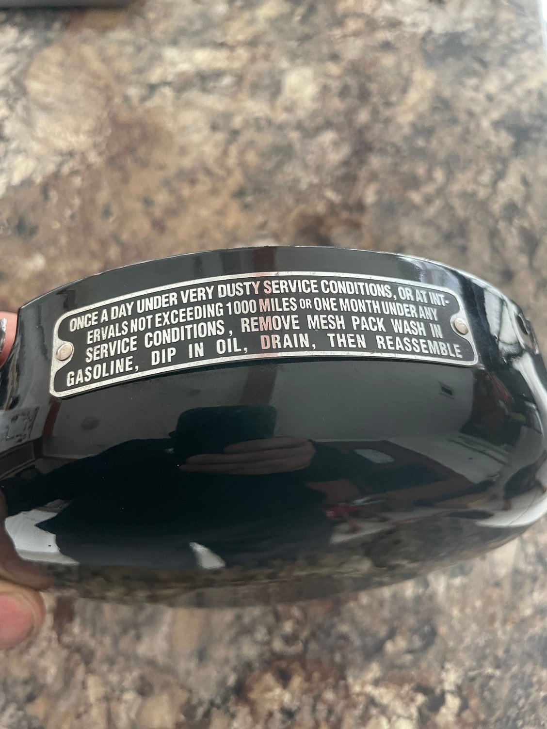

The cover looked really nice on the outside, it pained me to strip it and at the same time I was worried I would find dents or other damage that would complicate chroming it. It's pitted but Im sure the shop can make it look right.
