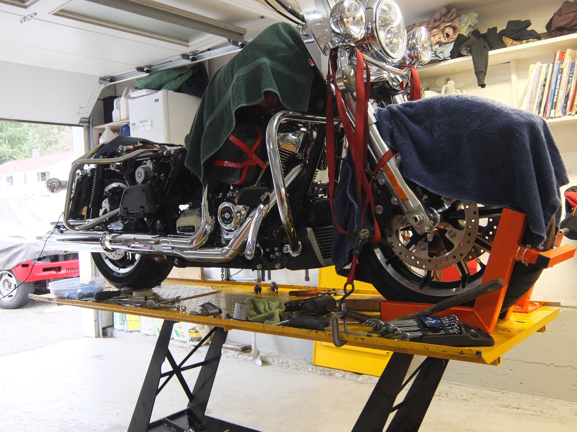

As you can see I opened the pipe and cleaned the catalist off the pipe and used fireplace gasket for sound aborsption cause I like quite.Then welded with 6010 Lincoln rod.I'm sure the Harley pipe is aluminized carbon steel.Stich weld 1 inch at a time to prevent shrinckage as much as possible.
The photos show what I did.If you guys could shown me a better method Then I will try it the next time.
