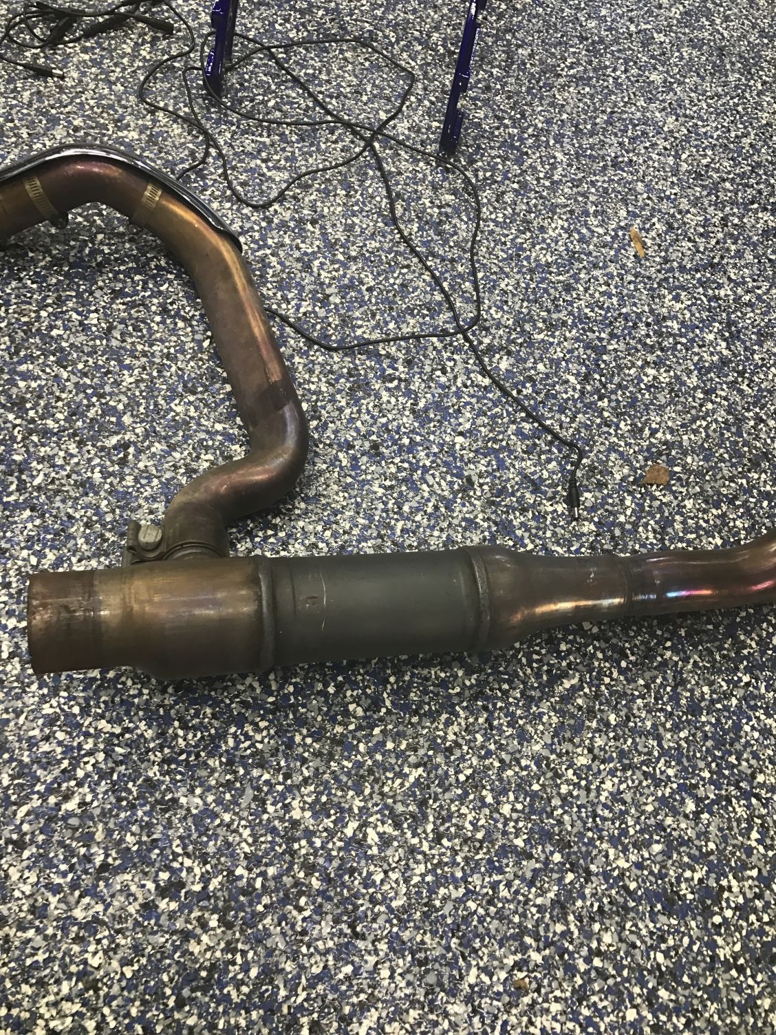

Originally Posted by cdestuck
Did you take your headpipe off to just remove the cat or did you have it off for another reason. Seems it might be done while on the bike with just taking off the right slip on
I didn't take mine off just the slip on and saddle bag hammer and long chisel bought at Lowe's and paddle bit about 16in long also at Lowe's.

Looks like blocking off the contorted pipe that leads to the left muffler would be a perfect low cost option for a 2 into 1 set up. Drill out the cat and you are good to go. You only need one can if you want it louder. I'd give it a try with the stock right muffler first as the sound deadening Cat would be removed.

I've done this on a Jap bike a while ago. No welding, use concrete drills bits long enough 5/16" drilled a round pattern and pulled out the loose piece with long needle nose. Then with long flat bladed screw driver peel off the cat that's stuck to the wall and use a shop vacuum to remove small particles before starting engine.

Hey Folks,
I decated my factory header yestasrday.
Did it with a 1.3/16(30mm) x 16in (400mm) paddle bit,and a home vacuum cleaner with a long hose to suck the debries from inside the pipes.
Took me about an hour to do it, piece of cake.
I'am still running the stock mufflers and in idle does not make much difference, but when you wrist the throttle the sound goes deeper.
For me it sounds good for now and way better than with the cat, I'm waiting for the VH OS450 to put in and let the apocalypse horns to scream loud
Regards!
