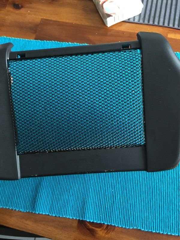

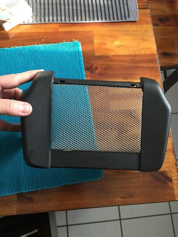

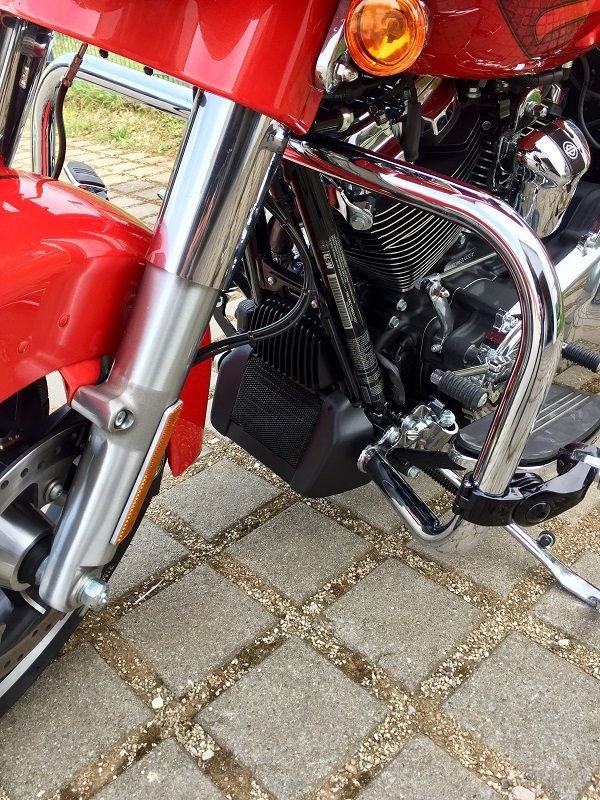

I know we ride expensive bikes and spend tons of money on mods and upgrades, but who doesn't want to save a little coin now and again? One thing I didn't like about my new SGS is the oil cooler not having much protection. I'm sure Harley would say "oh well we put it behind the fender". Clearly the agree a it could use more, and will gladly sell you a protection cover kit. So I decided to do my own.
Materials used - Metal mesh sheet (gutter guard), Gorilla Glue, Tin Snips, Whatever other tools you decide you need.
I took the metal mesh and cut it to size. Then bent it to the shape I wanted. Once it was in shape I glued it to the existing plastic piece on the cooler. I would suggest using a good 2-part epoxy over the gorilla glue. Painted the screen and black and good to go.
Certainly it's not perfect, but the few flaws are only noticeable up close and personal. Spent 5 euro on the metal, and had to buy the tin snips for 8 euro.

Did this awhile ago, found that small stones tend to get stuck in between the screen and cooling fins though.......
