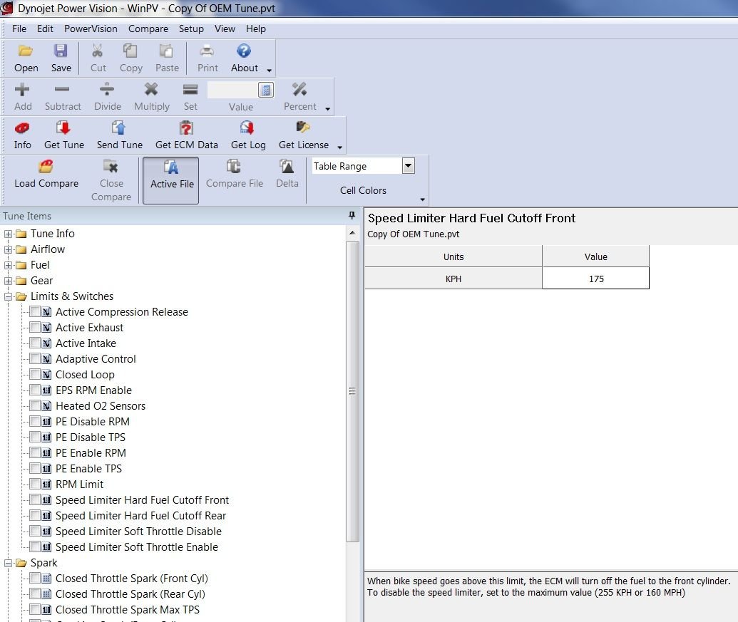

175KPH is 108.74 MPH.

If your willing to supply the VIN from your bike I can pull the OEM calibration for your bike and check it. Then place that very calibration into a test bike here on the dyno and run the test to see what happens. If your not willing to supply the VIN put your stock calibration back into the bike and just give me the calibration Part Number and I can do it from that. My guess would be your calibration P/N is 41000631. This would tell if your calibration is different or not. Your VIN can be found on the right side of the frame neck and will start with 5HD1.....
