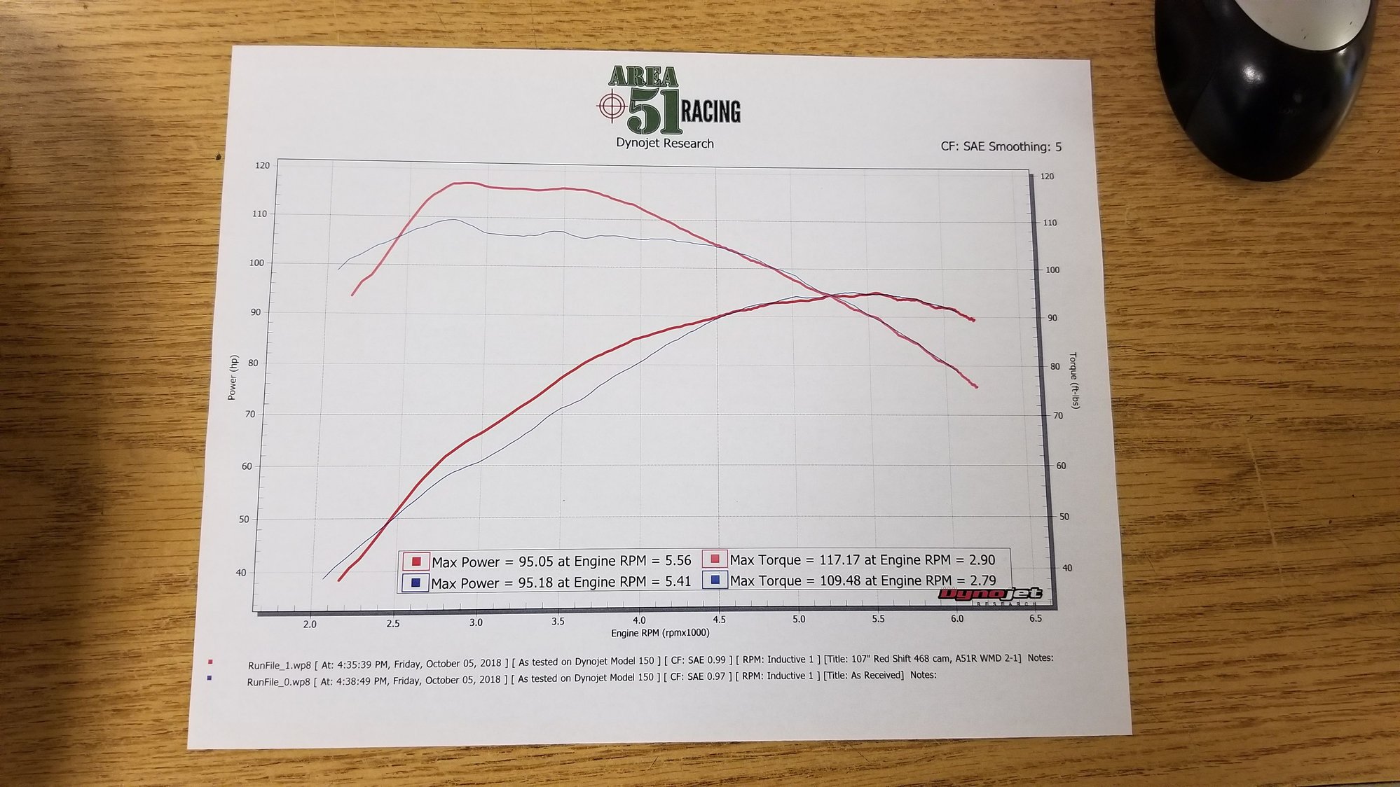

I had the jackpot headpipe and the mk45 slip ons. With rs468 cam. Good power an
d sound. But ended up with area51 2into1. Awesome sound and power from the get. Actyally have the headpipe and mk45s for sale

Originally Posted by ScooterFLSTFB
Here is a video on YouTube of a stage 3 build using the stock headpipe with the cat removed. The Dyno chart should tell you all you need to know about a de-catted headpipe.
https://www.youtube.com/watch?v=YEek-D2WhzM&t=402s
You're assuming too much. I would say the mufflers are causing the dip, not the head pipe.
Here is my bike with a decatted head pipe with the RS468. It has the stock muffler cans with Fullsac 2" cores. The mufflers do make a difference.
As you can see it made good torque and it made it early without a dip. I'm not saying the stock header decatted is the best pipe to use on a stage III, but from the torque and hp they made with is it doesn't look bad. Some mufflers with a little more back pressure would move the torque curve to the left and should get rid of the dip.
