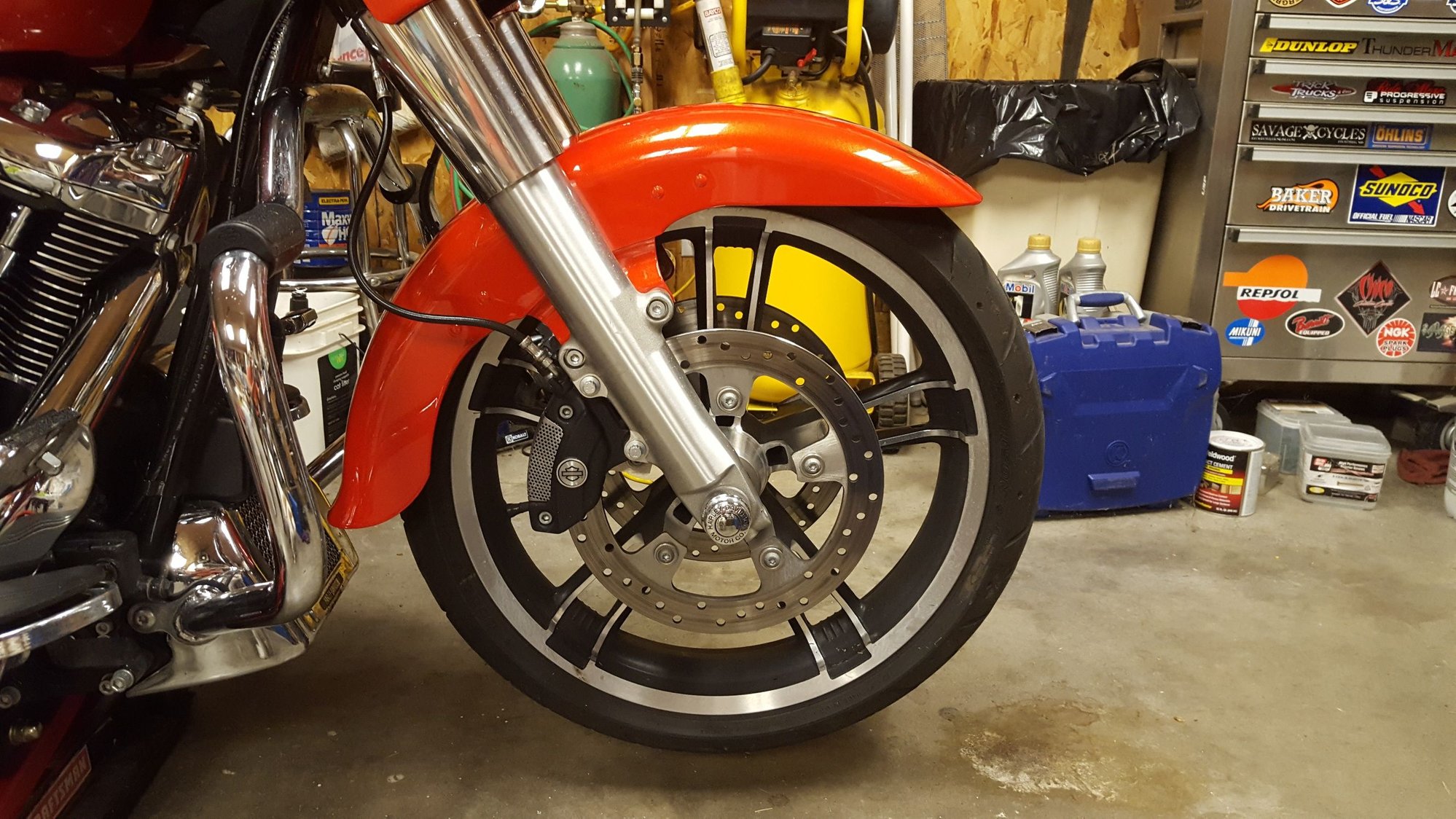

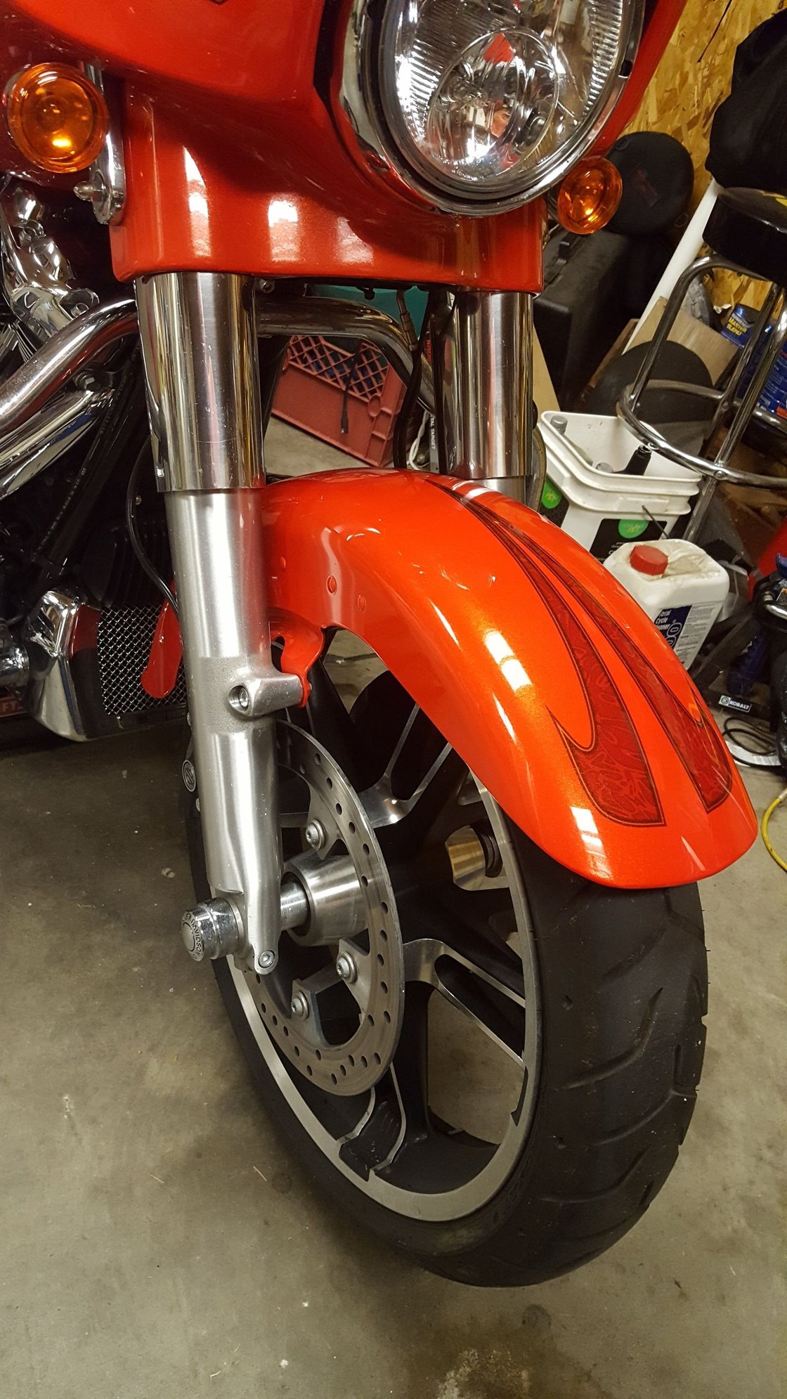

Go for it. Harley said a Freewheeler front fender would not fit a Street Glide.
It was a perfect bolt up match.
What what a beautiful color and front fender, you took a chance and won! I'm going to look at the parts book tonight I think the ultra and the road king fenders are identical.
Fender looks badass!! Do they come in primer only, or can you order them in paint? Have the Freewheeler fenders remained unchanged across all four years of production? Finally, is the clearance at the trailing edge of the fender tight to the oil cooler, or is it an optical illusion in the pic? Thanks!
