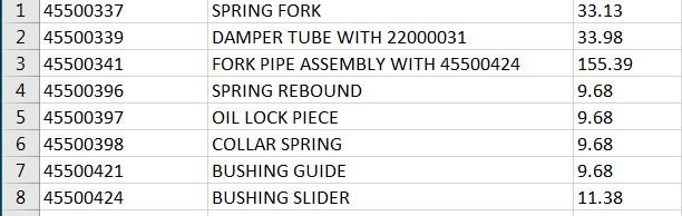

Probably not a complete list, but here are the parts unique to the 2017/1018 forks. All other parts are the same.
The real difference is probably in the damper tube.
