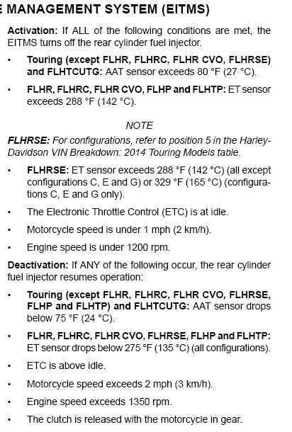

Originally Posted by GTK
Your right ! 80 degrees is the outside ambient temp that it kicks in for the M8. Does not work from engine temp. anymore.
The ambient air temp sensor on fairing models is located on the left side of the steering head inside the fairing & EITMS uses this sensor for actuation at 80 degrees F.
AFAIK non-faired bikes still use engine temp sensor, as described by BigT.

H-D set the kick in temp lower with the M-8s for EITMS and the wet head fan also.
