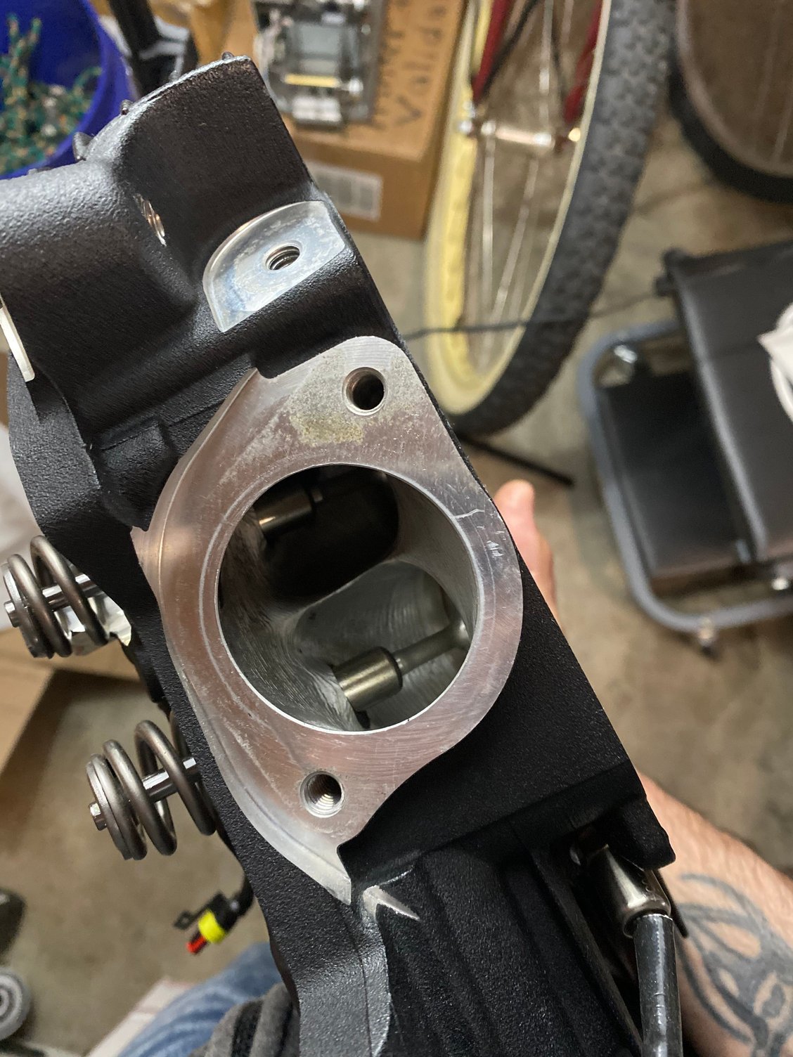

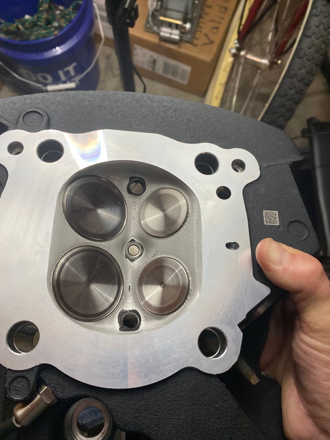

I have a 2019 FXLR, which has a 4.375” stroke. I did a custom build, with 124” Daytonas, KB +4mm pistons, 12:1CR, Don Dorfman ported my heads and did O.S. valves and H.L. springs, S&S rocker shafts/studs, HPi 62mm TB/Tunnel ram, Don port-matched intake manifold to ports, CR540 cam, factory CSP/OP(2020), 7.1gps Daytona injectors Bandit clutch, BDL comp. sprocket, Evolution 49T clutch basket(+3T over stock), Bassani 2-1, and stock Primary tensioner(Hayden had issues, as did the Feuling CSP/OP).
This was my first Harley. I did all the research myself, and built it all myself. I originally did a stage 2, then started over with all of this. Don guided my hand, here and there. I had it dynoed by Chris Waddell at CSR, at Laconia, NH Bike Week ‘22. Here’s my chart. Here’s my question(after peeping the chart);
why are some getting close, even, and maybe slightly better numbers with stage 3s and bolt-on stage 4s? Or is this just dyno magic dust?
In case it’s fuzzy; 139hp/143tq

What does Don say?
So someone built this same build and made more HP/TQ?

He just asked if it felt like it ran well. It runs Perfectly in every way. No, I’m pretty sure I’m the only one to do this build, certainly the first. My thing is, there are tons of people claiming they got 130hp/150tq from a stage 3, which is nonsense I know, but for the amount of extra labor and parts I put into this build myself, I expected at least 150 square, or in that ballpark.

Well I think you are learning that it's a little bit more than selecting a bunch of unmatched / tested parts, tossing them together and expecting certain amount of output. First place I'd look is the exhaust pipe because it's easy to change. Get yourself a nice Burn's pipe.. I could not find cam specs and you didn't state compression ratio.. If Don, port matched the heads, did he flow the whole intake track?
It's totally possible that the Dyno is stingy, The operator should know..

Found the CR-530. Cr should be close to or better than 11.5 to 1.
It has a 12:1 compression ratio. I’m running an UltraCool oil cooler, and FLO filter, to keep it cool. Yes, Don tested them throughout. Hand-blended the intake manifold to the intake ports, and used a set of valve springs he liked. It’s got +1mm valves, I believe, and he filed my rings to 3.5. He was explaining the whole formula for ring-bind, and he taught me how to properly measure for zero-deck, with domed pistons. He taught me a lot, actually. Great guy! I really hated moving back East, I liked hanging out with him on the weekends.
As far as matching parts, I did a ton of research, over the last few years, and he made sure the combination I used was synchronous/harmonious. Don did say the exhaust might hold me back, because it’s a short, megaphone. I’m checking out that exhaust you mentioned. I originally bought the Bassani RR2, when the bike was new, from the dealership. I spent so much money, to build the engine, I figured if the exhaust needed to be replaced, I could let my wife cool-off a little, and pick a different one on credit…
