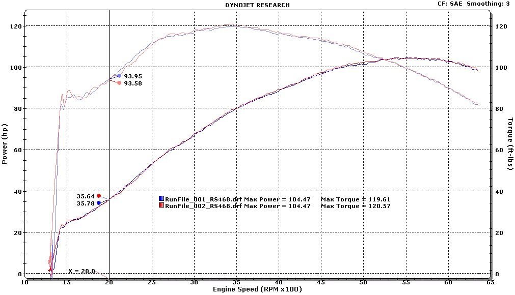

Do you have a dyno run you can post now? You say the results were not what you hoped for, how so? The mufflers and Jackpot 2-1-2 will make a difference, but I would have just decatted the stock head pipe first. It might have got you where you were looking to go. Here's mine with the stock head pipe decatted and the RS468. I was running the stock muffler cans with Fullsac 2" cores and an Arlen Ness Big Sucker.

I had 104.6 max torque and 93.6 max power with stock head pipe and street cannons with rs468 cam
