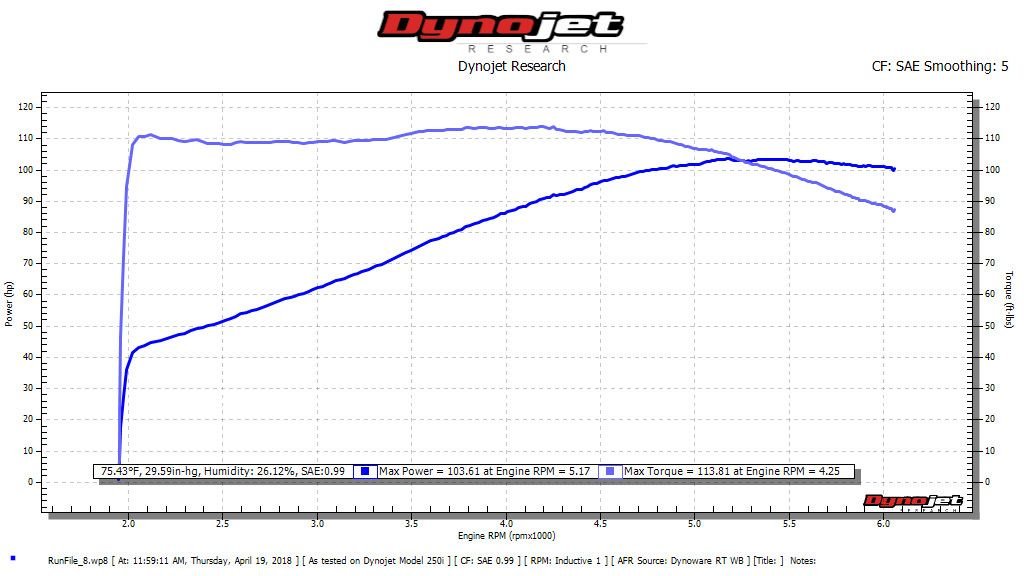

Default CMP Short Dump
I can't help you with the exhaust you asked about, but here is a dyno sheet for a 107 that is running a CMP Short Dump. How it will work on the 117/124" motors, I have no info for that.
This is a 107, M462 Andrews cam, CMP Short Dump exhaust. The torque and power are about average for a 107 with a torque cam.
