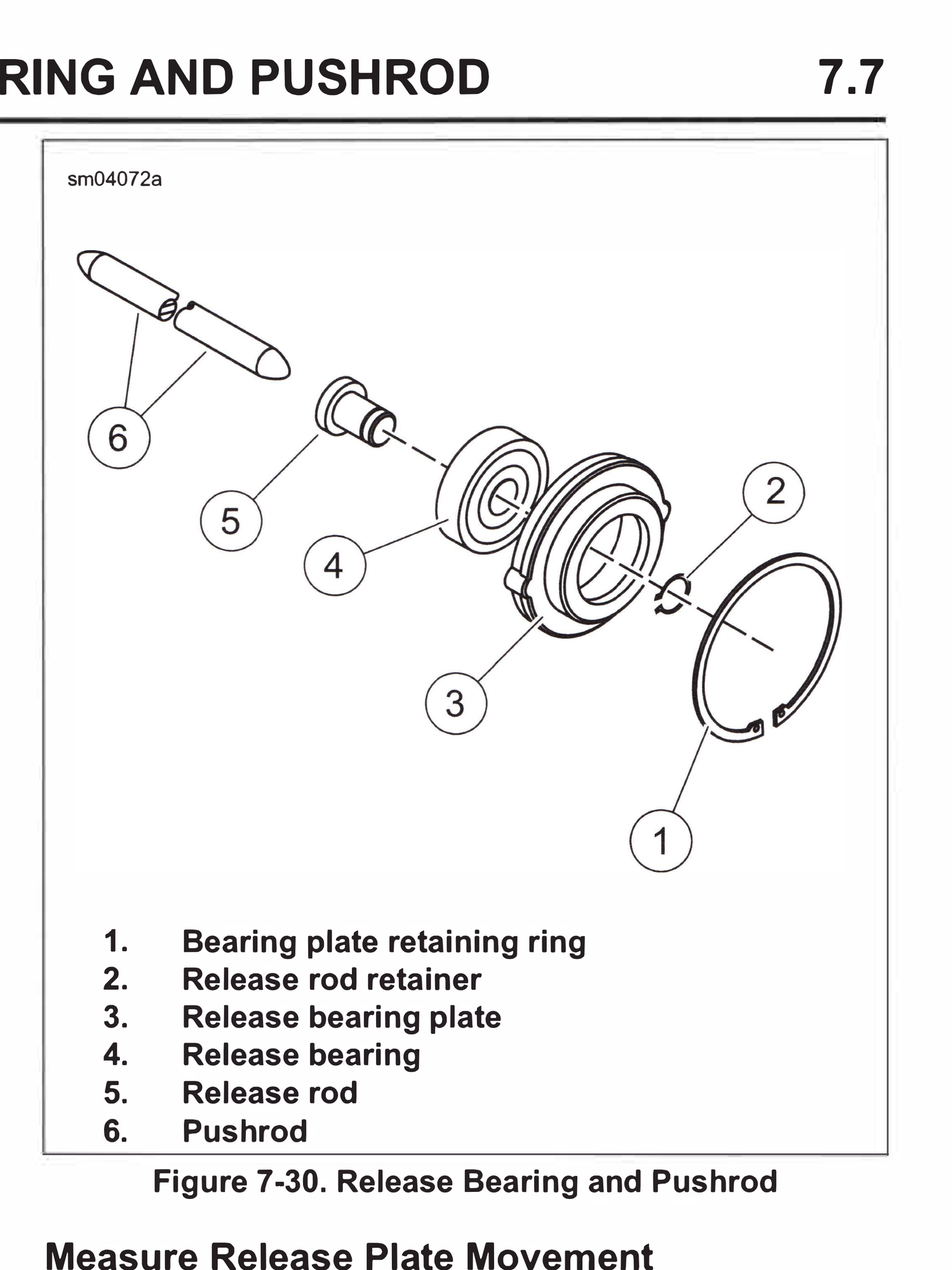

I purchased a replacement clutch push rod in hipes that it will help with the fluid transfer issues my road king is experiencing. I can't find a diagram in the service manual, or any vidoes regarding swapping it out. I understand how to do it on previous years but the nut isn't there now. Does anyone have a link or pictures that could help?

Pull the retaining ring and everything just pulls out. Pretty easy.

Thank you very much, just what i was looking for
