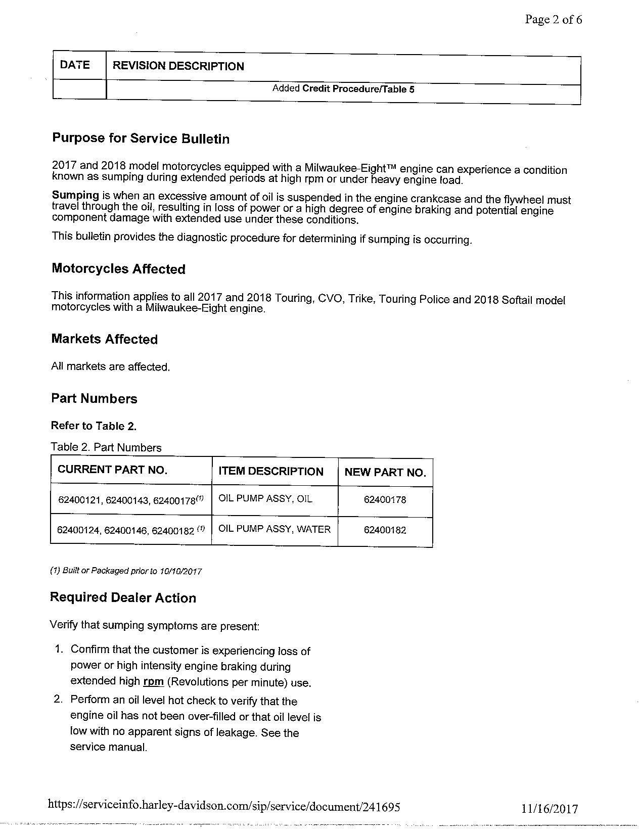

Here's pages 1-3 of a later version of SB1450 if you're interested. Perhaps it'll provide some insight even if it doesn't provide an exact diagnosis for your issue.
Old Feb 2, 2019 | 08:26 PM
  #35
Heatwave's Avatar
Heatwave
Member
Joined: Jul 2009
Posts: 4,310
Likes: 1,079
And pages 4-6 of SB1450​​​​​​​

Originally Posted by Heatwave
Here's pages 1-3 of latest version of SB1450 if you're interested. Perhaps it'll provide some insight even if it doesn't provide an exact diagnosis for your issue.
FYI, thats not the latest
