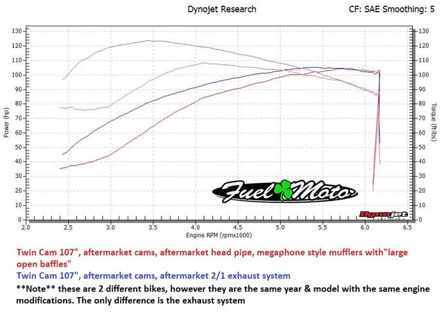

As several here noted it's not the size of the muffler body, it's the size of the baffle. Baffle size & design greatly influence & affect the overall power curve, baffles that are excessively large affect low RPM performance, response, and tunability. The M8 engine is also more picky on what it wants compared to Twin Cam. The standard 2.25" louvered baffles in the Rinehart mufflers work well in most applications, the mufflers that typically cause issues are the larger 2.5" cores, tapered, or stepped baffles that are in some of the louder mufflers being marketed.
Below is an extreme example of a Twin Cam chart showing the effects the exhaust can make on a 100Hp 107" motor.
