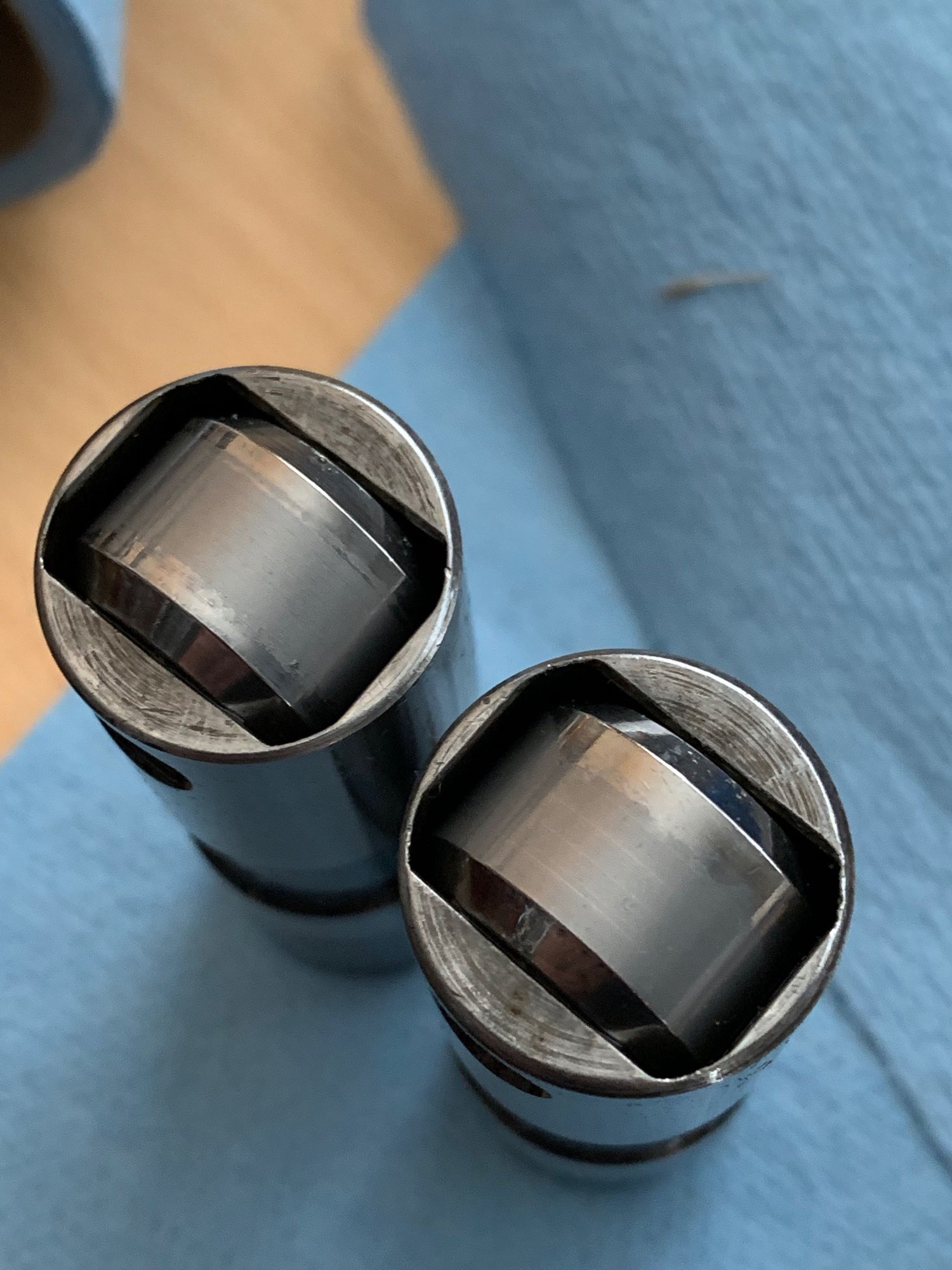

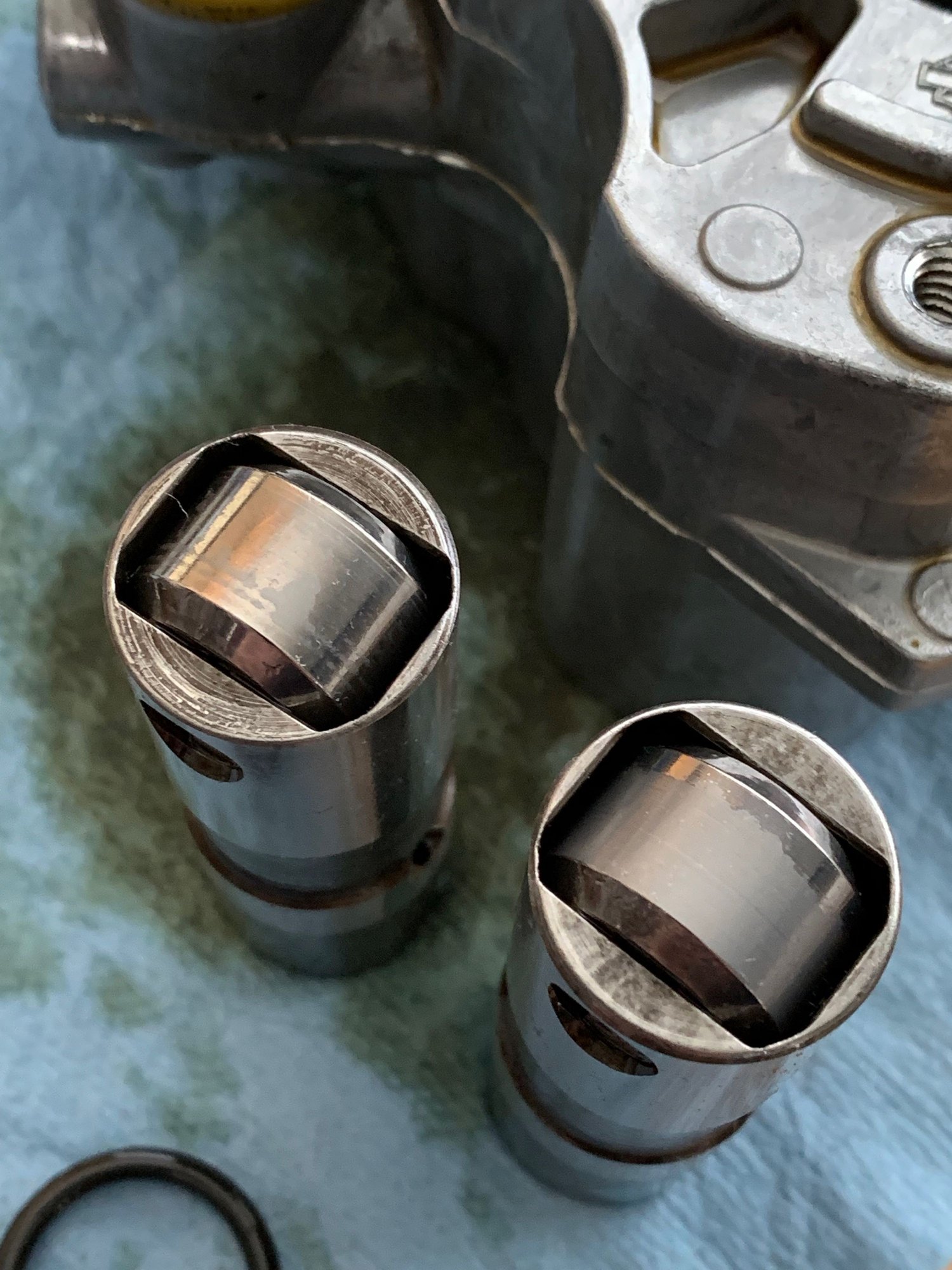

Originally Posted by beasleyiv
Thanks. I always ran my TC PRs a bit deeper just to try and keep the valve train a little quieter. I know it can be a religious war.
I suppose one of the lifters could be bad, not sure how I'd test that. The stock lifters were trash at 16K miles so can't put those back in.
I have a set of Gaterman TC lifters from an old project, suppose I could throw those in if it's still noisy after assembly.
My lifters looked just like that with 15K. Cam lobes showed wear too.
Did not inject the lifters, figured why wait even longer for them to bleed down during PR adjustment. Just worked assembly lube into the rollers, put a bit on the outside and installed them. The clattering wasn't like "oh **** turn it off" levels, but it wasn't quieting down as fast as I would expect and didn't want to do damage. I'll go 3 turns next time around and see what happens.
I used to just soak new lifters in oil for 12-24 hours before installing them. When I built my 117" TC for the '15 I did it that way. When I was adjusting the pushrods I noticed the front exhaust felt a little different. When I started the motor it was noisy. I tried re-adjusting it, but it was noisy. I called Fueling and the first thing I was asked by the tech is whether I injected the lifters with oil. He said that even soaking them they could be dry internally and cause damage to the lifter. In that case I don't believe it, I think it was just a bad lifter. They did replace it and problem solved. Since then I have injected new lifters. If nothing else it makes it easier to tell when the pushrod has made contact so you can start counting flats to do your adjustment. Do I really think that soaking them didn't get enough oil in them to lube them? No, but injecting them is faster and like I said, there is at least one benefit. Also, if you get a bad one there is no doubt that it was internally lubed. The little extra time you would have spent waiting for them to bleed down would have been a lot less than what you have spent tearing back down and chasing what might just turn out to be a ghost.

I hear ya. I took a shortcut and this is where it got me. I'll inject these and put it back together to see what happens. Thank you.
