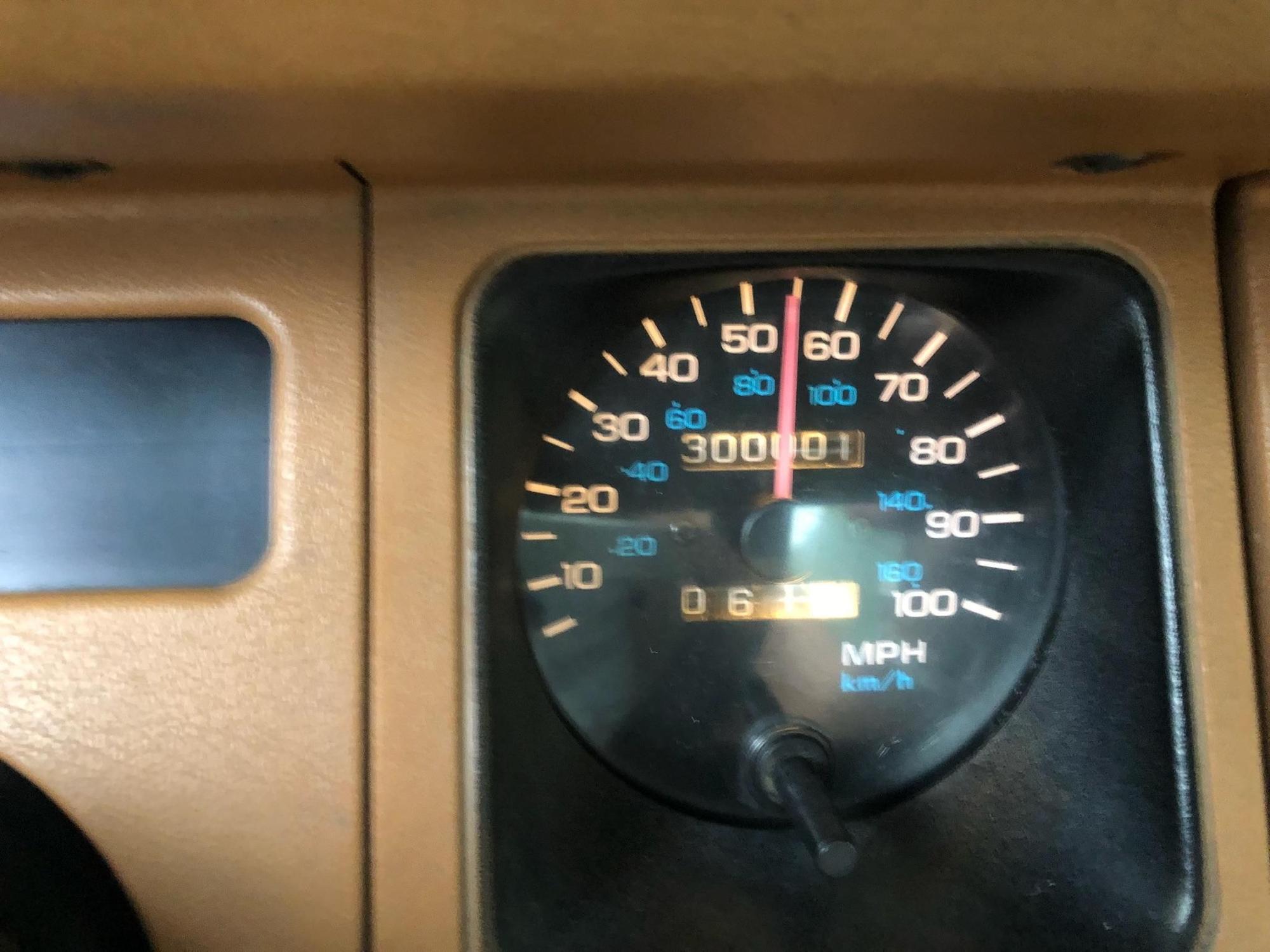

Too cool..First time I heard it, I thought it was going to blow up. Most of the time when people moan about lifter, I think is really just how sounds come from these bike . If it really was a lifter like you were hearing not pumped up, they would have a heart attack.
On my Jeep I rebuilt, I have a couple tapping from not pumping up. I put new valves in it but the head seats were too hard to touch up. Farmed it out. Told them I would put it back together but they did it anyway. Either the rocker or pushrod is worn. I had cleaned lifters and the bleed wave washer was worn , so I errored on cheap. I pulled lifters out and replaced them. Going back down with rocker bolt, two only have one turn on 5/16-18 bolt before it torques. With new lifters, it starts tapping like about a solid lifter with .015 clearance.. As usually, when you go cheap, it takes 3 tries to get it right. Going to take about .040 off bottom of two of the rocker fulcrums. Or new rocker and pushrod second choice...(they
only have 300,000 on them)
