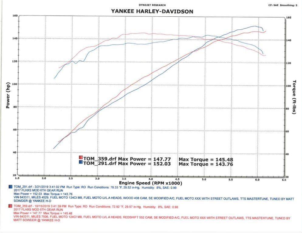

Originally Posted by Bigt001
Based on the above dyno chart it looks like the Redshift 552 cam was a huge improvement (shape of the torque curve) versus the Woods 408, but I must admit that all the other dyno charts I've seen with the Woods 408 had a lot better/smoother shape than the one shown. Perhaps the Redshift was an easier cam to tune for your tuner and he had difficulties getting the Woods tuned right.
Anyway, congrats on getting it sorted out.
Old Nov 21, 2019 | 10:22 PM
  #292
Agoober's Avatar
Agoober
Joined: Jan 2019
Posts: 3,036
Likes: 1,013
From: Nunya.
The Woods cams need the right exhaust combo, it's been shown time and again. The other cams not so much.

Originally Posted by Beartooth Rider
I would really appreciate that since I have the same basic build that you were running with the 408 cam and I have been curious about the RS 552.
I have no plans on paying for another dyno session for a 6th gear comparison if that’s what your hoping for.
Peace.
I am running one of the exhaust systems Fuel Moto sells with this kit. The torque would most like like come on a little sooner with a 2:1 exhaust. The fuel Moto xxx exhaust has a larger stepped primary pipe than most systems out there to help with the top end hp.
Fuel Moto know what pipes work with a Woods cam, they'll sell you one.
