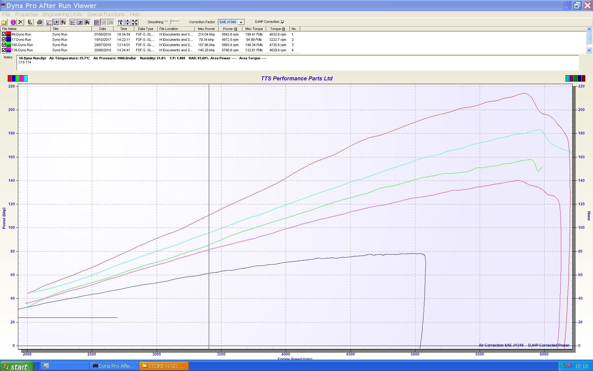

Default Inferno supercharger
Inferno supercharger with RS468, D&D 2/1 114 SE pistons, welded crank more to come.
Old Mar 10, 2019 | 05:17 AM
  #35
TTS Performance's Avatar
TTS Performance
Former Sponsor
Joined: Nov 2013
Posts: 193
Likes: 114
From: UK
Inferno supercharger with different stages of tune and boost.
Torque increase with each change. lowest to highest.
std 107.
107 with Rotrex C15-60 supercharger and 2/1 exhaust
107 with C 15, 2/1 and rs468 cam
114 with C15, 2/1, rs468 cam
114 with Rotrex C30-74, 2/1, rs468 cam
