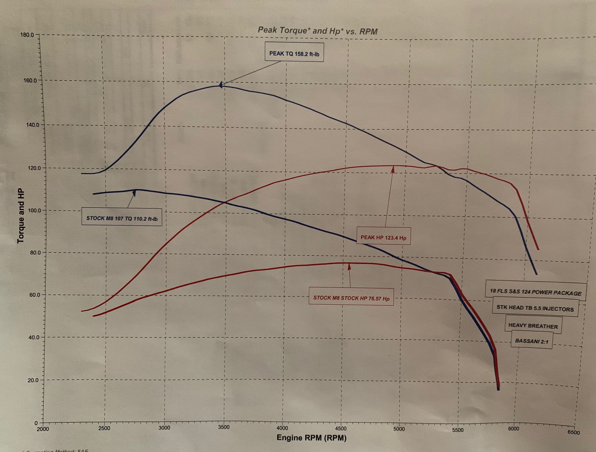

S&S 124 kit
stock heads
stock TB
bigger injectors
Bassani Road Rage
heavy breather
