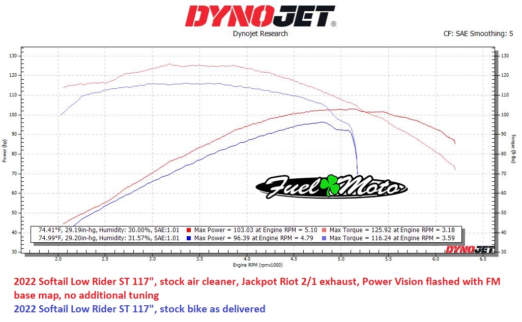

2022 Softail Low Rider ST; stock bike vs Jackpot Riot 2/1 & Power Vision flash with FM base tune

Dang! Thanks Jamie. Those 117s are healthy!

Very nice gains for exhaust and Tune

so they must have put a fairly aggressive cam in these new Softail 117s right?

Results are very similar to what I got on my 2018 CVO road glide, with a Fullsac head pipe and 2.25 baffles and a dyno tune. Cam in the 117 is similar to the HD torque cam.

thanks..found it interesting since hearing all this time the general consensus appears to have been the 3 extra cubes of the 117 isn't much of a performance upgrade over the 114..but 15 hp increase and almost 10 torque is more generous than that perception bears out

FWIW, my stock 2019 117 put out 91hp and 111tq so I was a little less than the above chart.

Was that tuned with aftermarket head pipe?
