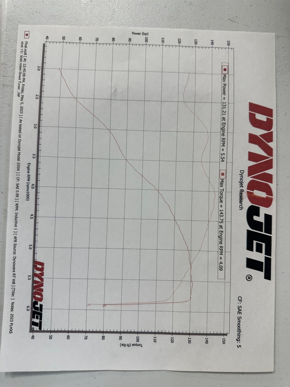

I bought a 23 street glide special and had the 131 stage 4 kit installed…here’s the numbers from the dyno…131.21 power 143.75 torque….I’m hoping this is good?!? I of course did all SE products. Let me know how I can move some of that HOT air away from my legs it’s burning the hell out of my right leg!
wtf is that torque curve? The money people spend on SE is better spent elsewhere….I would 100% trade that peak torque for a flatter curve with 10 less lb/ft. Maybe bad exhaust choice, bad tuner, poor camshaft profile, or all of the above. No offense.

[QUOTE=BajaBabe2023;21208466]I bought a 23 street glide special and had the 131 stage 4 kit installed…here’s the numbers from the dyno…131.21 power 143.75 torque….I’m hoping this is good?!? I of course did all SE products. Let me know how I can move some of that HOT air away from my legs it’s burning the hell out of my right leg!
I have the complete SE Stage 4 128" kit and have never felt any heat but even before cat was removed and now running the V&H Propipe 2&1. That is here in the Louisiana weather where she runs on 1 cylinder every time I stop at 90deg and above.
Your numbers are extremely high for a SE 131" so I would be worried about your tune with that kind of heat. A tune should not be all about squeezing the highest torque and hp as normal running readings are much more important, especially with reliability.
Tune may be fine or even perfect but I personally never had any heat issues for me or my wife. I ride with a couple more with the Stage 4 as well and no heat issues.🤷‍♂️
