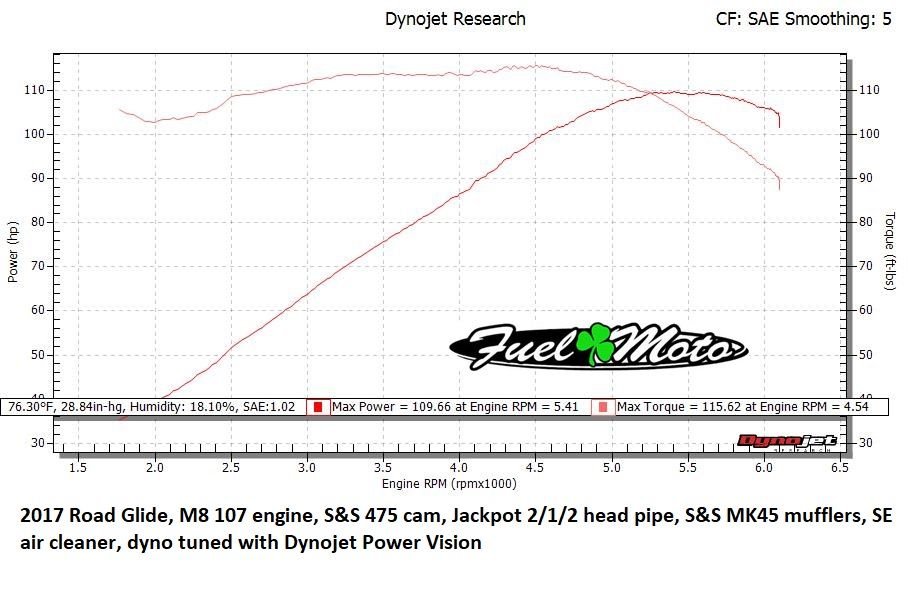

Originally Posted by Andrew Anderson
Hay guys. I like to see a m8 107 with Rinehart header, 4" mufflers rhinehart/ Arlene Ness c/I fp3 autotuned. With s&S 475 cam on a ultra limited. Real numbers. I'm getting ready to install the 475 gear drive cam this weekend and well there is not one dune tuner less then a 5 hour ride from me.
Not your exact setup but this should give you some "ballpark" numbers.
