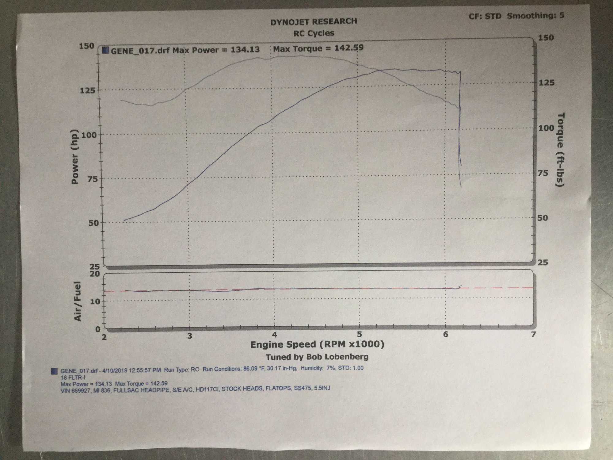

Default ‘18 Roadglide FM 117” BB
SE 5.5 injectors
SE high flow ac
SE intake manifold
FM 117” BB
S&S 475 cam w/premium lifters
FM adj pushrods
S&S cuffs
Fullsac MX HEADPIPE
D&D slipons
AIM SDR with heavy duty springs & Lightforce slave cylinder
Stock heads and throttle body
TTS mastertune
