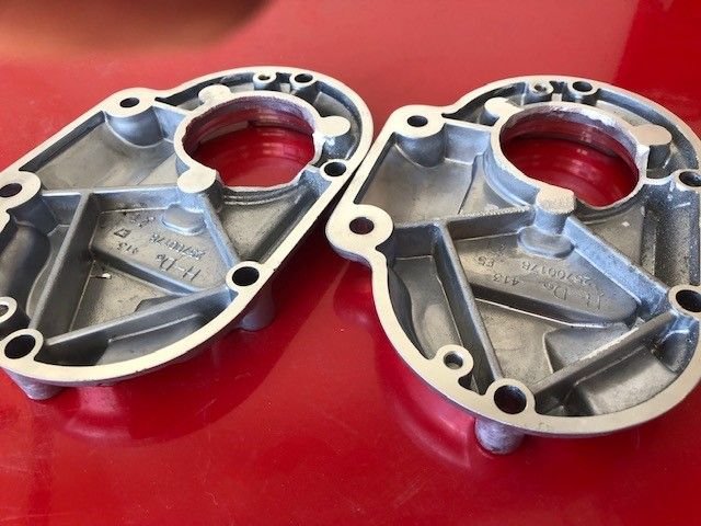

Try the relieved inner cover. You can do this with a coping saw (it was the best tool I found for removing the barrier wall) and a drimel or a burr bit. I have a one in use that so far has stopped transfer. He is getting ready to take a longer trip and will report back soon. He was transferring 6-8 oz. every 1000 mi. He's gone 650 mi. with no transfer.
This won't cost you anything but time if you already have the tools.

do you any before and after pics? and exactly where is this cover?

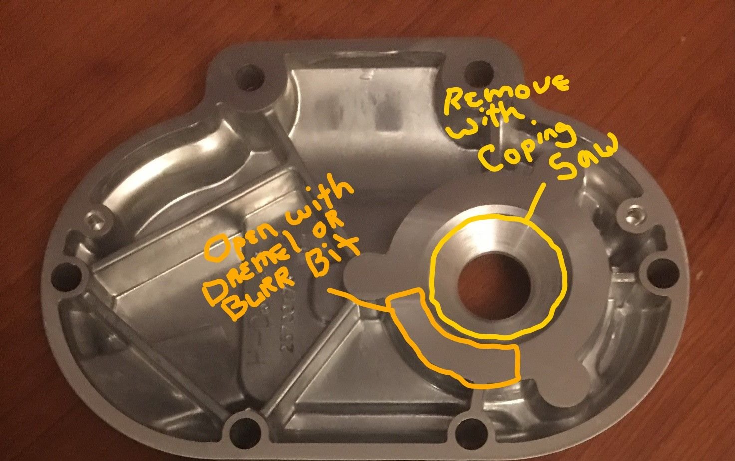

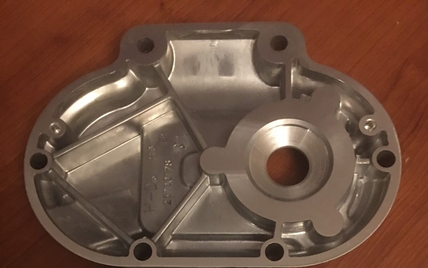

It is on the right side of the transmission. There is a faux cover there that is chrome or black and this is the actual cover under it that attaches to the transmission and holds the clutch actuator. You have to loosen, not remove, the exhaust to access it. Below is the stock cover.
This is what they should look like when finished.
This is where you remove metal.

OK thanks.
